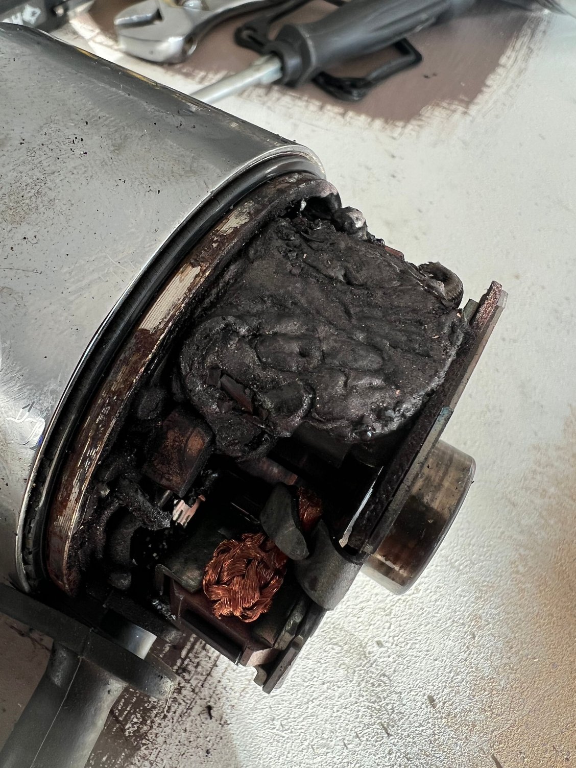

The starter does not run thru the breaker. The breaker is on the control side of your wiring. The starter goes directly to a high amp solenoid then to the battery. Need to start checking your wiring for any damage.

Describe what you mean by misfire. What is the ignition controller you refer to?
what amp is the circuit breaker you installed?
describe the noise the starter made before tripping the breaker.
did the breaker reset?

Starter was cooked… one of the brushes was completely melted with the housing and spring… probably the starter driving wheel got stuck with the engine running… that’s where the white smoke came from, and that’s what caused the shortage.

Good job finding the problem.
