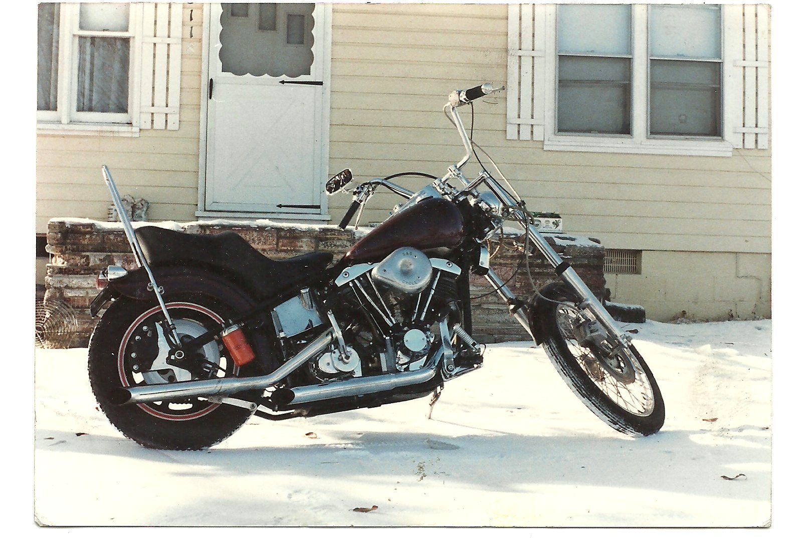

Have you ridden a rigid for any period of time? My brother had a 48U. You'll need springs on the seat. Why not build a softail? They can be made to look like an old style rigid.
LOL !!!! Ain't that the truth, my ex threatened me with divorce over a 3000 mile Sturgis trip on this one.
