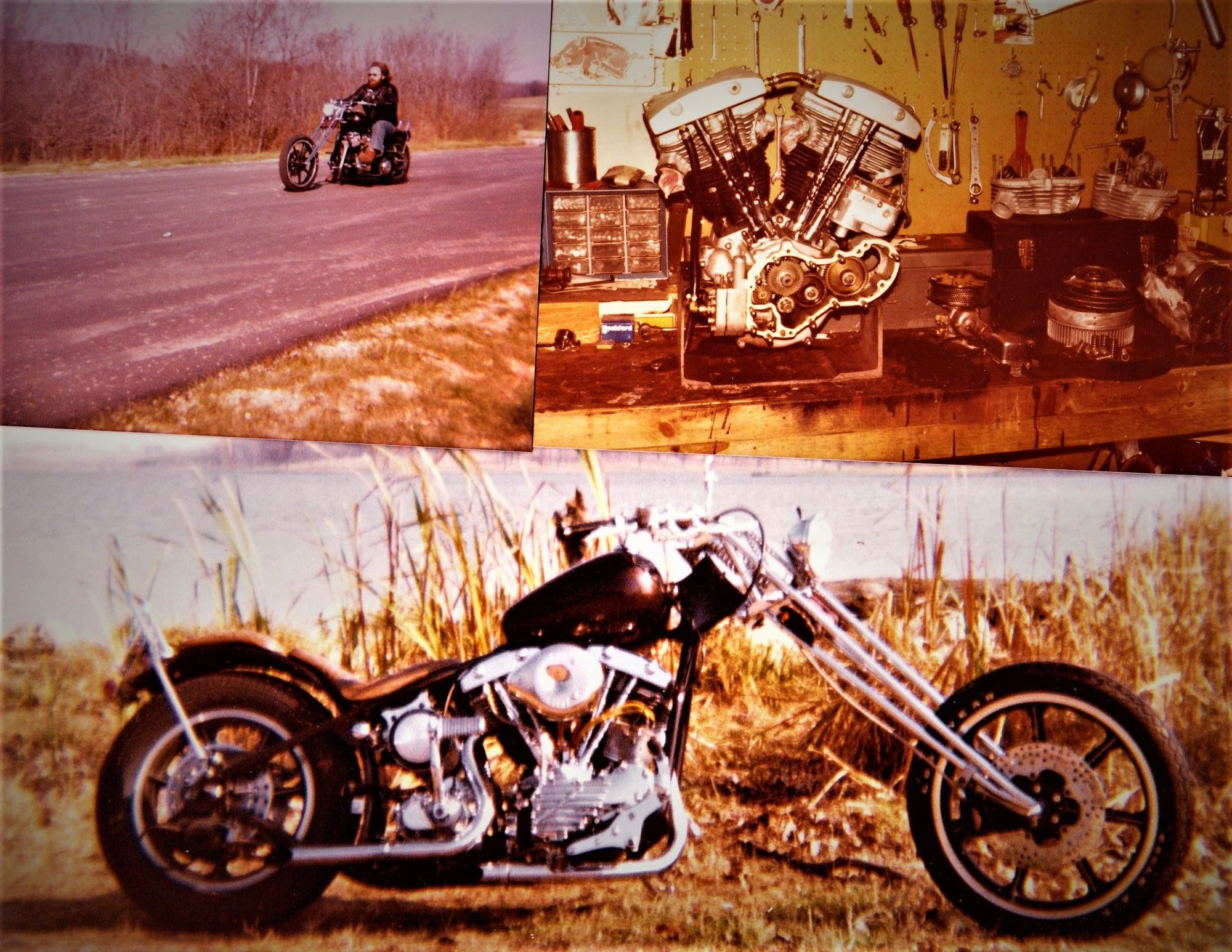

PanShovel brings back memories ! Road the bike below late 60's until mid 80's. 1949 Panhead evolved over the years to bike below. "49" pan motor OEM left case/ right side replaced with STD right case around late 70's (don't ask) with Shovel Heads added around that time.

If it had spoked wheels it would be perfect, I am not a customer for the Invader type mags.
But, very nice build mister, congratulations. I admire that rake and extended girder front end.
