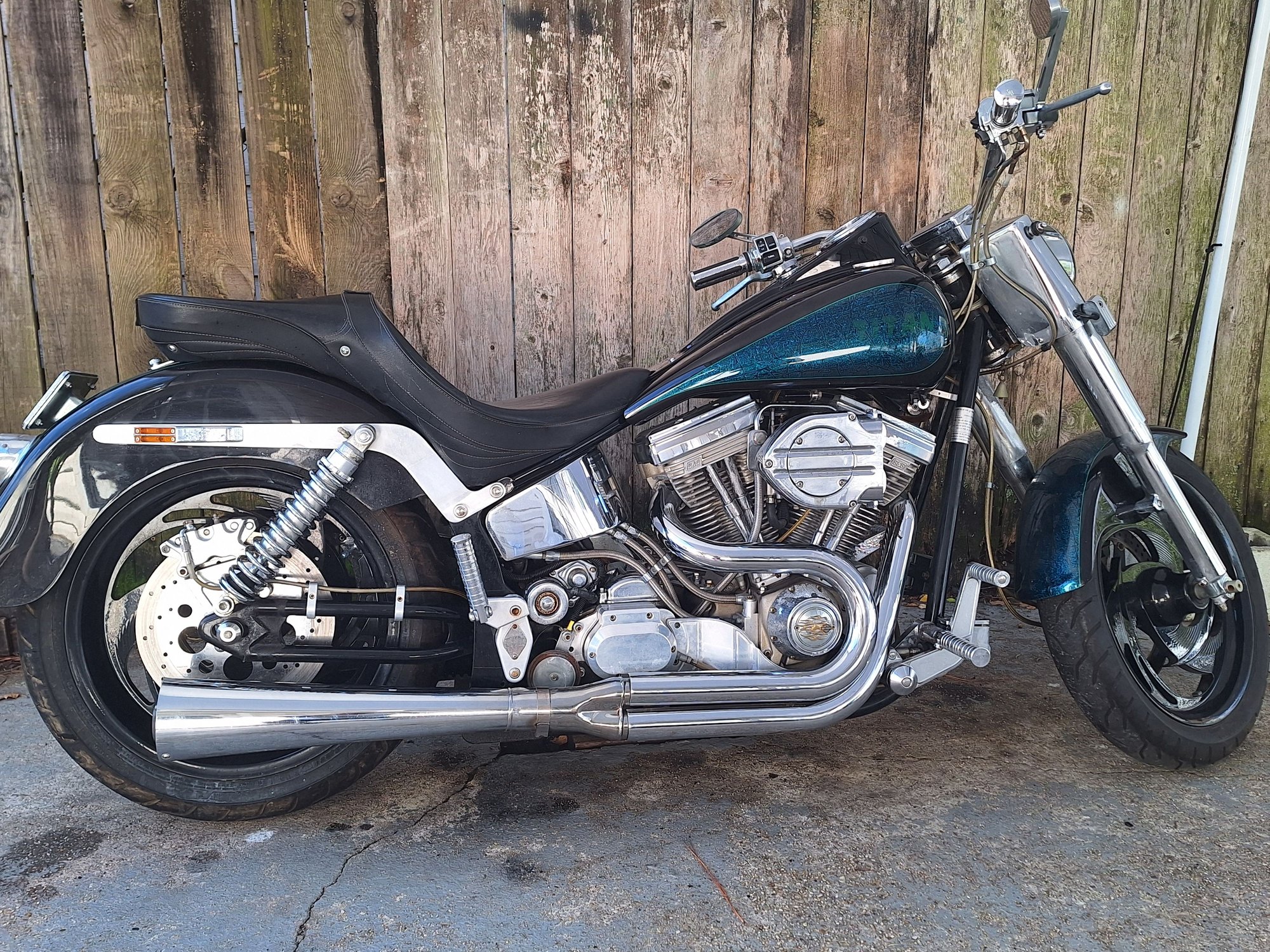

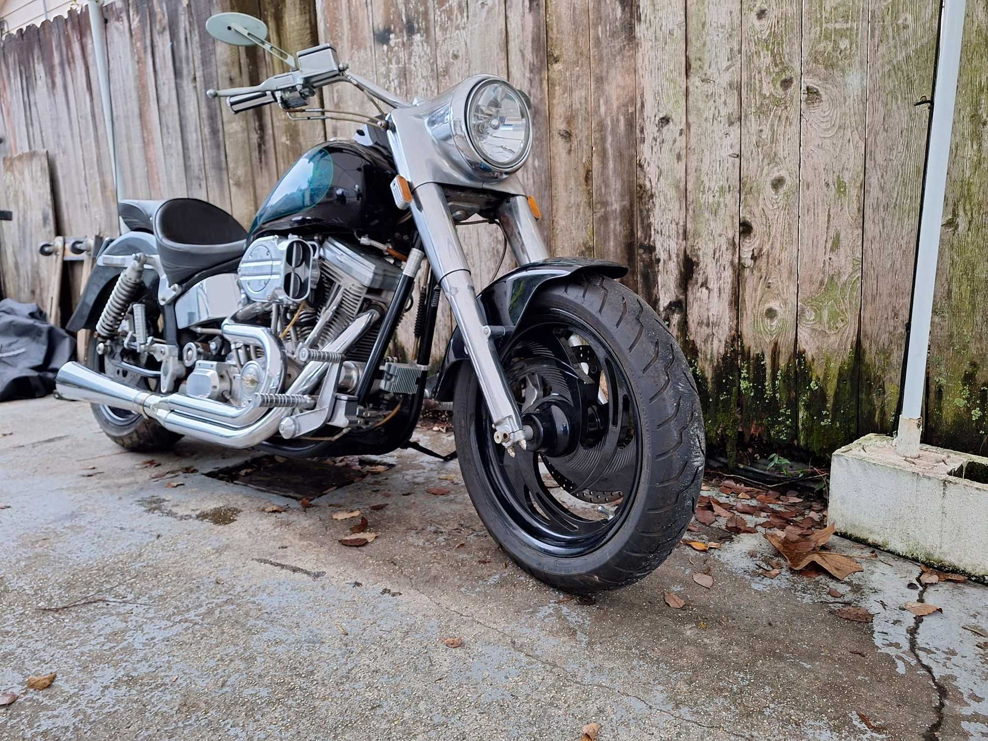

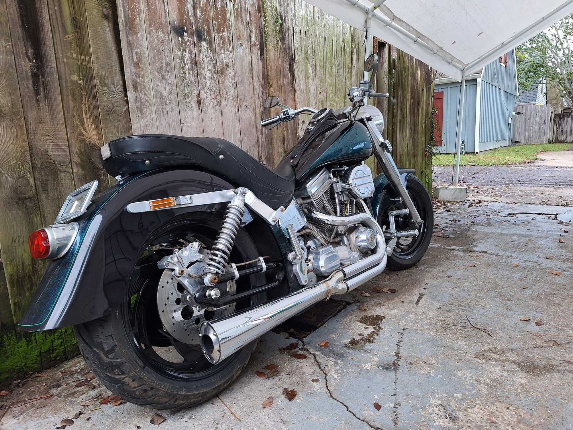

Hello. Not sure if this is the correct section but a Titan is basically a FatBoy custom/clone so I figured this is as good a place as any.
What exact drive belt to I need to replace mine since its missing more teeth than a retired NHL veteran?

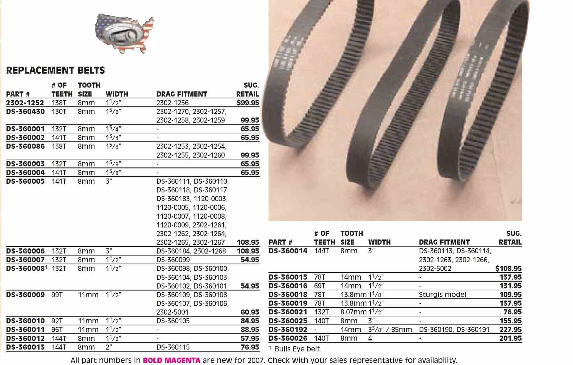

Measure the number of teeth on the belt and width, Go to a Drag or biker choice catalog and pick out a belt that's same size.. Best to stay with Gates brand belts if possible. The pulleys off a later EVO HD should fit if you need to replace them.. You may want to check belt alignment to make sure it's correct. I'd also use the same tooth count pulley just so you don't have to change belt length / gearing.
My bad. I only saw the 3 pics, On the primary belt, it's BDL pulleys and clutch.. You can get the parts from a distributor that sells BDL components.

I believe it's one of these.. The part numbers are from Drag specialties.
