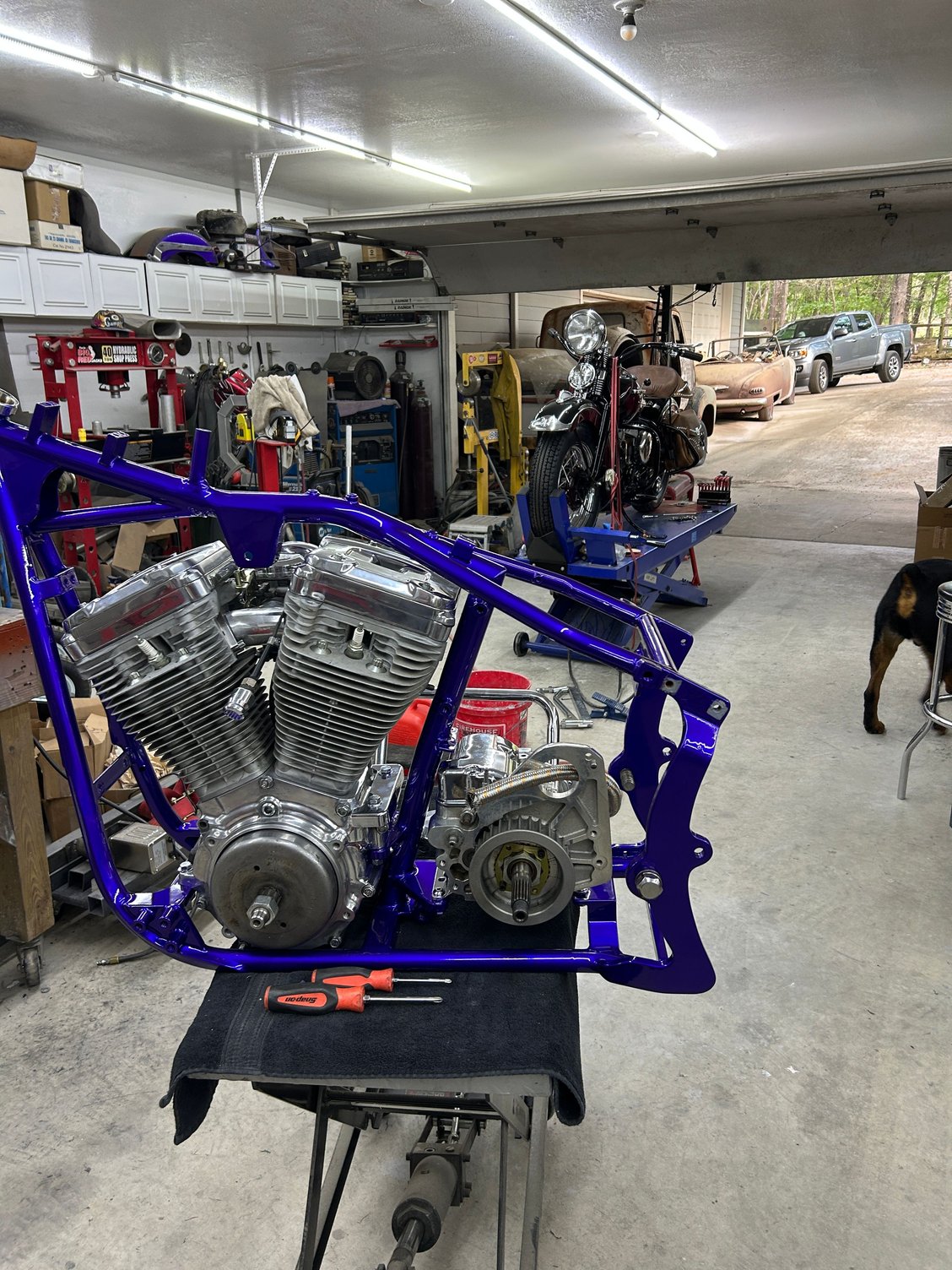

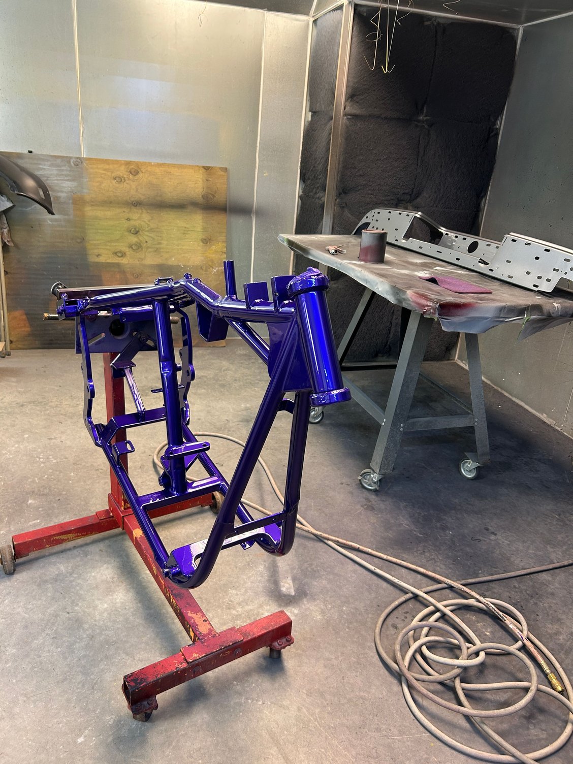

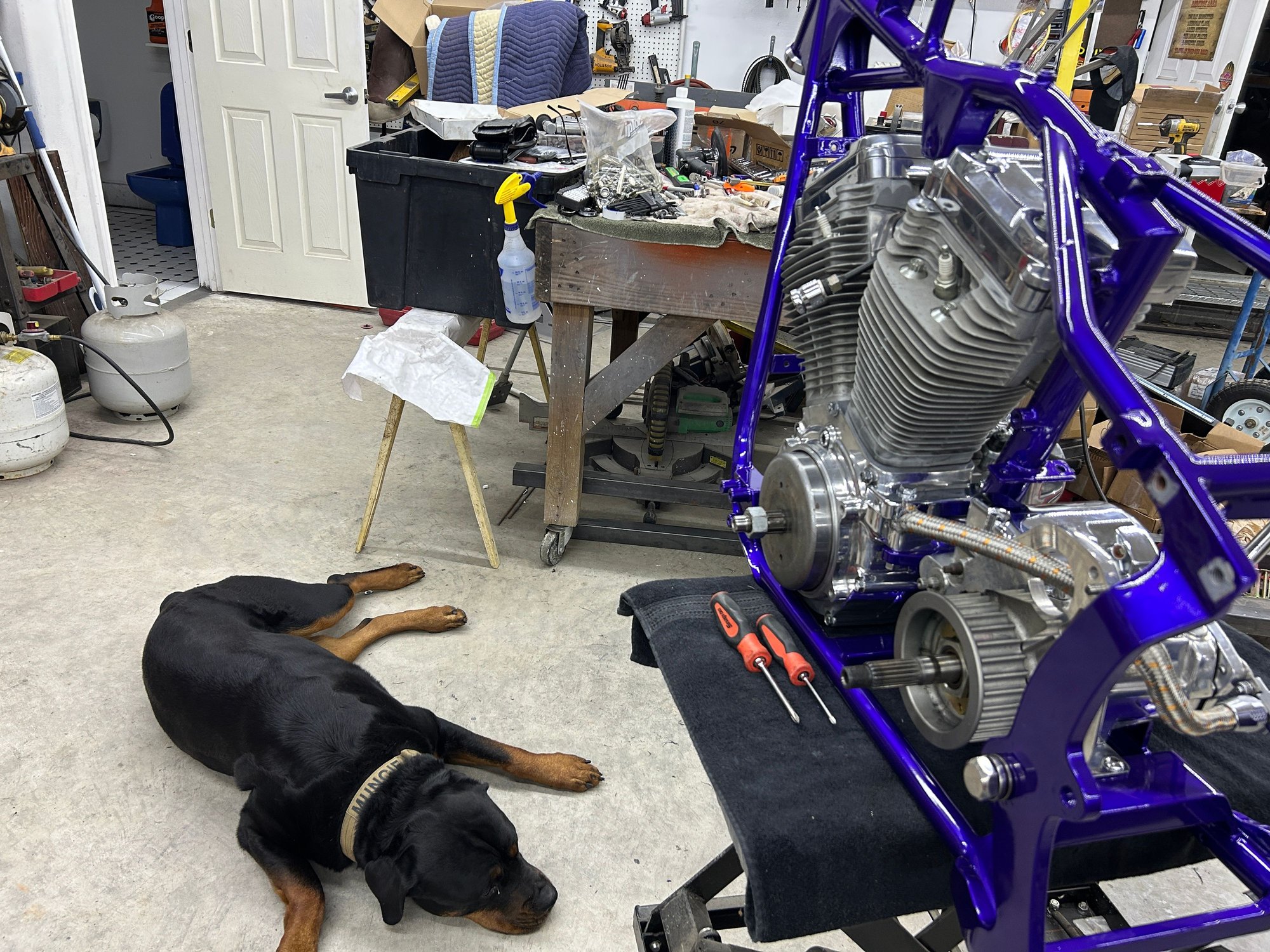

Yes there was insurance on the bike which is another story as they wouldn't pay cause I did not have security of the bike as it was not in my hands .
Repainted the frame  fixed all the scratches and nicks and pry marks !
Getting it cleaned up removing the fingerprint dusting and crud .

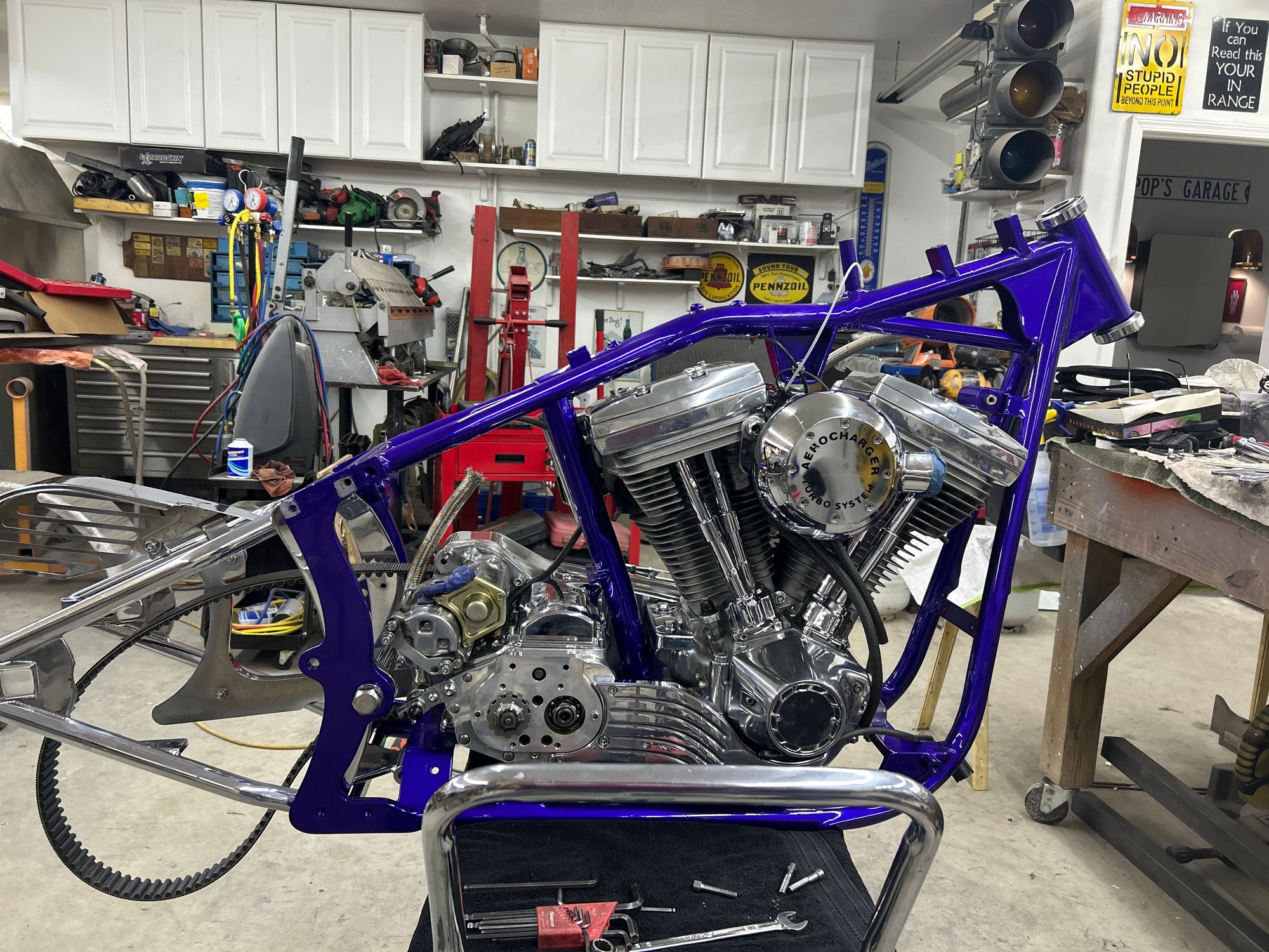

Got hte trans in and put back together as they took it apart

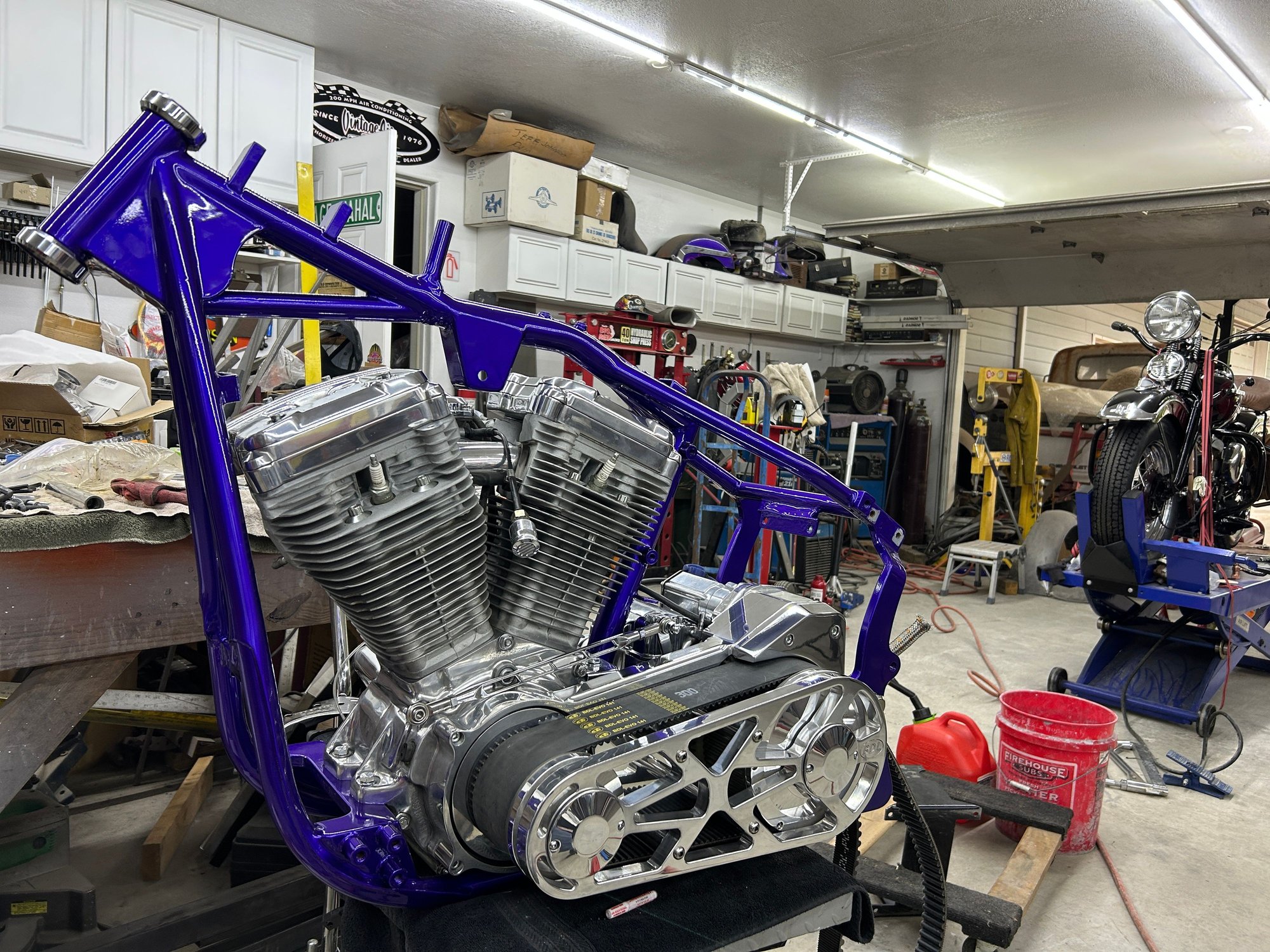

Security cruising the area  !  Engine back in , must be getting old didn't seem that heavy to put in before !
Trying to dig back in the memory banks of what went where
Been a tough dsy on my security guy !

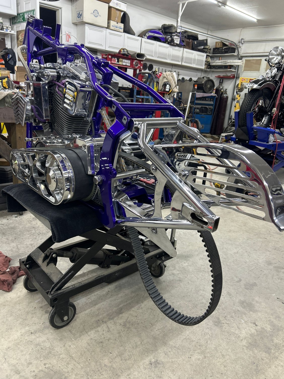

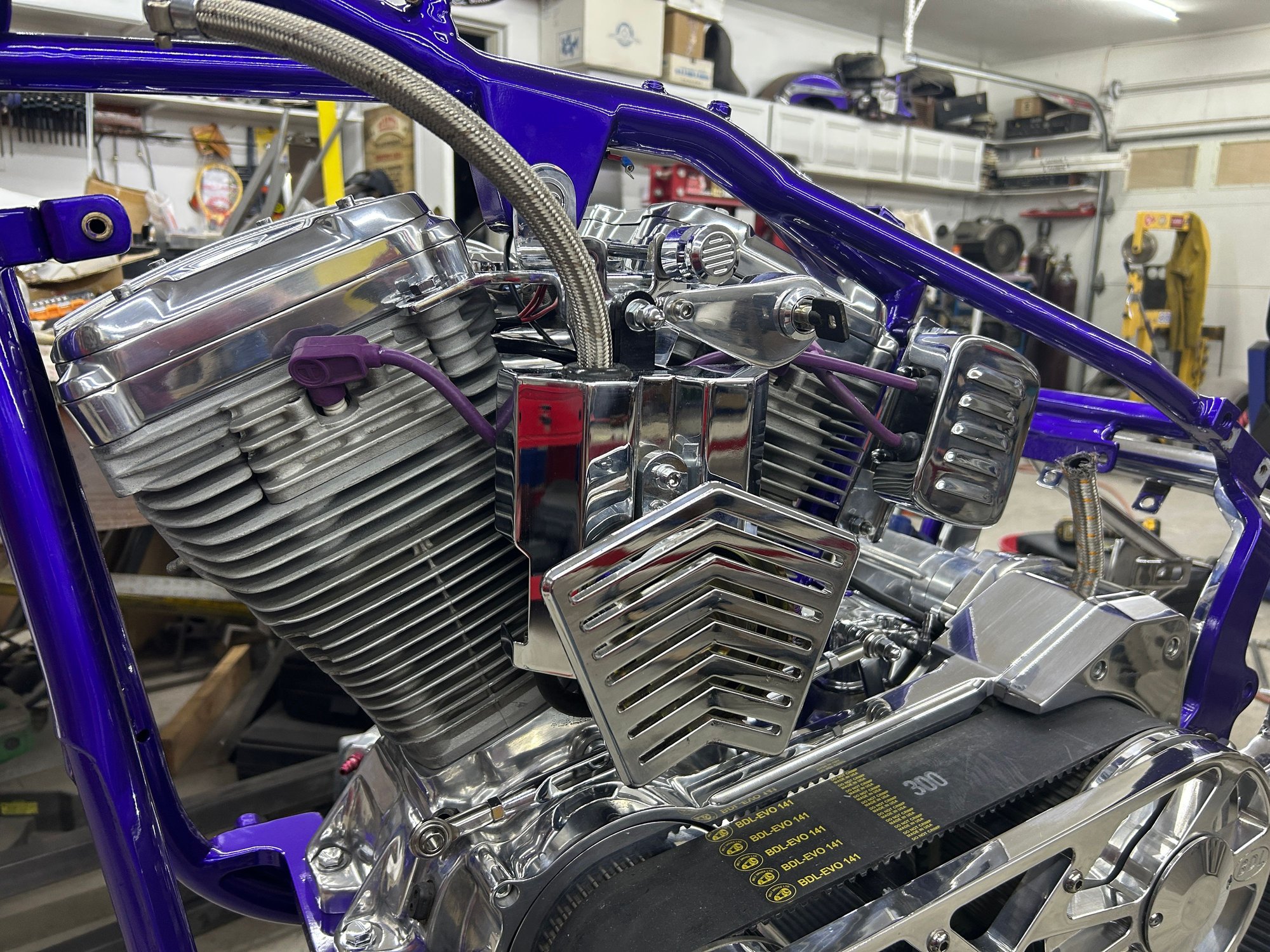

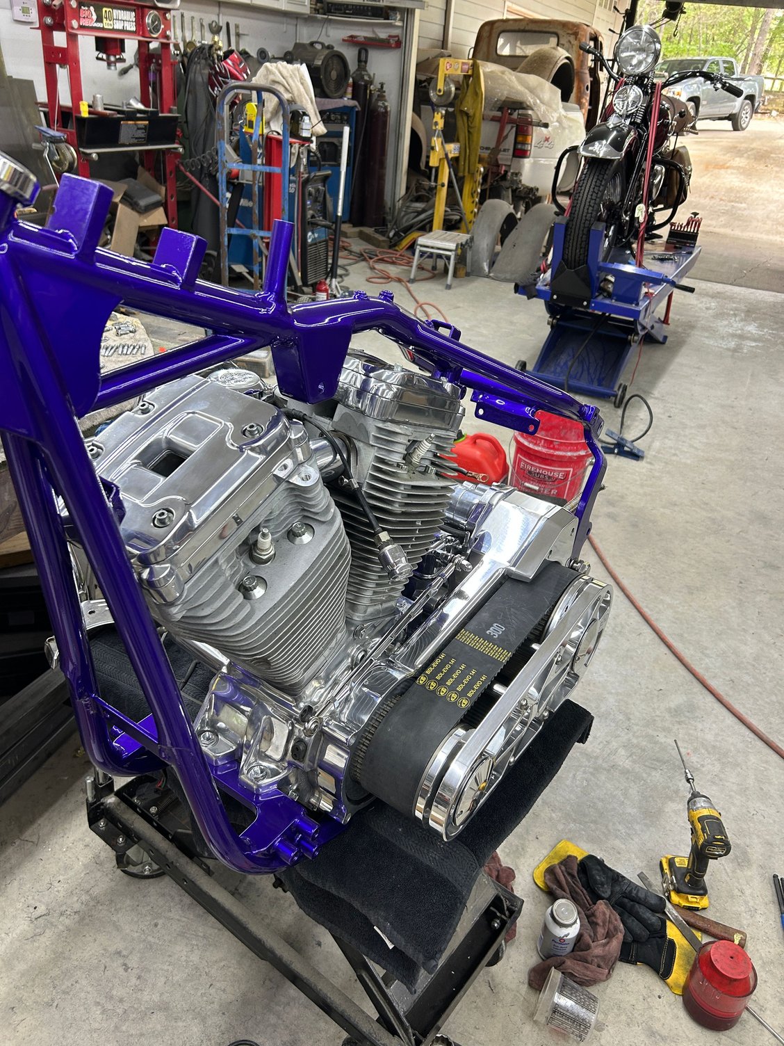

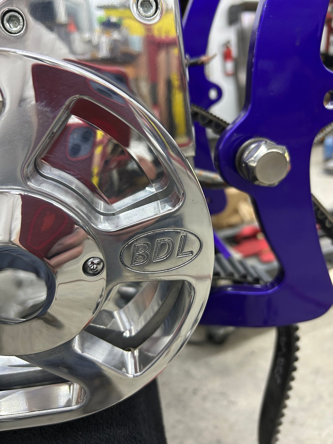

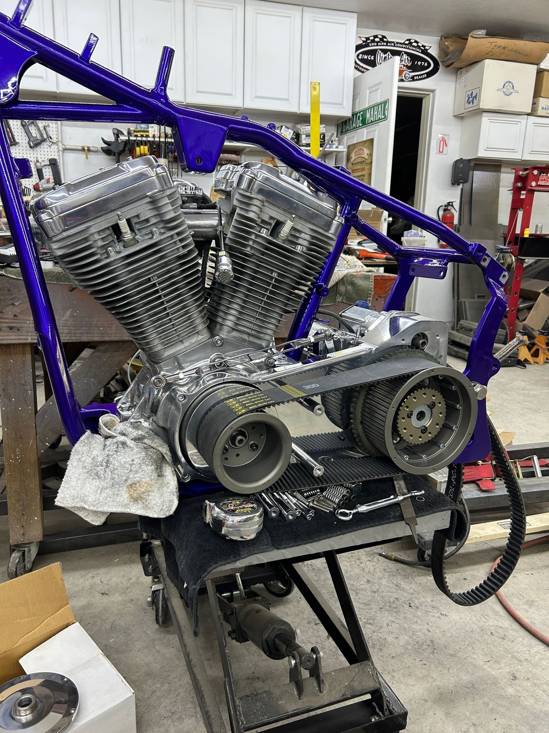

Well as some of the parts where missing like the inner primery and chain and stuff . I received a 3" belt drive for it years ago from my friend who didn't use it in his build some 20 plus years ago
I tell you what these belts are not easy to put on as they do not stretch as made a turn buckle to help slid on the shafts and they nicked up the shafts  so had to do a lot of hand filing to take the burrs off
I do like the looks of it but it was a whole day of putting it on as just one problem to the neext as the kit was fine just fixing the stuff that the crack heads did
Here's the name of the company with the belt kit
I can say that I'm really happy with it going forward as it brings back a lot of memories good and washing out the bad ones !
Aero charger turbo kit hope I can get it all back together and if all the parts are here Hoping !!
Aero charger turbo kit hope I can get it all back together and if all the parts are here, Hoping !! Still lots of 30 year cleaning but she's back home !! As it was in the courts for evidence almost 10 years .Making me happy again getting over the mental block of what happened to it !

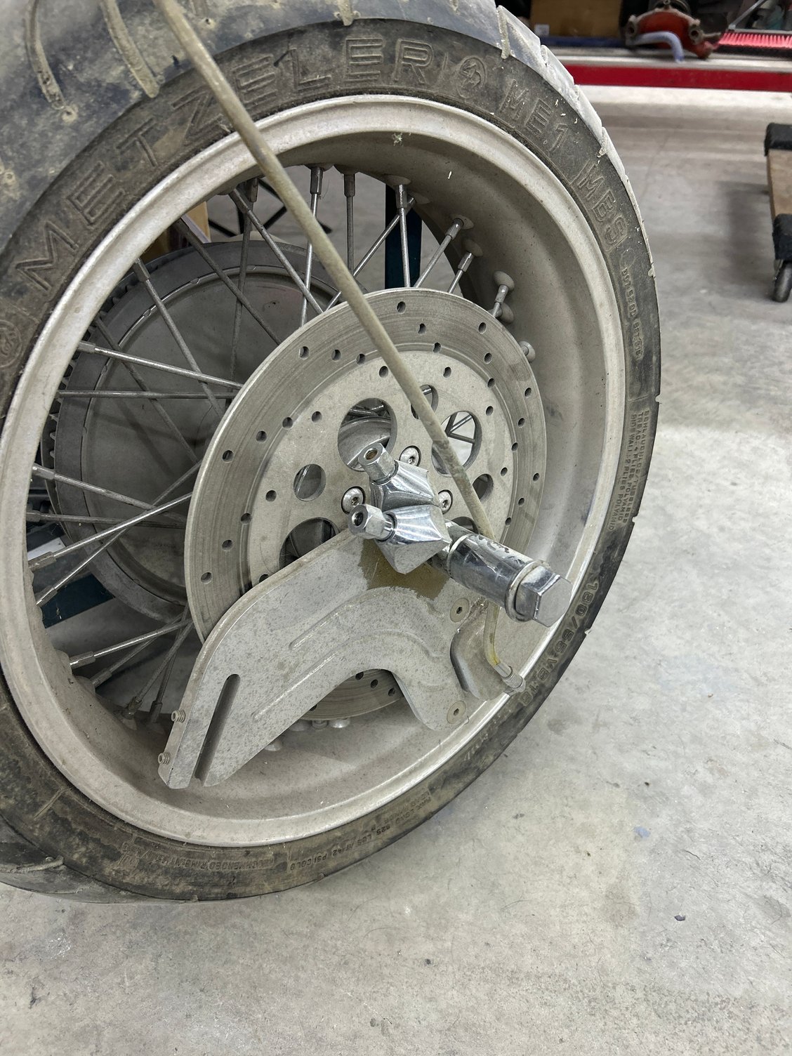

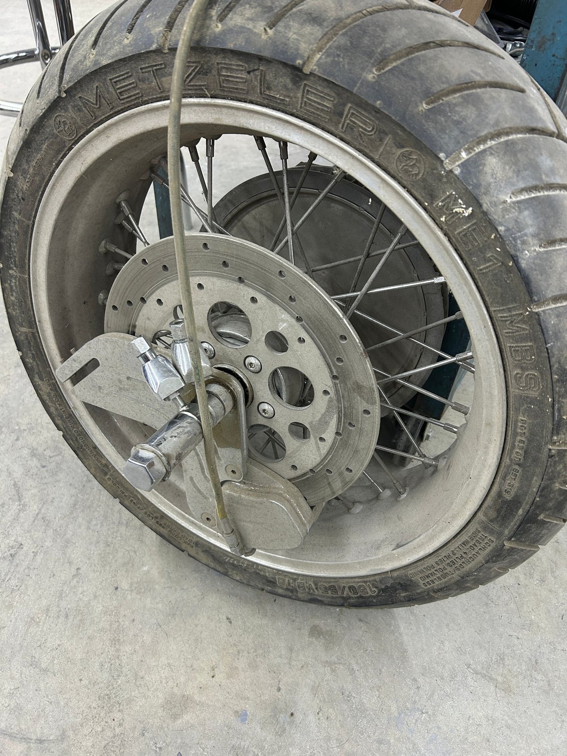

Well this is what the rims and brake parts look like ! Going to be fun polishing this stuff up

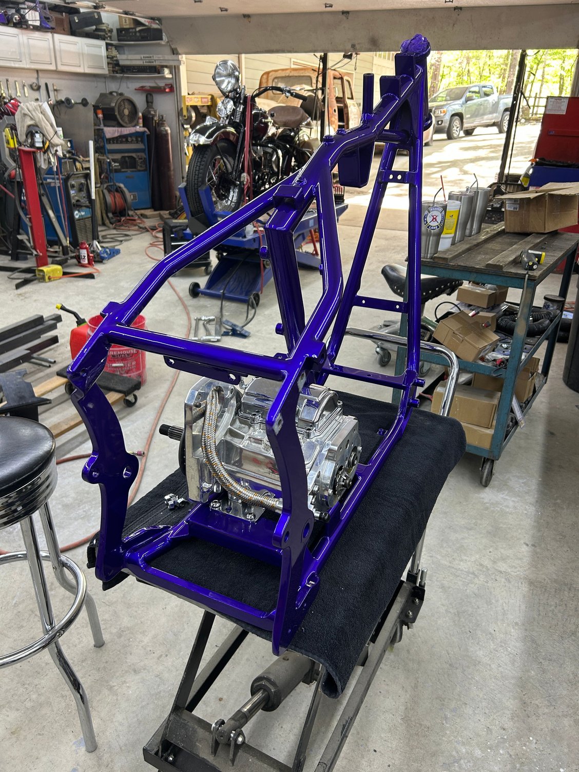

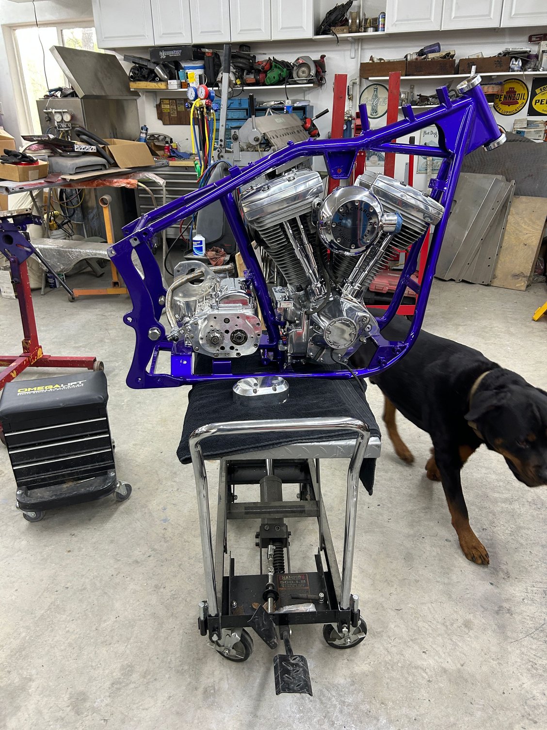

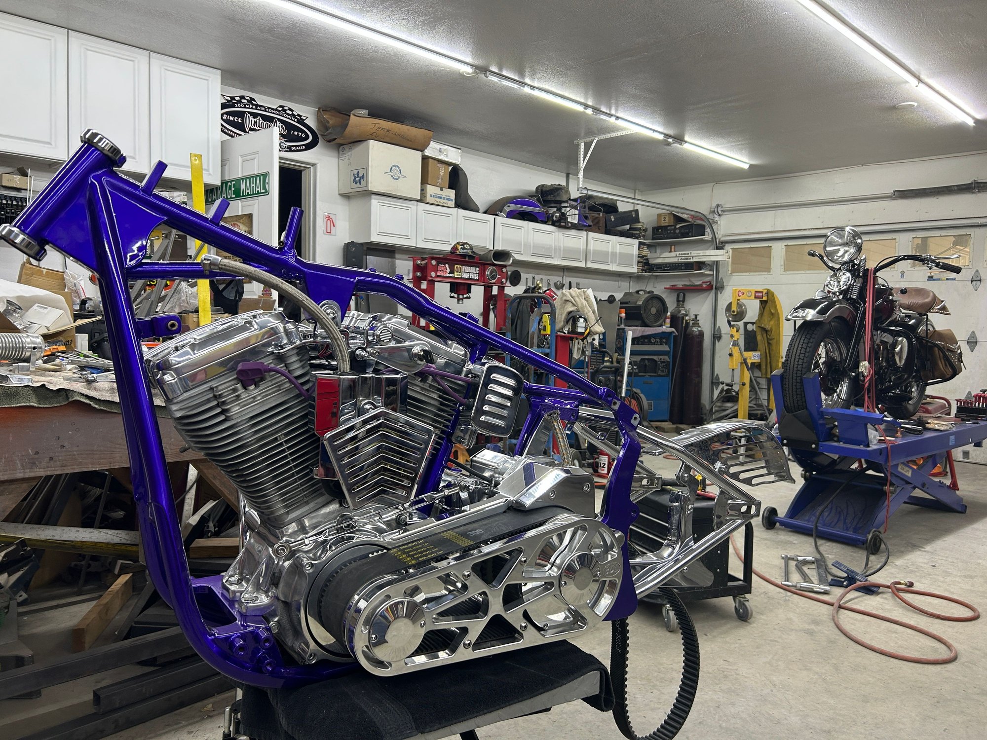

Did a little work today on it and was going fine till I can't find the rear brackets for the oil tank .
Got the coil pack in and the fuel pump and horn  brackets all in  . Workingon the rear swing arm
Even got the plug wires hooked up
Working on the rear swing arm
Put the torque plate on the engine and frame
