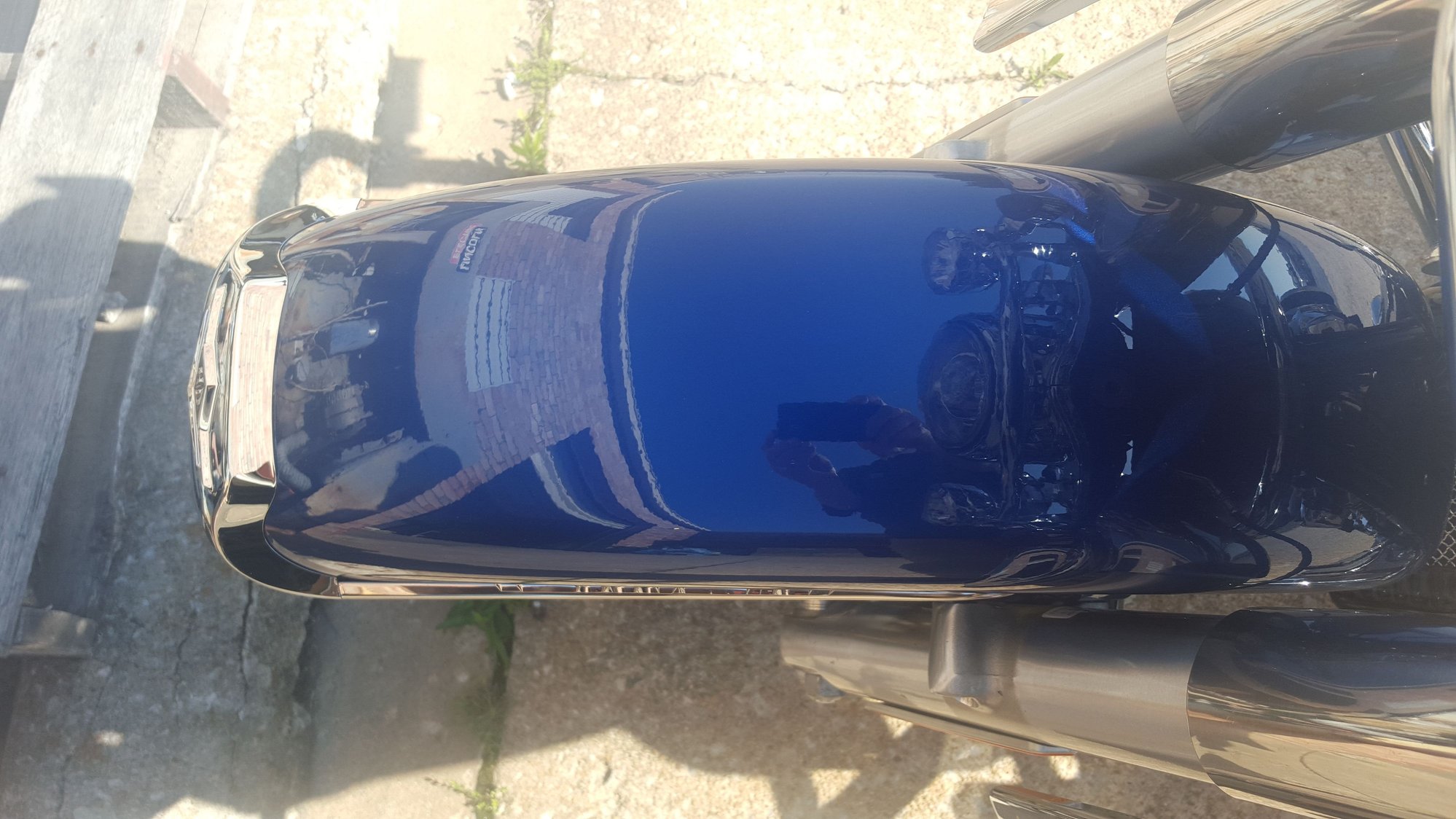

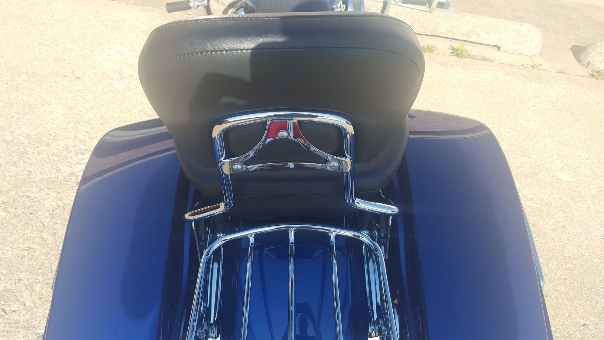

Got the tank, side covers and bags done. Have not done the fenders yet.
These pics are of a building reflection in the front fender and top of saddle bags. The front fender has so much orange peel in it the blind could read a secret novel in the paint.
It looks like Harley and the dealers use a pretty good filler/sealant when the bikes are prepped. Wash mine down and strip all that off and the orange peel looks horid....
Better now.
