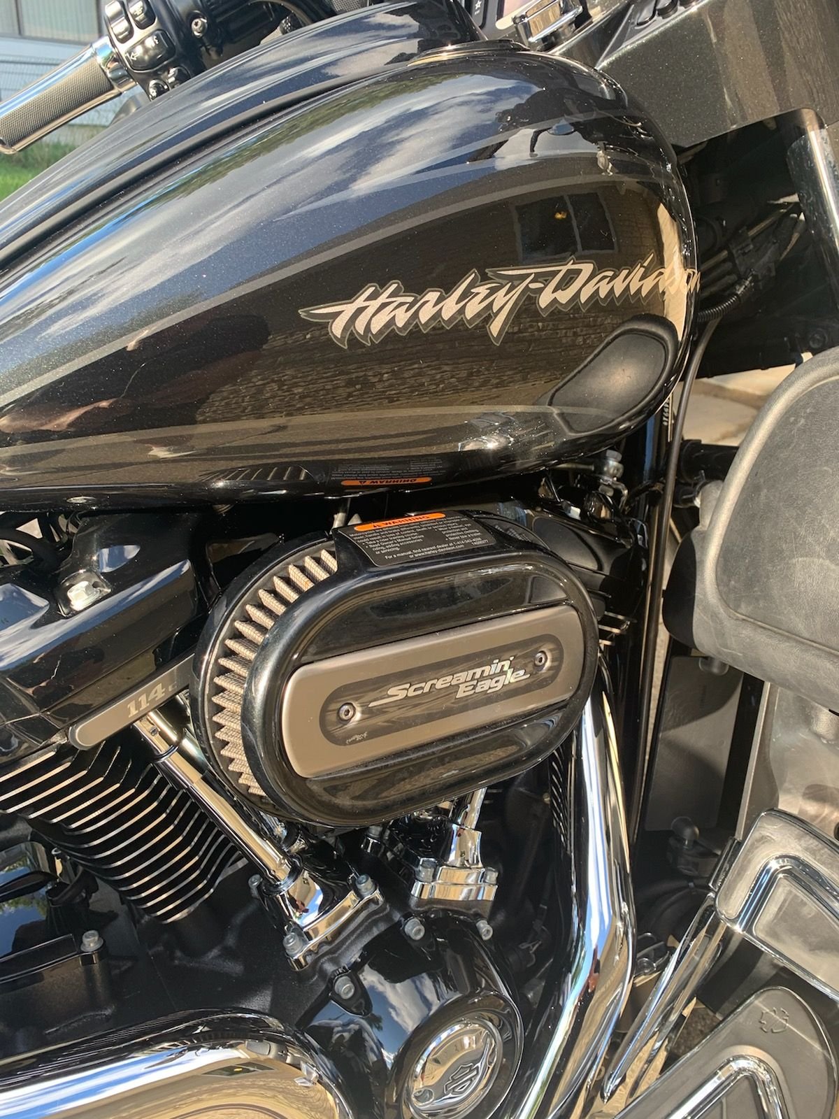

The Harley Davidson emblem on my bike is a decal and there are thin accent stripes that separate the two colors of bike is a raised decal as well.
Do you avoid them? Maybe tape them off some how?

Is this from the factory? If so it should be cleared over the top.
If it doesn't have clear over it, you can tape over it. I try not to go over tape when polishing, just up to the edge

clear coat from the factory over the top of it, I was concerned because I had watched a vid where Mike at Autogeek mentions that basically when you polish, you are leveling the surface of the clear coat
my concern was that, even though it has a clear coat, both the HD logo and the pin stripe are slightly raised.....and I'm sure you can imagine what I was concerned with
I'll be using the G8, not a geared polisher, foam correcting and finishing pads, and Wolfgang's Swirl remover and Finishing Glaze.....the type polisher I got is better for newbs, foam pads are better for newbs, and per those who know more than me, Wolfgang has "excellent abrasive technology" and I chose wisely

My 2009 has cleared over stripes on it. I’ve compounded, clay barred, polished and waxed it for 12 years. It’s never hurt the clear or the stripes.

Yes, blue painters tape over the decal will protect and work well, eliminating your concern.
Then hand polish the decal area if need be,
FWIW I too would assume the decal has a clear coat paint over it.

That blue tape is for the house. 3M makes a automotive tape that is designed for painting and polishing. Ive used blue tape before when I ran out of the 3M stuff. Used it around a sun roof gasket, it worked but not great

I have a clear coat over everything, I have some parts that are in great shape and will get a finishing glaze only, some parts need correcting and then glaze, the bike is segmented enough where I can be less aggressive on parts that don't require that much leveling
