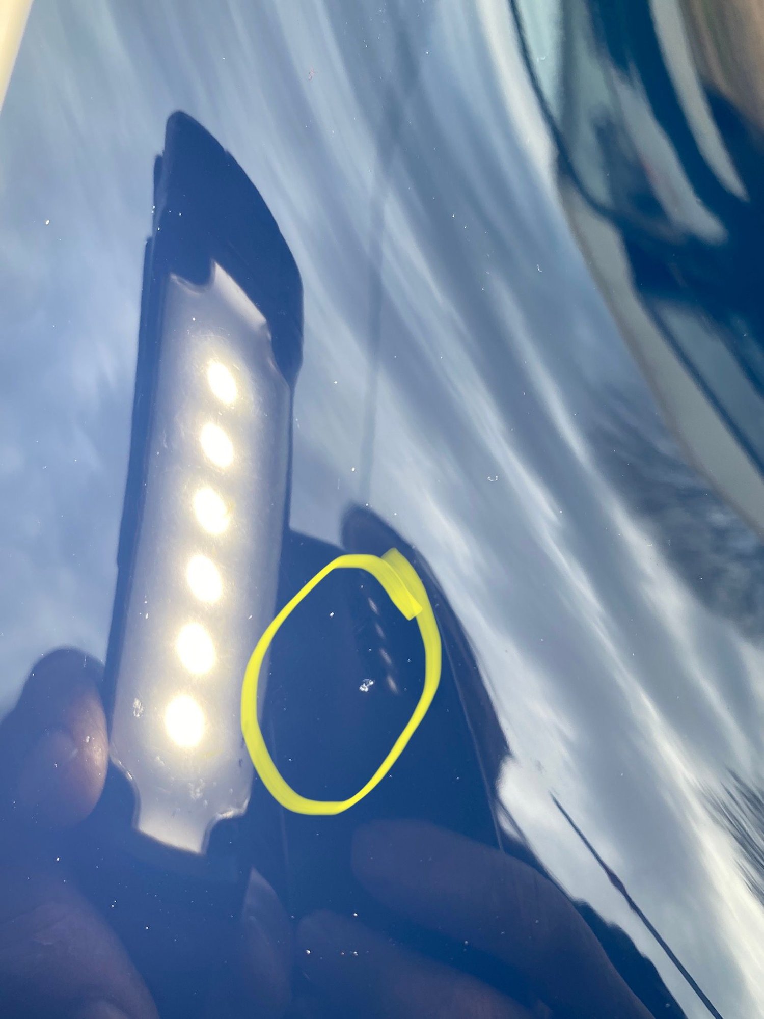

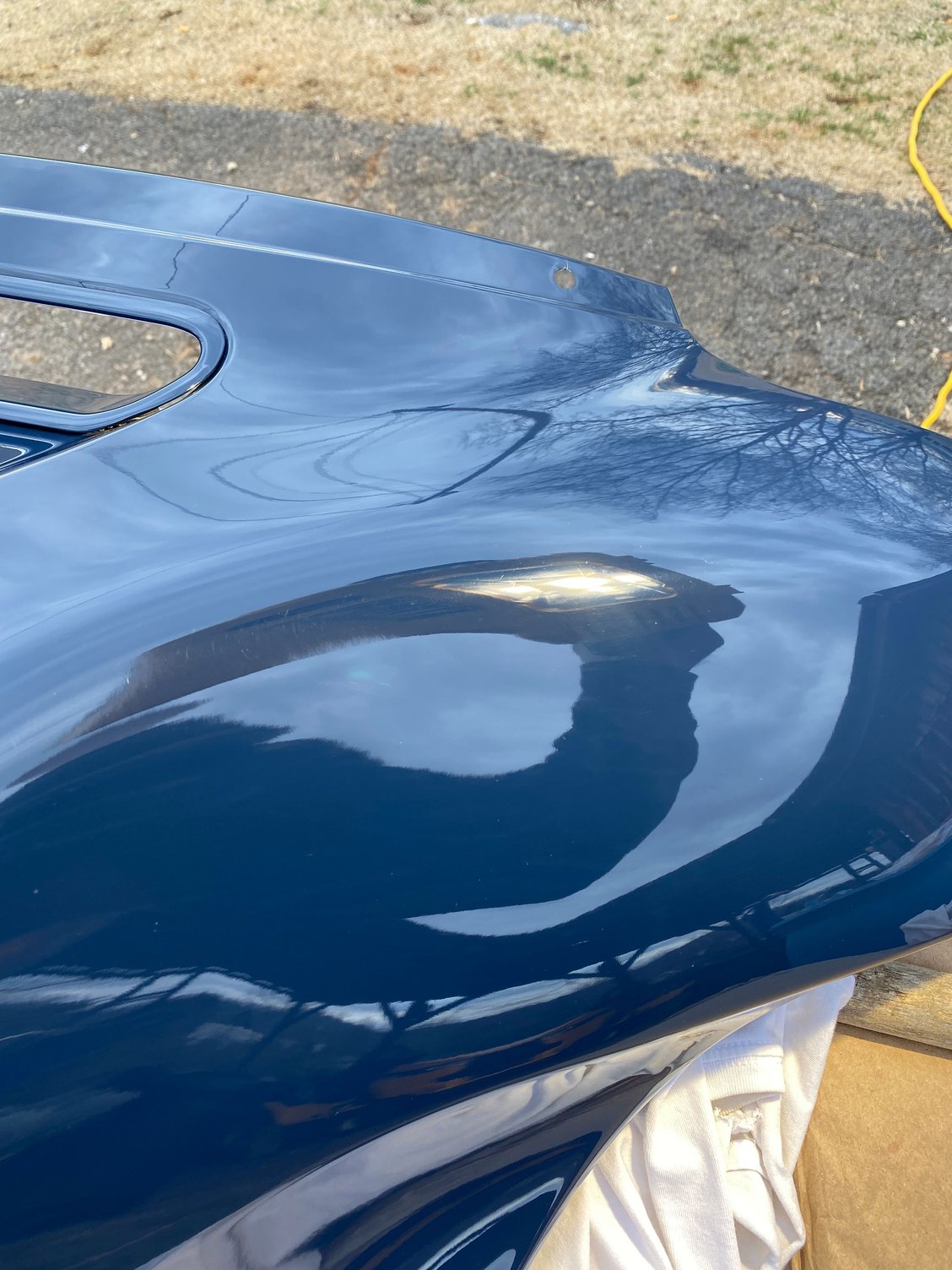

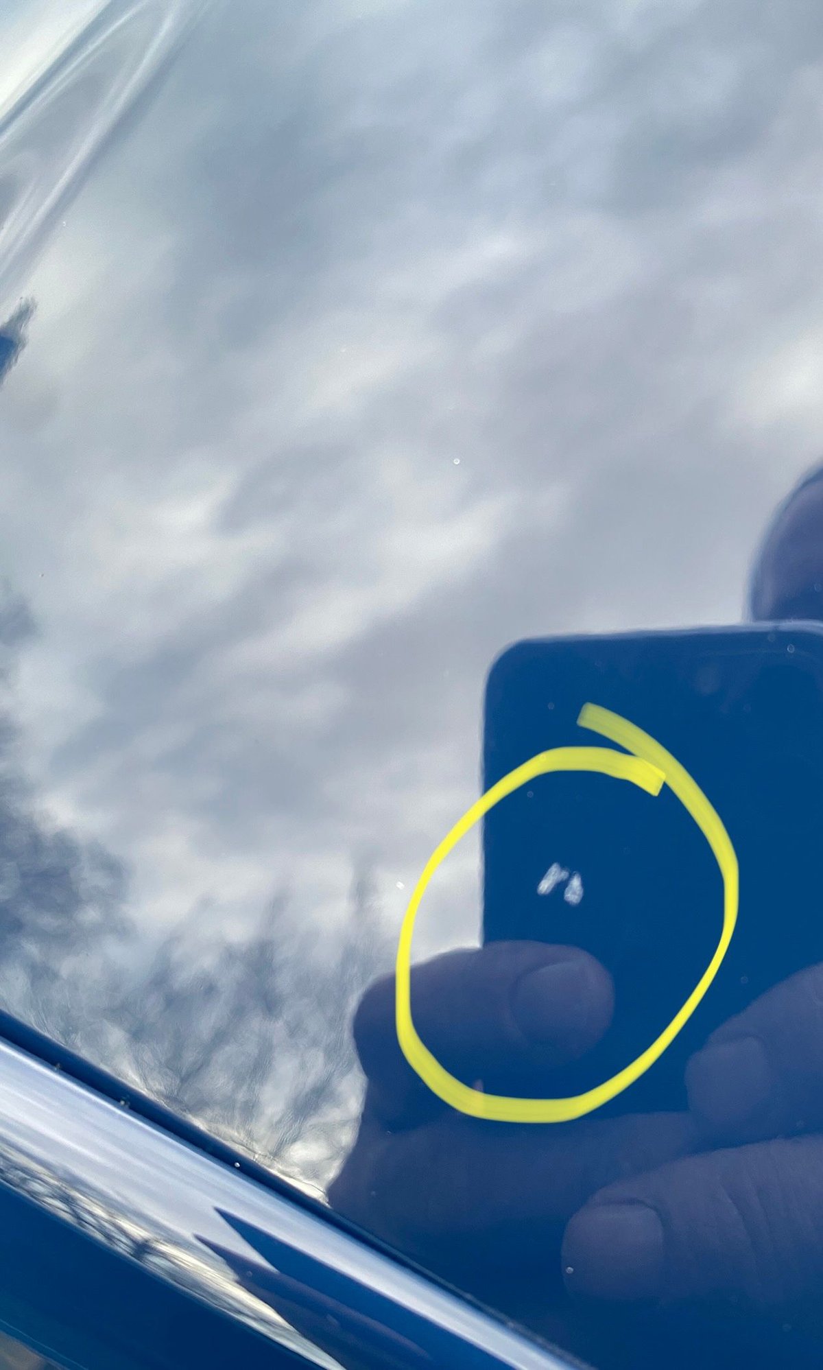

You guys were right about not working the compound long enough, and the tips about marking the edge of the pad helped too, it made me start paying more attention to what the pad was doing. Anyway, I had a couple hours to play around with it today and am happy to report that I got it looking much better, I went back over the whole fairing with a thicker Griots orange pad and my WG Uber, and I broke it up into small sections-I found it much easier this way, rather than continually going in and out of a bunch of curves and having to readjust how much pressure I was putting on the machine. I was definitely NOT polishing the compound out all the way, though, and it looks a lot better today, I still plan on going back over it with finishing glaze and black pad, I’m not sure if I should do a pass with Total Swirl remover first (all WG products). I am ordering some 2” pads though, after my conversation with CaffeineBuzz, I do believe it’ll be much easier to polish the fairing with a smaller pad because of all the curves.
I do have some major, deep gouges in the fairing that I didn’t realize were there (well I knew one of them was) because it’s usually so covered in dead bugs that it’s hard to tell guts from damage. I’m not surprised, I think most of them are from interstate riding, so it is what it is, the only way to fix these would be to repaint I think. Anyway, thanks again to everyone for all the help and tips…CaffeineBuzz, thanks for taking the time to talk me through some of this, you’re the man buddy!
One of the deep gouges
This is the worst one, it’s pretty noticeable
Looking much better
