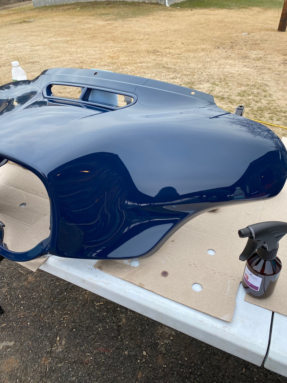

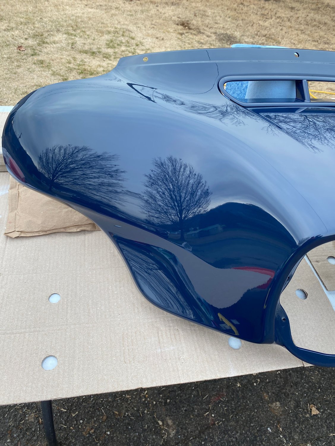

I finally got a free day to finish up the outer fairing…went back over the entire thing with Uber/orange pad and Finishing Glaze/black pad, got it looking presentable anyway. The rain held out, so I got it coated as well, I really like the Polish Angel products, they’re easy to use and man do the really make **** shine ! Used the Primer, Cosmic and topped with High Gloss spritz using the process CaffeineBuzz suggested. Really happy with the results, can’t wait to get started on the rest of my bike (I brought the fairing inside for tonight to allow it to cure, not sure how well this stuff works in colder temps). Thanks Buzz again for the guidance and everyone for suggestions and tips…

Polish Angel Cosmic and High Gloss are the real deal. However, polishing is were the magic happens. Looks like you got that paint figured out
Looking good! Looking forward to the "All Done" pictures

put your towels away fellas.....it's not wet....he's just that good
great job, brother
