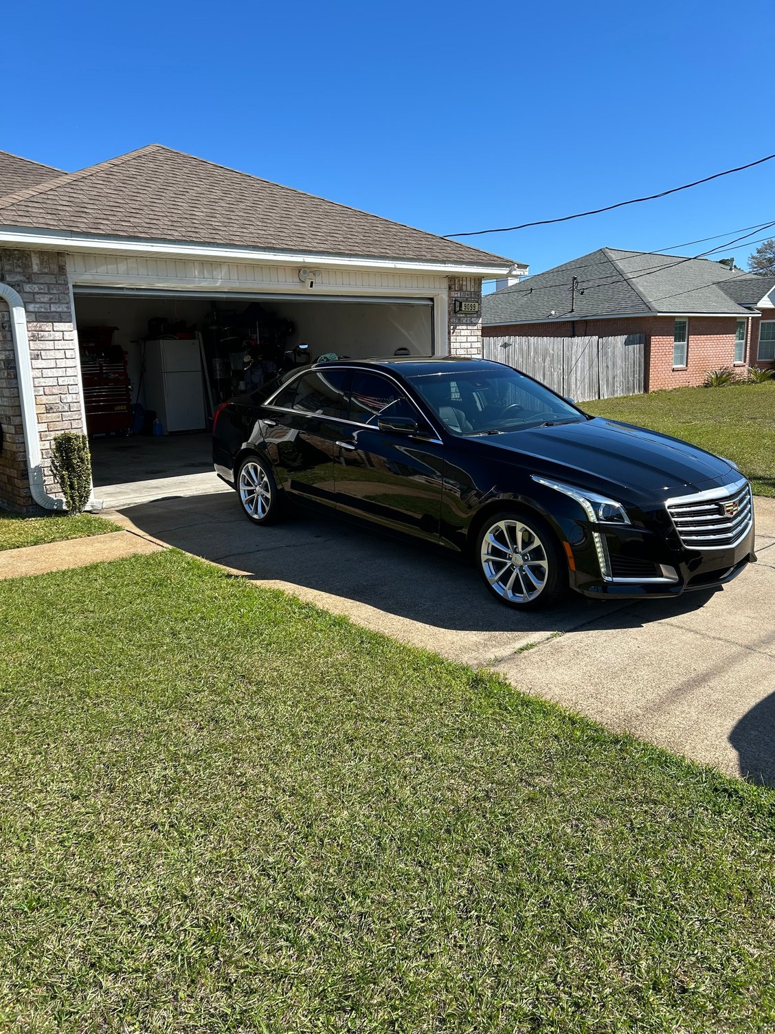

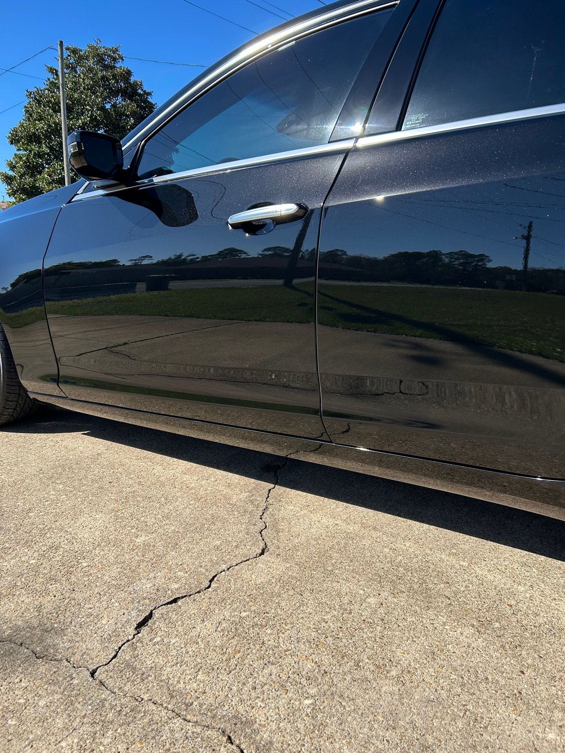

I did my wife’s CTS this weekend. She got hit around Thanksgiving in passenger fender and the front passenger V wheel. It was coated 3 years ago with Gyeon Pure Evo and it was still going strong
This time it got Kamikazi ISM 3.0 after it got polished out with CarPro Reflect on their gloss pad. This is an absolute killer combo if your looking for big time gloss
Not bad for an 8 year old car
