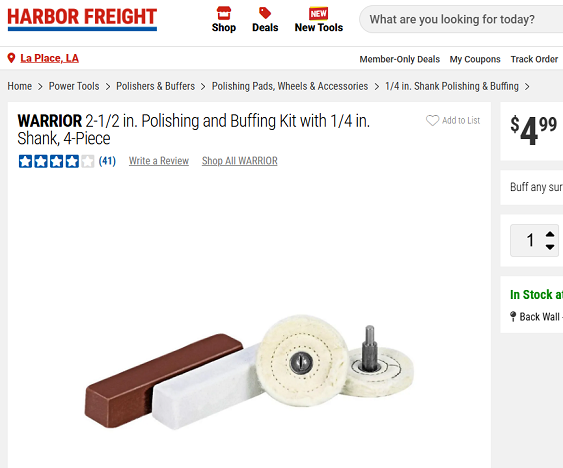

For aluminum, this works good by hand, and also works better with the little buffer wheels in this cheapo kit.
Good on chrome, use with 0000 steel wool.
