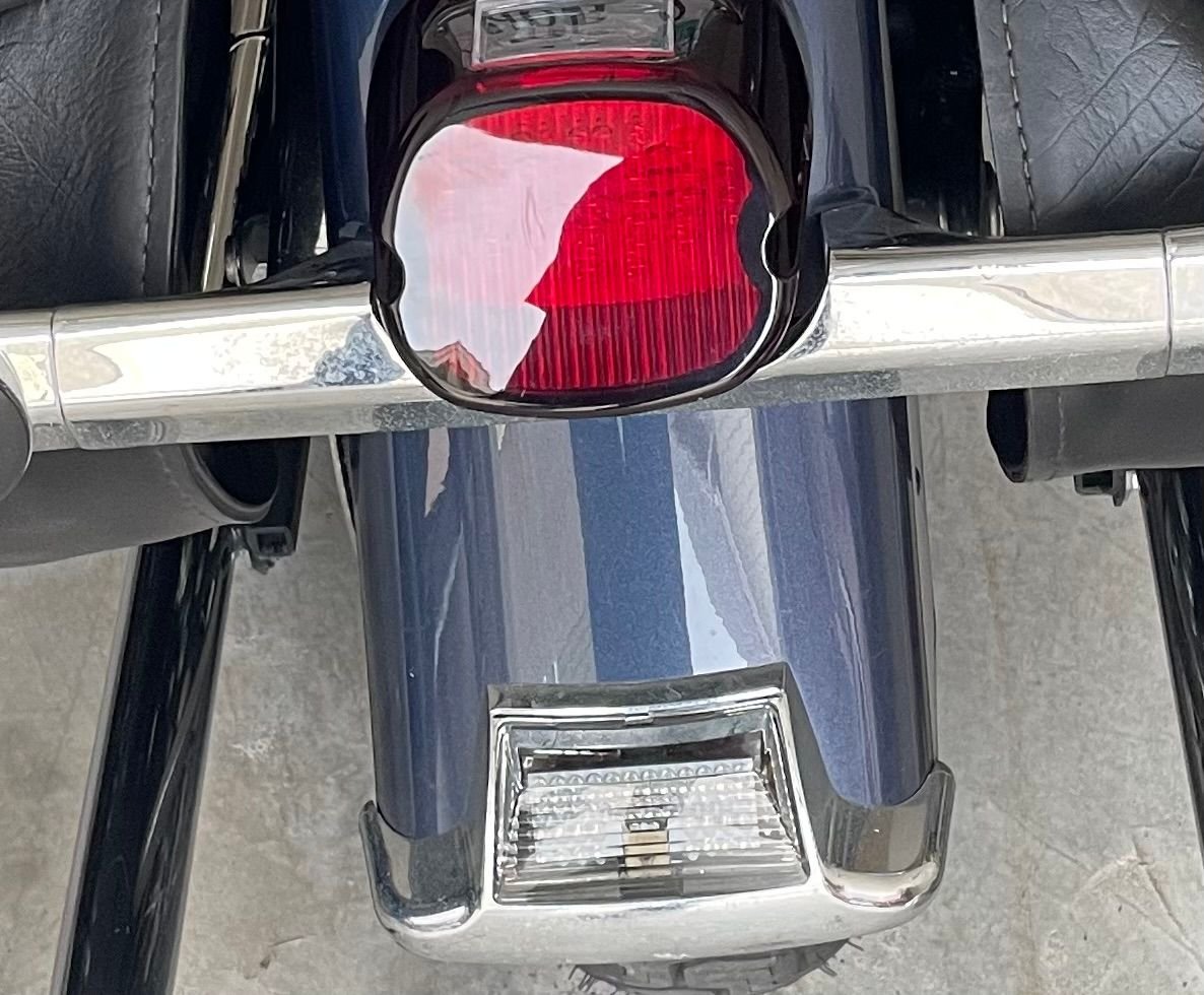

What is everyone’s go-to when it comes to cleaning “old chrome” and aluminum?? I’m not talking about polishing your pipes or new air cleaner cover. I have a 2008 Heritage that has been sitting in a garage for the past 12 years and the chrome is pitted and dull and covered in water spots and some rust. I’ve seen a lot of advertisements for Chemical Bros, MAD Iron Eraser and Rust remover, etc.
Do any of these actually work???

I have had good luck with 0000 steel wool and and a liquid chrome polish (I prefer Turtle Wax brand. It will remove the rust but the pitting will remain. A good quality wax or sealant will prevent it from rusting but it will need to be reapplied regularly.

I use Turtle Wax chrome polish for regular maintenance and upkeep. What I’m talking about is old pitted and rust spotted chrome. Turtle Wax is useless on this.

Once it is pitted and rust, 0000 steel wool with product of your choice is the way to go. Sometimes just water can be enough, good luck.
