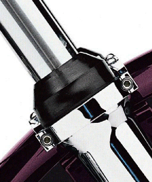

it's weird because 1. why would the chrome sliders be any different than the stock ones, and 2. if you look closely of the picture of the chrome fork sliders on the HD site it actually appears like there is a brace installed with the chrome sliders..
I can take the decovative caps off and mesure, maybe try to do some research and see if something will fit,,, just was hoping that someone had already been through this.

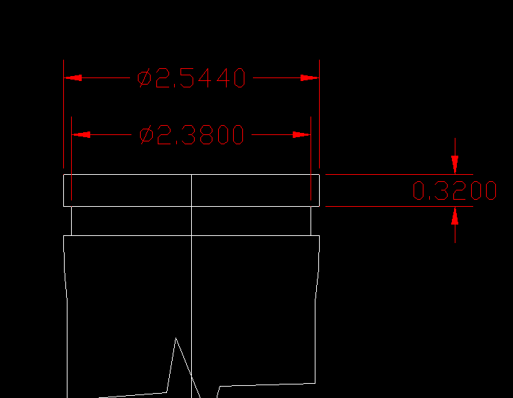

Yes I could possibly polish it out to fit it if is only a 0.01-0.02" difference in diameter. I wonder if someone can help me, I measured my fork slider under the chrome cap and this is what I get, could someone with stock forks measure theirs or measure a fork brace to see how much difference there is??

I read in another post that it should fit, even the Halrey pic for the chrome lowers shows a brace installed. looks like the brace fits below the dust covers. maybe I'll see if I can test fit one from a dealer and return it if it don't work,

got the brace and installed it, some lessons learned...
1. Superbarce did kindly answer the question on Monday and explained that in fact the only reason the braces are said not to fit chrome lowers is because of the thickness of the Chrome and that a SuperBrace will usually bolt right on,
however the brace I bought did not bolt directly on. I could fit the clamps on each individual fork fine at first but not get the whole brace on as an assembly so it seemed the centering of the fork was off and that I would have to grind down the 2 halves of the brace to make more room, I spent about an hour doing this and still couldn't get it to fit,, then I determined that infact the diameter of the clamp would need grinded out larger, Had I thought this out before acting I would have measured everything first to find the real problem, anyway this is what you do to make this fit,,
1. Assemble everything together & tighten bolts,
2. use a dies cutter to grind material away on the ID of the clamp near the split to make it fit.. you probably could also do this with a dremel sanding wheel.
So for anyone else looking to do this, there you go, it can be done, and quite easily,
also it helps to use tape or clamps to hold the dust caps up out of the way..
had I had used good engineering skills and thought ahead of time this whole thing should have only taken 30 minutes, I ended spending almost 2 hours, but good lessons learned tonight
