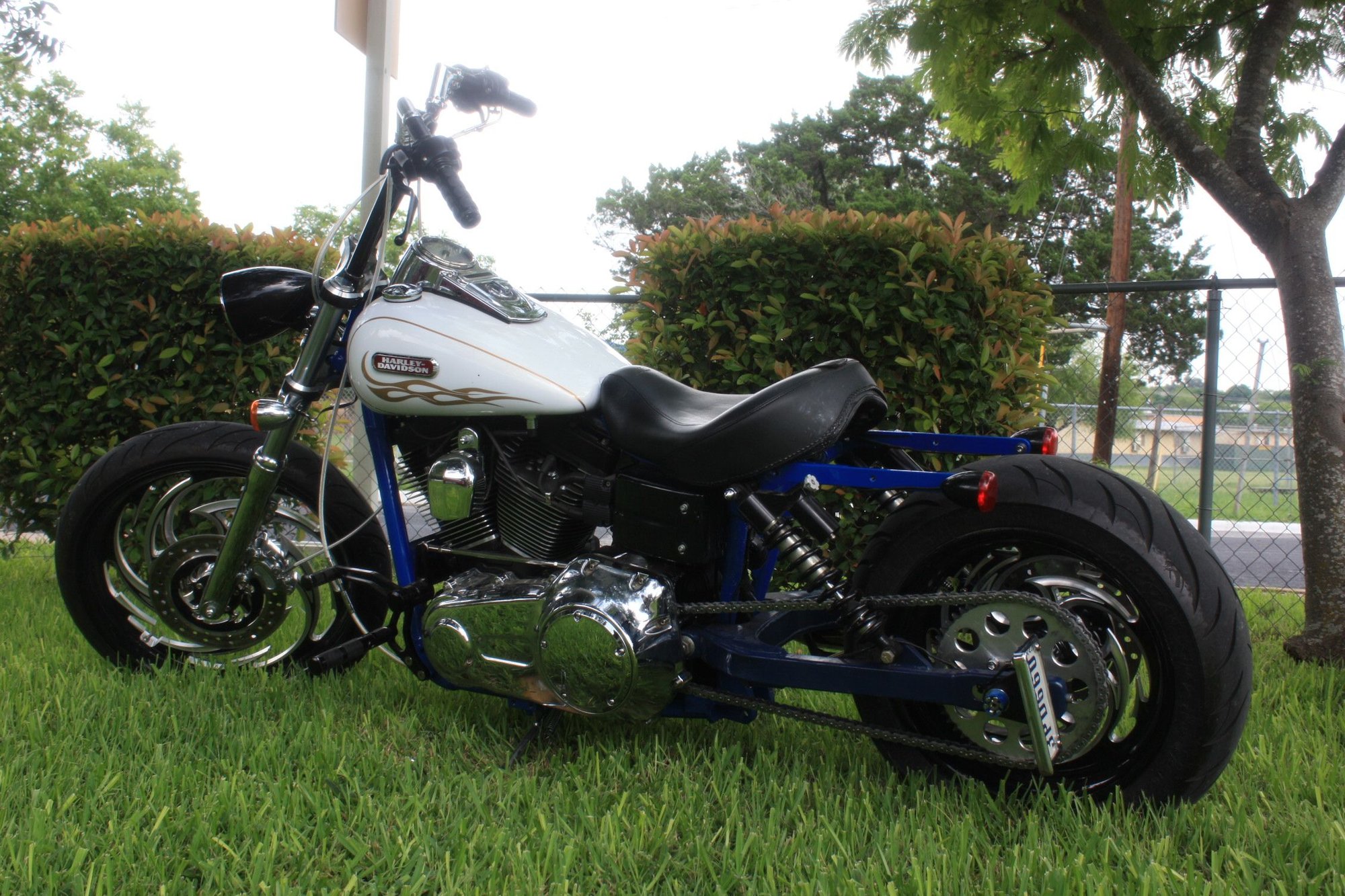

I'd imagine you would be ditching the Debris Deflector and Belt Guard for a 72T! Looks like filthpig ditched a lot more too!
I bet you don't ride it the rain too much...

no rain riding at this time! I have the debris deflector and belt guard from a V-rod I will eventually mount up, the grease from the chain is a major b#tch to clean.

A good friend/coworker of mine had his '99 superglide pretty much just like that but actually cut the struts off and mounted the bullet signals under the solo seat and had a 200 tire on it. He rocked it like that for a long time, it was definitely different and the bike felt so light. He finally decided rain sucked too much and welded struts back on it. I wish I had pictures of it.
