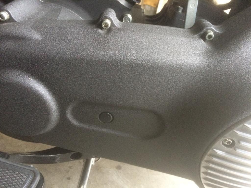

I did my '07 without removing inner or outer. Used the hack saw method for mid shaft removal. The plug for the outer case just pushed in. Footboard kit from harley came with a black one and chrome. I have since removed my inner and outer primary for compensator replacement, no sleeve over the shaft with O-rings on my bike as mentioned above. Maybe the '14's changed, not sure.

Yeah, the kit came with a push in plug for the front hole.

Yeah, no removal of inner and outer on my 14 here. Cut, and remove. Kind've jealous of your black plug, mine only came with a chrome one. Oh well, guess that will work.
I'd scuff it up and rattle can it. Mines shinny black, not wrinkle like my primary, you could get wrinkle in a rattle can, semi gloss or flat.
