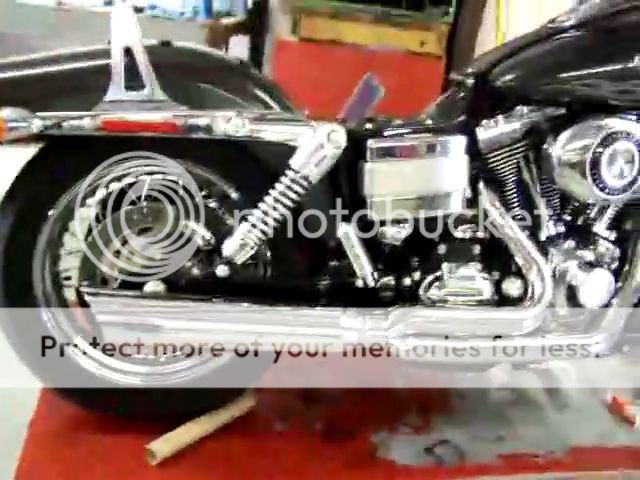

I ran a built 103 in 2007 WG to well over 130mphin 5th gear on a GPS.
And it was a 6 speed.
Would of never even wanted to think about a wobble.
