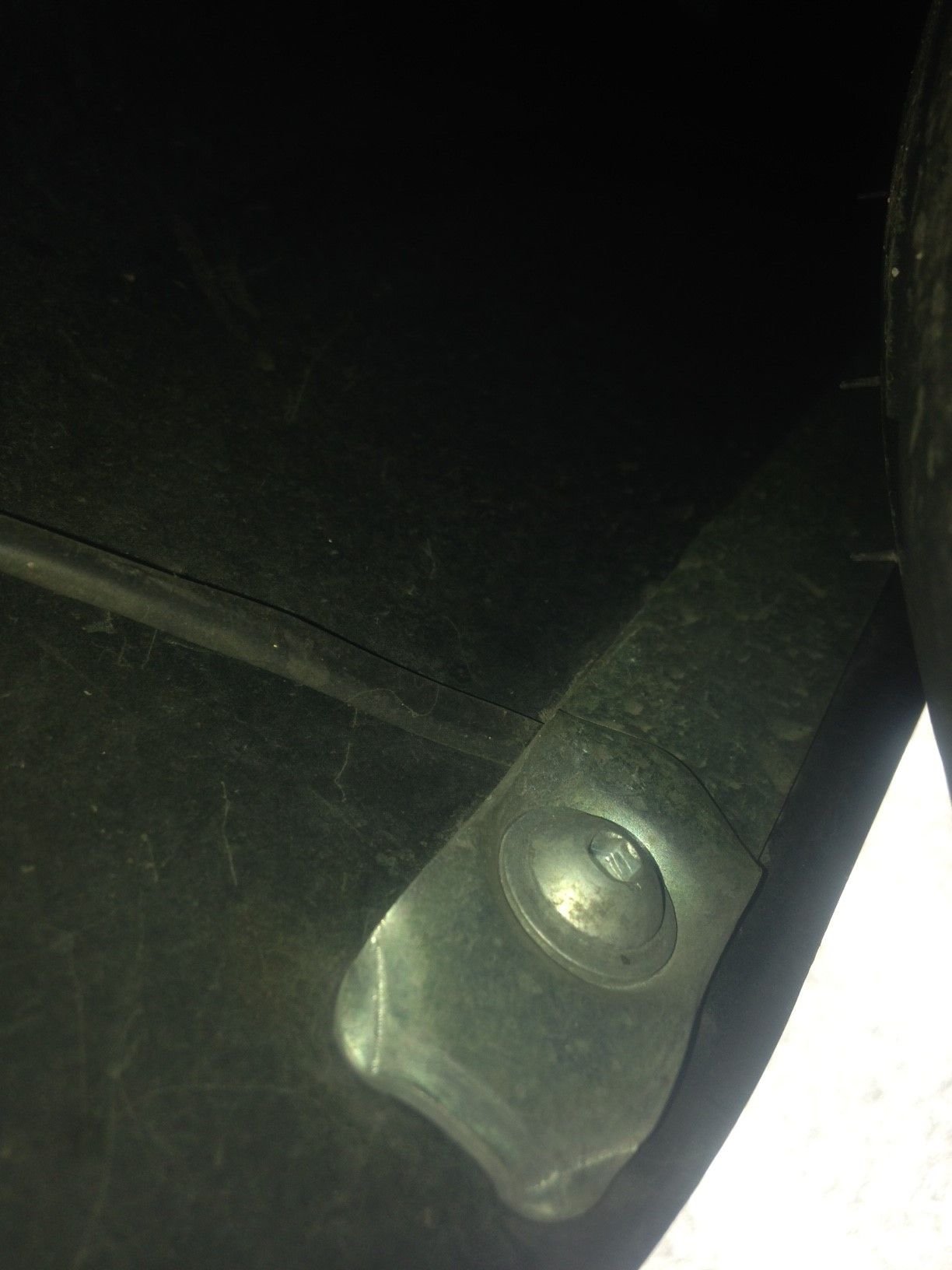

Posts: 7
From: texas
Rubbed wites 2nd time
Attached Thumbnails Wide rear tire on Street Bob - need help with part numbers please!-image.jpeg

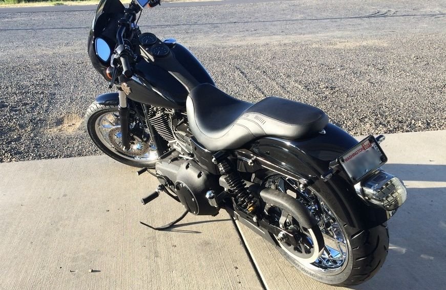

Man, are those the bolts for your TSs?
I ditched my bobbed fender. The full fender wires go down the center, glued to the fender.
Fat tire installed:

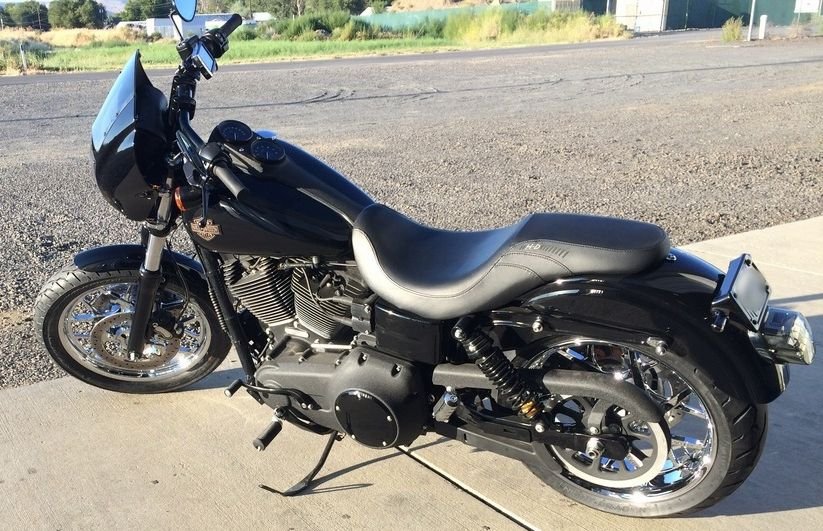

thank you Craig
I will upload a photo of how my tired rubbed my wires on a long 800 mile trip.
it is getting to probably needing the full kit?
You don't need the full kit, mostly because all it is, is a tire the 4 parts you do need and two zip ties. All you need is 2 x Screw #4592 and 2 x Bracket, Rear Fender #59514-06 and call it a day.
It will look like this when its done. I just went out and took
this picture cause I rode the Dyna today.
HD yes they are, you think the bolts is whats causing the rubbing?
Your tire and fender look awesome, can you post more photos of the full bike?
Where did you buy fender and $?
I would go with button head, for sure. The plastic wire keepers listed above will help.
My fender, and all parts (except for plate holder) are genuine HD, and you can price it from any online HD store for a '15 Lowrider.
Pics? I take shitty pics, but:
