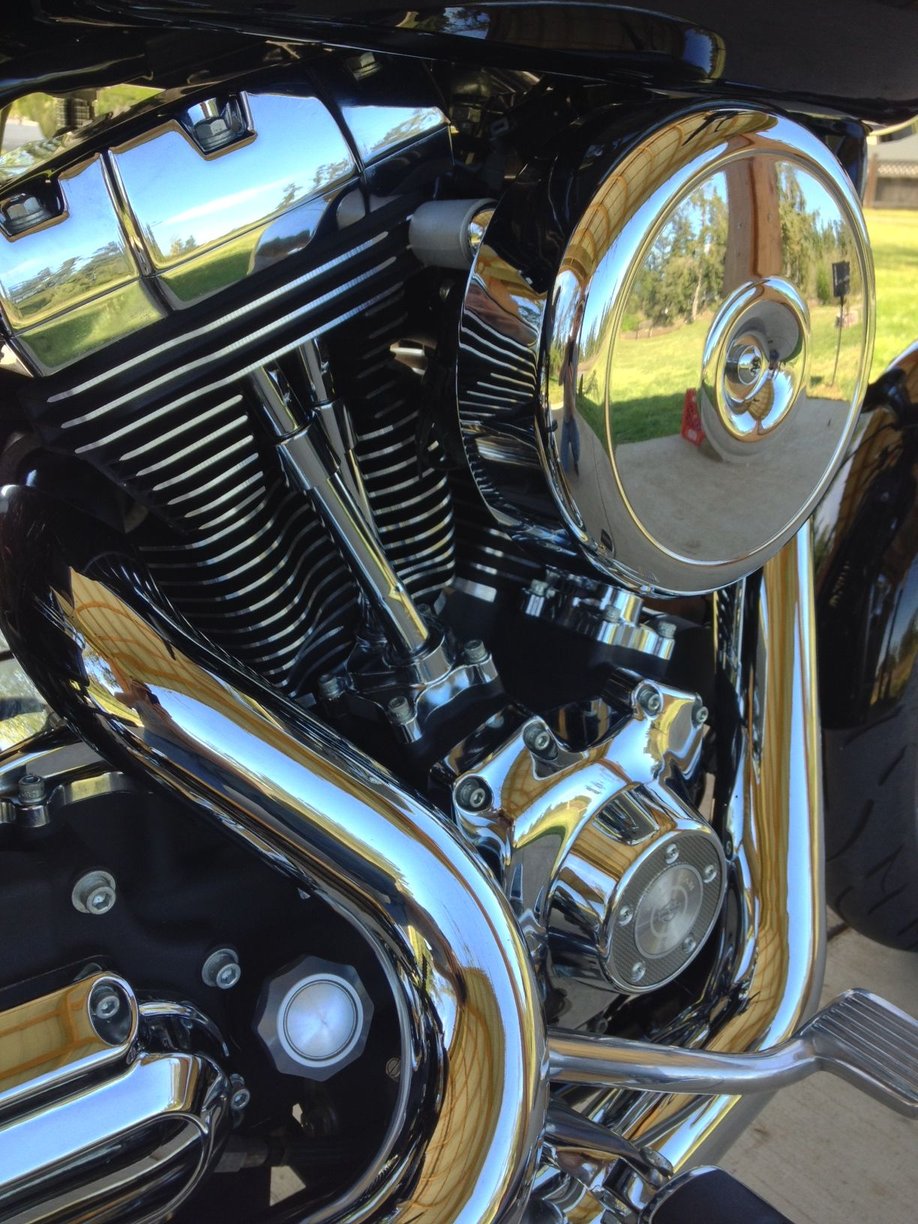

Stage 1 kit and OEM HD Blackline or the 13+ street bob cover should give you the look you want and a stage 1. This is a Blackline cover.
