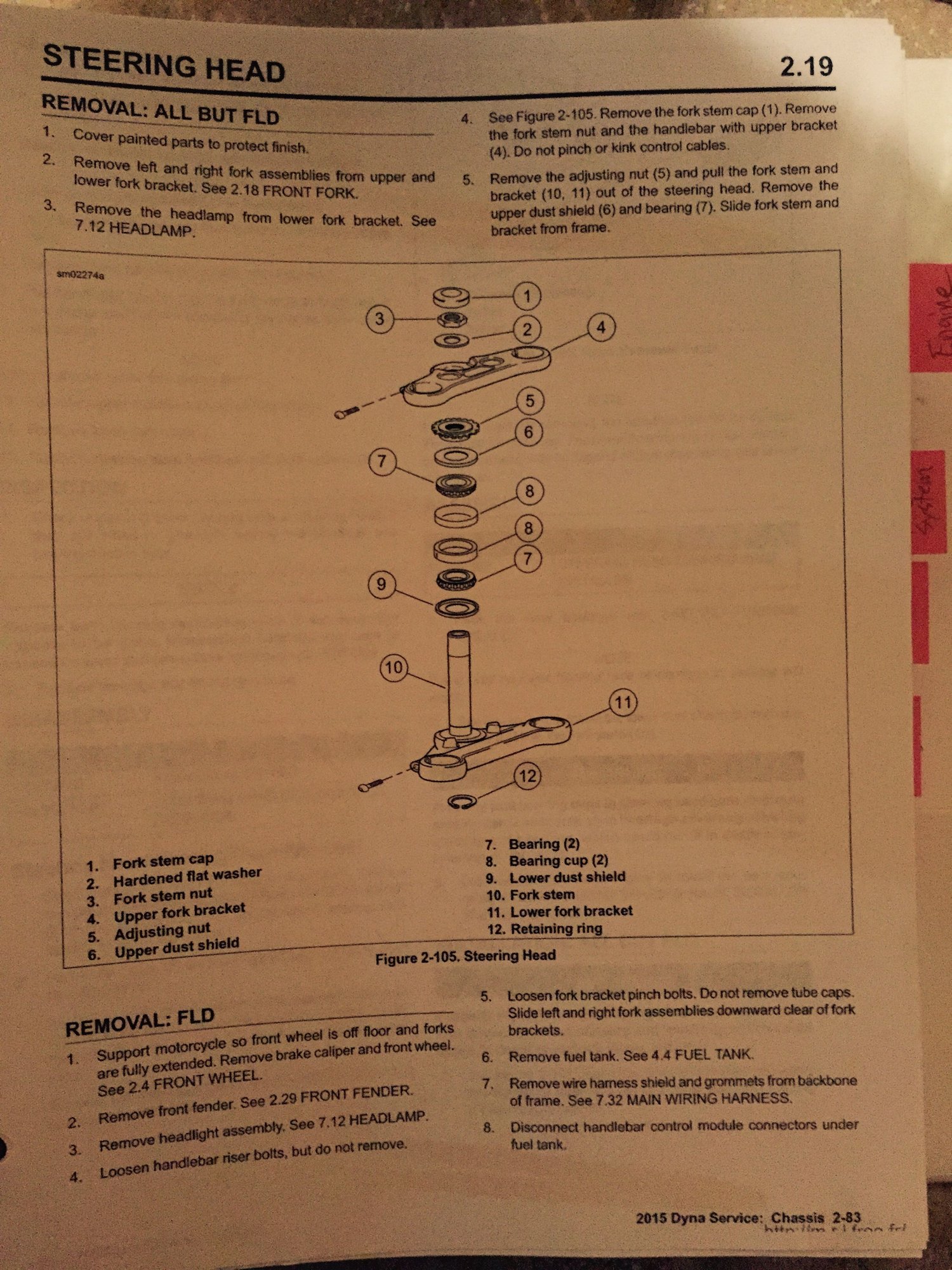

I have a 2015 FXDL and I'm disassembling the front end for powder...
So, I remove the steering head nut, etc and slide the lower tree and fork stem from the neck and then I notice that the lower set of bearings and dust cover won't come off the lower tree. I did this same thing to my 2011 FXDC and the lower bearings just slid right up the steering stem.
I tried wedging a flat head in between the dust cover and lower tree and tapped away but there was zero give. I got tired of messing with the thing after a while and my taps turned into a couple good whacks. That was smart...now I need to replace the bearings and dust cover.
Anyone else run into this problem? I can't imagine the newer dynas have the lower bearing and dust covers pressed onto the stem/lower tree, but it sure seems that way.

To remove your bearing you will need the proper bearing puller. They sell at Harbor Freight if you want cheap. Taking a screwdriver is not the way to work on your bike. The shaft is slip fit and the bearing is not pressed on. Usually a bit of rust forms a bearing removal tool is needed.

That's why I was a bit confused. When pulling from my 2011 last year it just slid right off. Now pulling from my 2015 LR (can't imagine why it'd be harder than the 2011) it didn't budge. That's why I figured a quick pop from the screwdriver would work. I mean, hell, took my entire fork set apart with a flat head. lol Anyway when it didn't I thought there must have been a design change or something...and got a different answer to that from every tech at the local HD. Go figure. Sure enough after the tech pulled the bearings and dust cover, it was clear that it wasn't pressed on.
