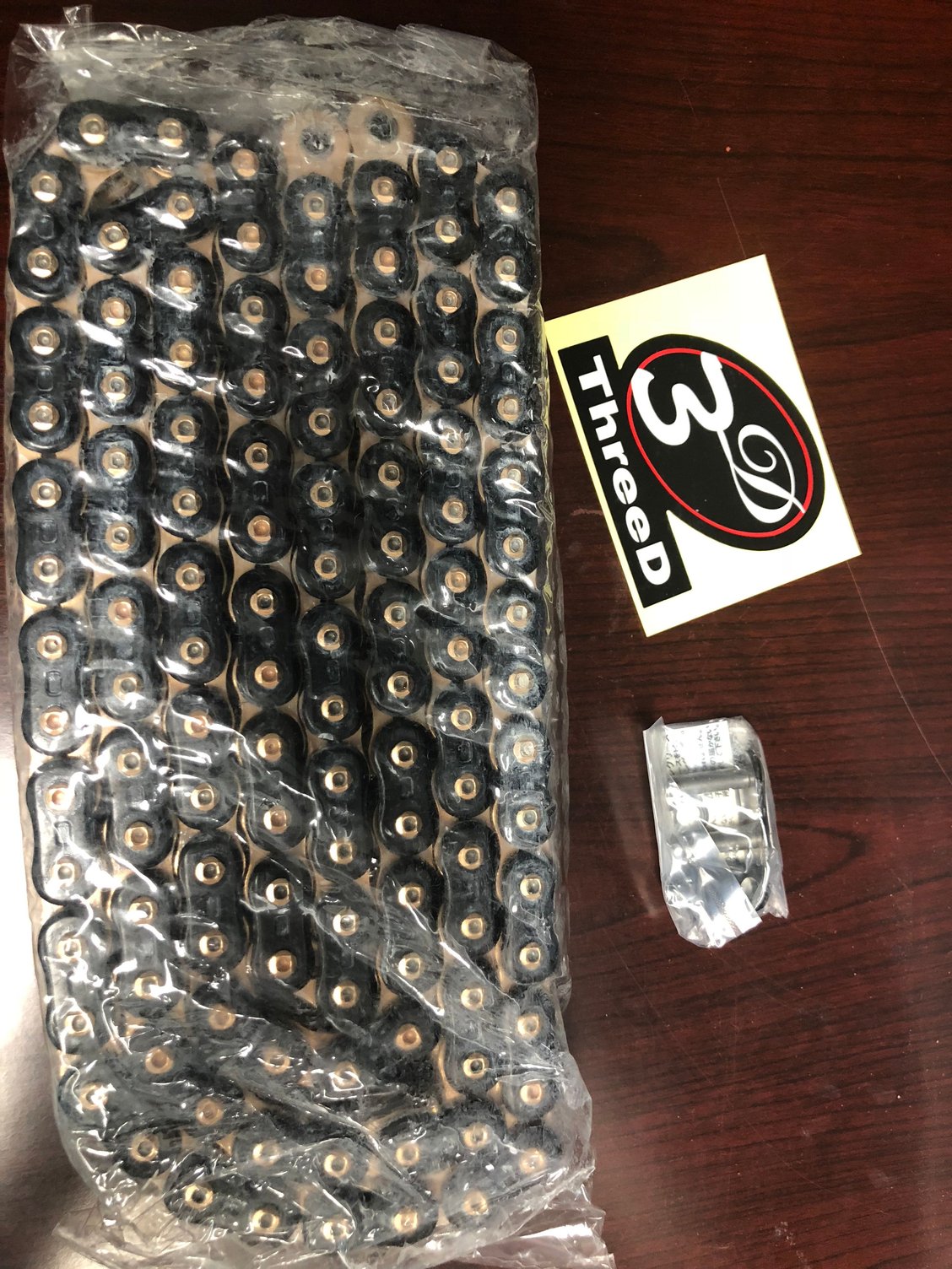

Mine came in last week. Extremely nice quality and according to specs, built like a tank! Can’t wait to wring it out.
