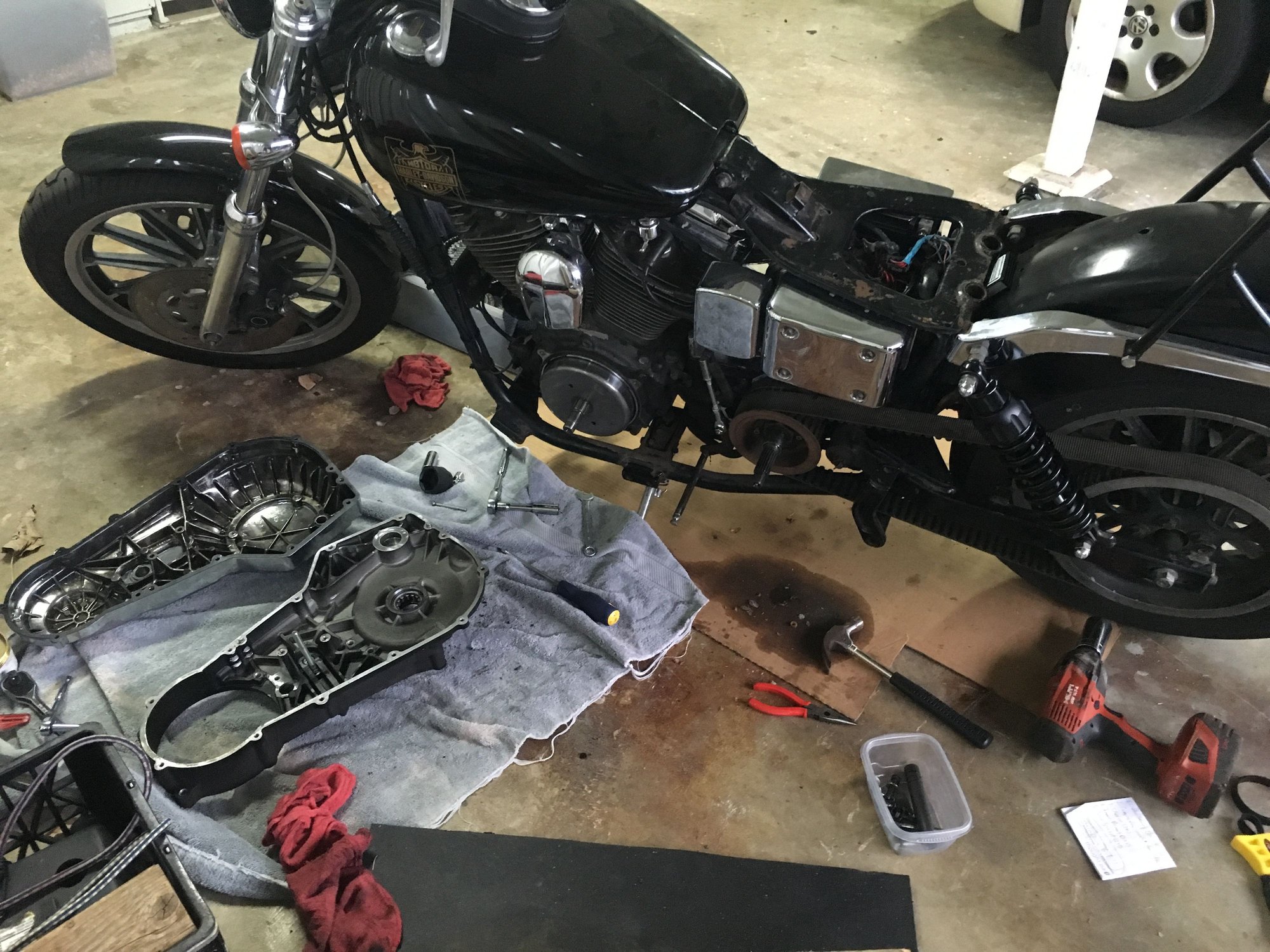

And we're in!
Originally Posted by cggorman
I didn't disassemble the clutch but it looks like it should be ready to slide off. The compensator, clutch, chain, amd tensioner all come off as one big assembly.
A second pair of hands may be helpful.
Make sure you have somewhere clean and stable to set it down.
It just slides over the splines but it's a very close fit. You can't have much misalignment of the sprockets or it will bind. If the clutch won't budge you might need to tap the starter ring gear a bit to break it loose. A lead or brass mallet would be best. Plastic otherwise. You don't want to mess up the gear teeth. Shouldn't take much at all.

Update:
Just got the special mainshaft socket from a friend so now I can take of the pulley and install the front sprocket.
I'm still waiting on the spacer for my rear sprocket to arrive from bungking. Ordered it on May 20th.

Youre not going really wide so it shouldnt be an issue on the sprocket end, but before you loctite and torque the sprocket, make double sure you've got all the alignments and clearances you need. I'd suggest test fitting the entire secondary drive with chain and inner primary and tire just to make sure.
Despite my upfront measurements, my first two attempts had interferences that required new or modified parts.

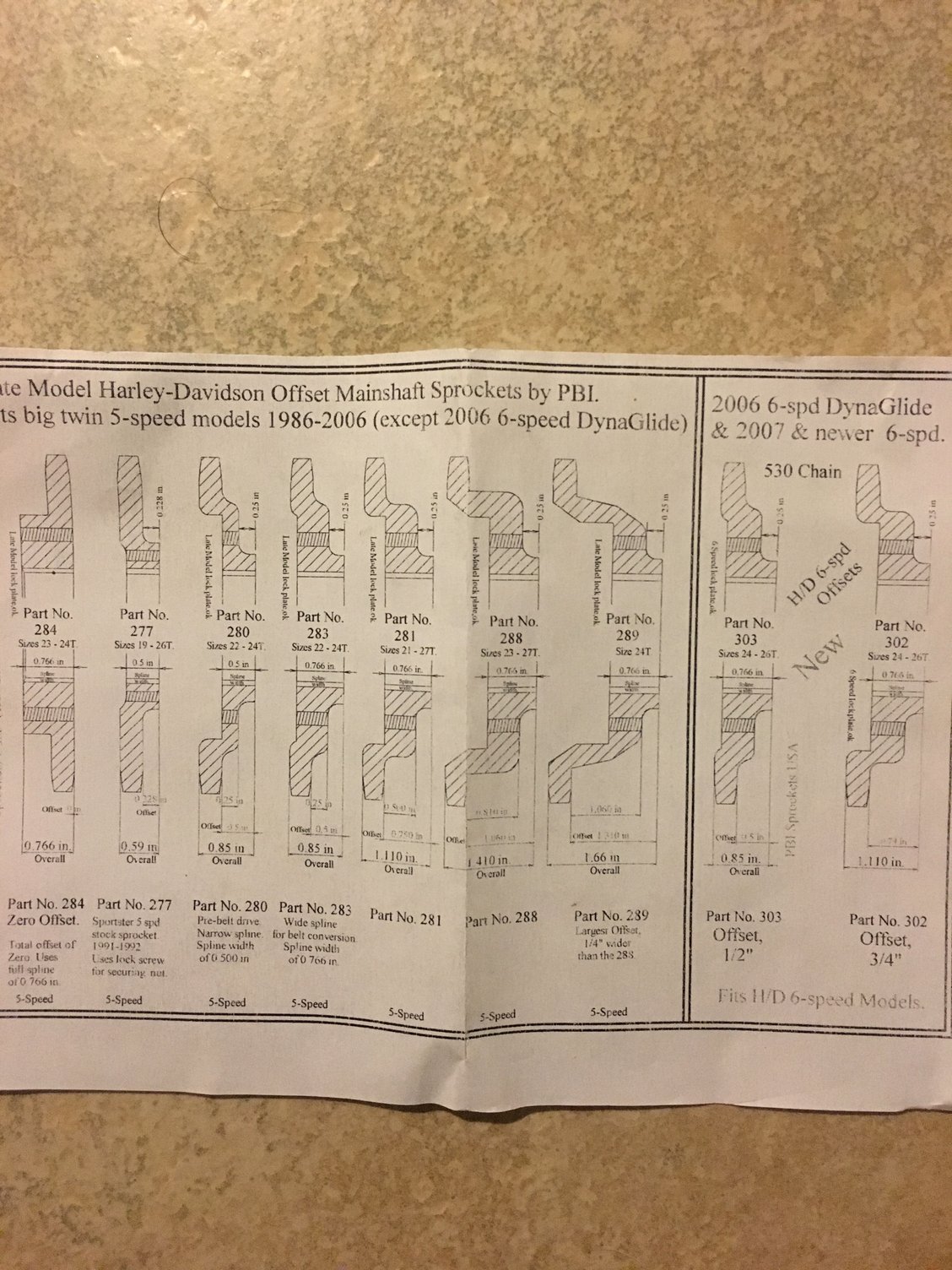

So I got the front pulley off and it looks like the inner diameter of the front sprocket I ordered is too small. I picked up the PBI 283-22 1/2" offset. Does anyone know which one is the correct one?
Old Jun 5, 2016 | 01:57 AM
  #130
cggorman's Avatar
cggorman
Posts: 11,448
Likes: 2,299
From: NW Ohio
I've got both a 288 and a 281. Both fit the output shaft splines properly. The 288 is on the bike, but I can measure the 281 tomorrow if you need.
Its a very, very close fit over the splines.
You do have the stock 5 speed right?
The 28x series will all have the same spline dimensions...other than the narrow width ones. They would still fit, but there would be less spline engagement.
