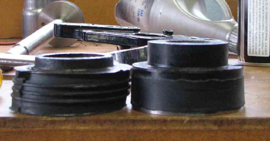

Originally Posted by CJD197
I still haven't seen any explanation of how the mount is put together. I don't see what is restricting horizontal motion in the pics. It looks like it allows movement in all axis...am I missing something?
The idea is that the rubber donuts do not crush but allow movement axially.. You have to look at them closely. They each use 3 sheet metal rings that keep the rubber from bulging out.. The rings essentially keep the rubber from compressing axially but allow the rubber too move radially..
Here is a pic of the rubber isolator. The one of the left is stock.. One on the right is a glide pro.. Notice the GP does not have the sheet metal rings..
While the BBC mount won't help my DX handling, I'm more interested in what it does for vibrations.. I'm getting tired motor vibes at certain RPMs.

From: Southlake Texas
I understand the washers limit side to side movement...but there is still rubber, right? It seems the movement may be restricted by the large rubber o-ring, but not "0" like the Sputh or TT. Those mounts have metal on metal which completely eliminate side to side motion. I am just not seeing what in the BBC mount is restricting side to side other than rubber. The OEM mounts use rubber to restrict, but not eliminate side motion.
