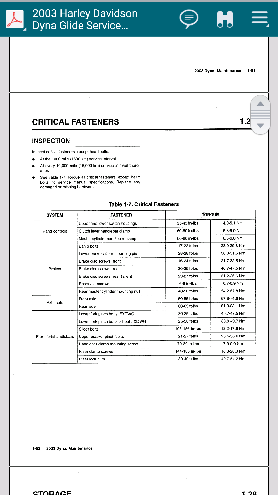

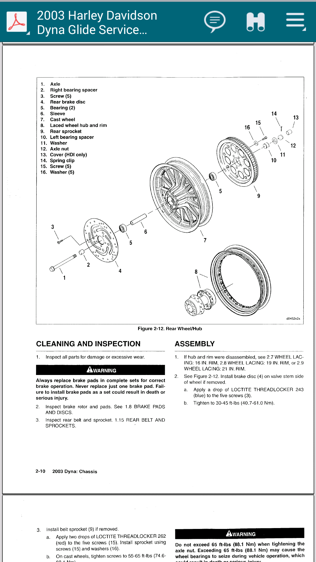

Am I right that I noticed in the procedure it mentions a max of 45 ft/lbs on the rear but the values in the critical fasteners list it says a max of 35 or if Allen's, 27...??
I'll have to check my manual for interest...
My critical fastener list just says 24 front and 45 rear..

After reading the page with the Critical Fastners and specificially the Brakes section. The Brake disc screws for the F = 16-24 ft-lbs and the R = 30-35 ft-lbs; and if Allen head, = 23-27 ft-lbs.
