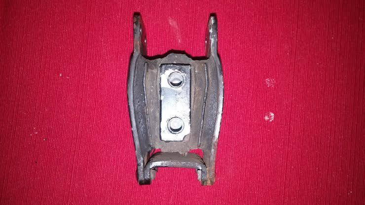

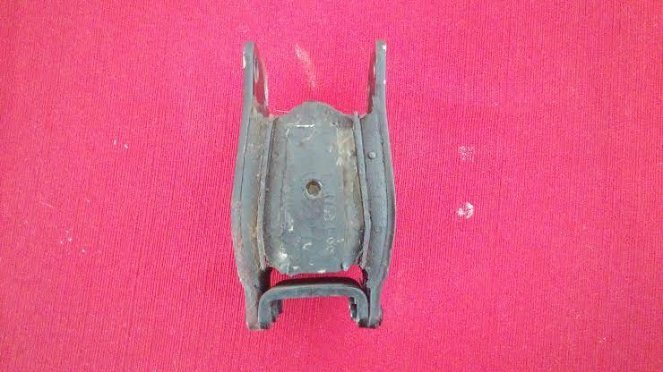

Thanks Stilup, I was gonna leave the rear alone after reading your reply but it just kept bugging. I had to know what the condition was so I decided to pull the rear to check it just in case. Here are some pictures of it, what do you guys think?

It looks ok to me, no obvious ripping etc. Unlike the fronts (which are a shamefully unreliable part) the rears do seem to be generally reliable.
While you've got it all apart, maybe think about getting a Sputhe Positrack stabiliser for the rear (he sells fronts and rears separately, while I inderstand TrueTrack only sells the set) to complement your VT front one.
Depending on replacement cost and how many miles you've got on the bike, I'd also be thinking about replacing the rear mount anyway, just because it's already out and on the workbench...

Thanks Davdoodles. It's funny you bring up the Sputhe stabilizer, I emailed them last night asking them how much just the rear is. Still not sure if I'm going to go that route though.
I found a thread on here with a member stating that when he did the VT front mount it was night and day but when he added the Sputhe rear stabilizer a few days later he felt no added benefit so I'm not sure it's worth the extra money. I'll see what they say about a price and go from there.
The more I look at this rear mount it looks like the metal frame is tweaked. Not sure if it's supposed to be that way from the factory or mine is just weird. There is also some really light cracking throughout the rubber. A new OE mount is about $75 plus shipping so it's not too bad.

It's already out...change it and forget about it for a few years. Or, leave it in and and wonder. I'd rather make it bullet proof and forget it than wonder if I should have changed it.
