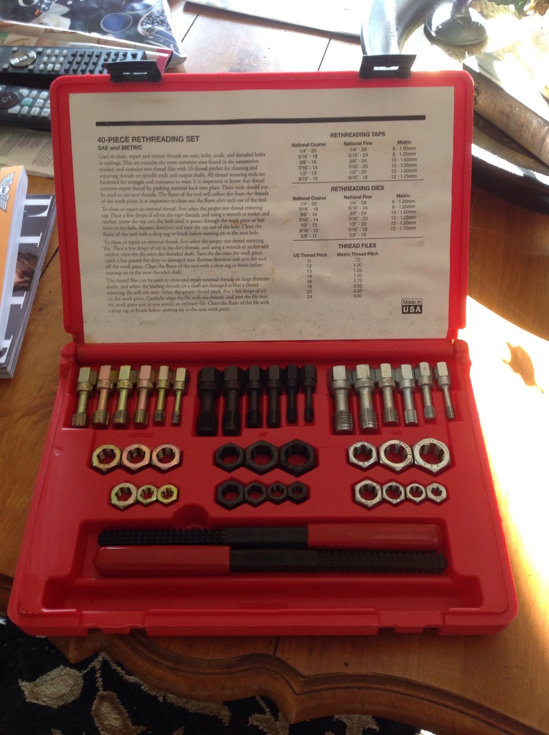

If you ever wanted to do the 30T mod, this is a good time. Also a good time to clean and lubricate your jiffy stand. Be sure to clean all your fastener holes and the reused fasteners - I got a Craftsman Rethreading Kit that works great:
