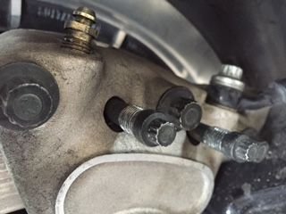

Trying to replace the rear pads on 2012 fatbob. I thought i had every socket made untill i could not find anything to fit the pin pad bolt. Looks like a star or torx but i have nothing that fits. Anyone know what the actuall size/type socket i need?

Not sure if all the years are the same but my 2003 FLHTCI is addressed with a 1/4" 12 point socket.

Yes a 12 point socket. Not something everyone has just laying around.

Thanks guys, the 12 point socket works great!
