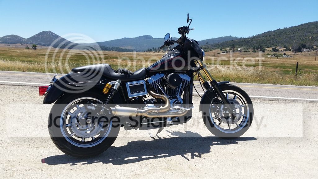

Well I won't even pretend to explain the details of suspension (because I'm not nearly qualified) but last year I found myself in a very similar experience to what you described and I can share what I learned so maybe it will help. Last summer I blew a fork seal so since I was going to have it all taken apart anyway I decided it was the perfect time to upgrade the front suspension. I looked around and ultimately went with Race Tech gold valve cartridge emulators and springs and 15 wt fork oil that I also ordered from them. It was a relatively inexpensive upgrade and the feedback about them was almost unanimously positive. Plus Race Tech was GREAT about returning calls and helping me narrow down the right setup for me. The result? Night and day difference. Can't say enough about the immediate improvement.
The improvement did highlight somewhat of a problem - albeit a good problem I guess. I also run 412's on my FXDF, and while they're an improvement over stock, once I dropped in the Race Techs up front the difference in quality from front to back was REALLY noticeable. For that reason I decided the next upgrade will be the Race Tech piggyback rear shocks, once I save up the money for them. So long story longer, I highly recommend the Race Techs up front but also saving up for a quality rear suspension if that's what you're looking for. Seems like you get what you pay for in that category and if it's worth it to you you won't regret dropping the extra dough. Hope that helps.
