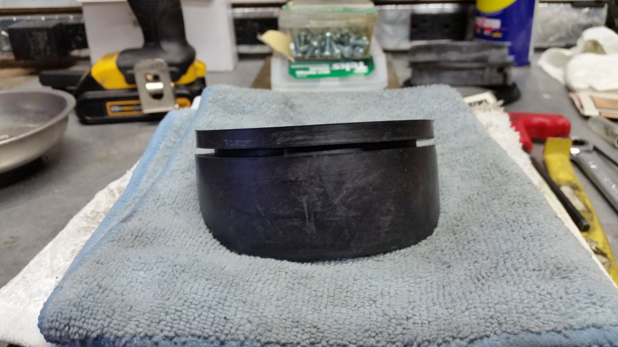

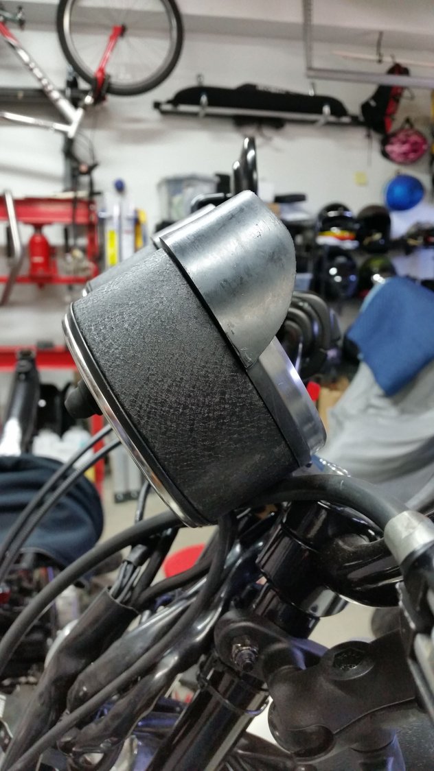

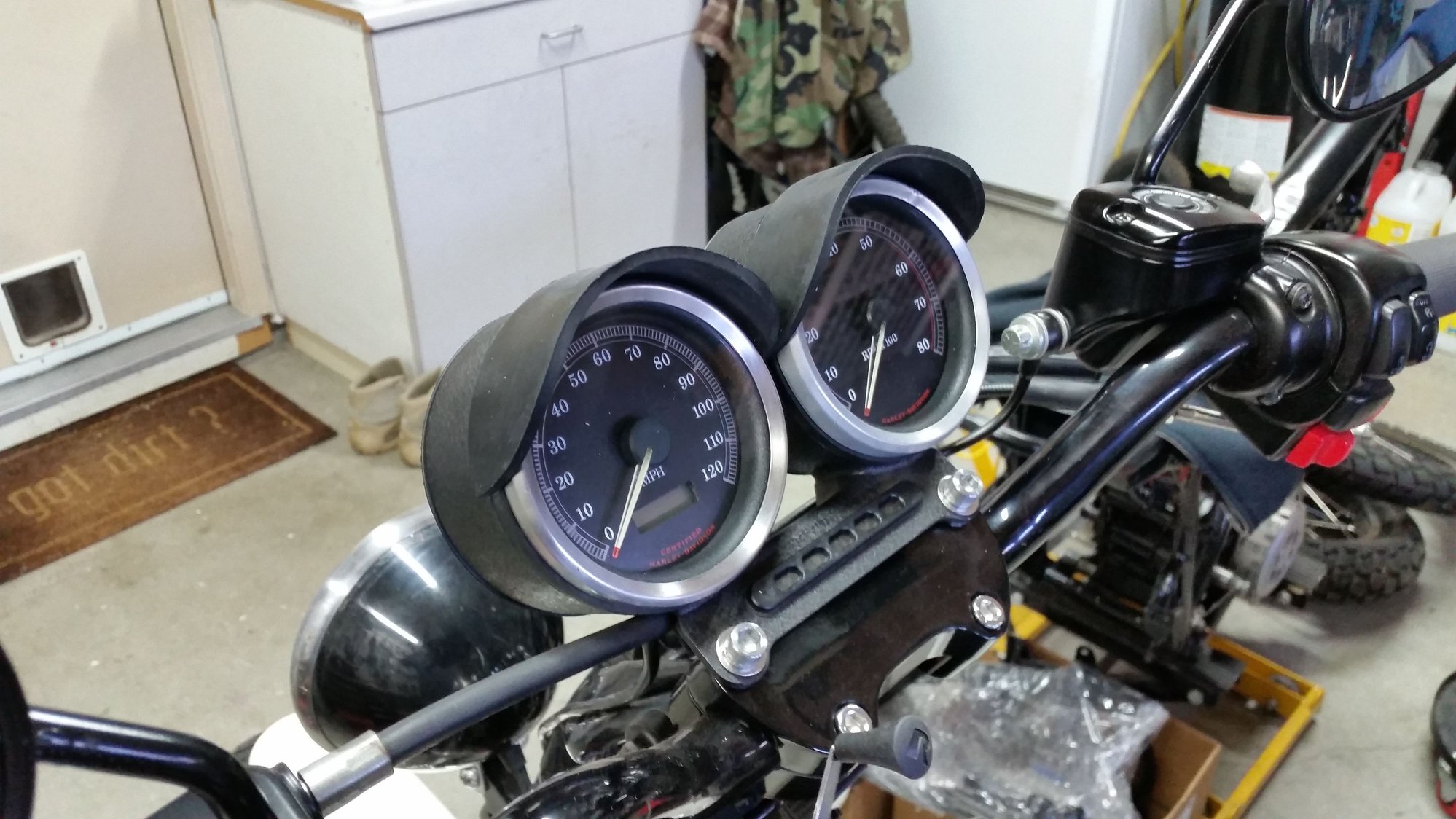

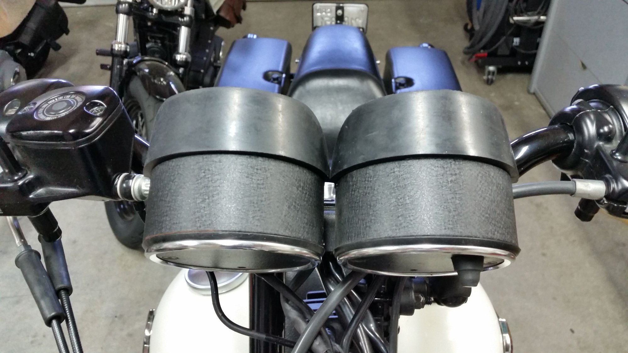

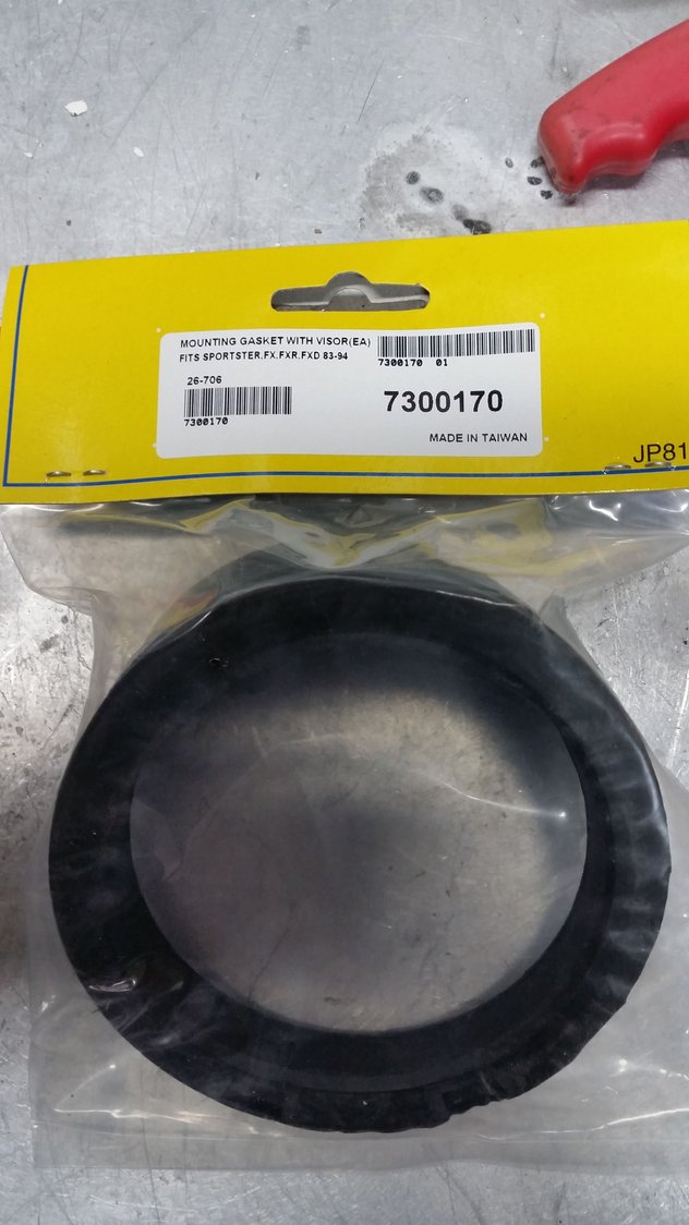

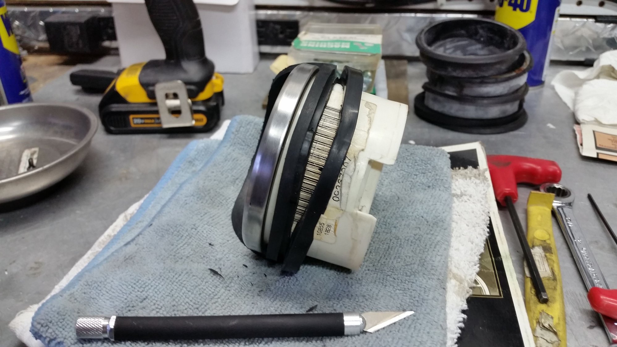

Small project while I had the front end tore apart for a stem bearing service. I like the look of the FXRP gauge visors and my gauges do catch a glare so....
The FXRP gauge is 3 1/2" and the Dyna is 3 3/8".The visors were cheap so I figured I would take a chance and see if they could be modified.
The visor has a double lip and is a bit thicker.
The visor fits fine but, the second lip must be removed to allow the gauge to slide into the housing.
Once the lip is removed there are two small raised areas that must trimmed flush.
The end product.
