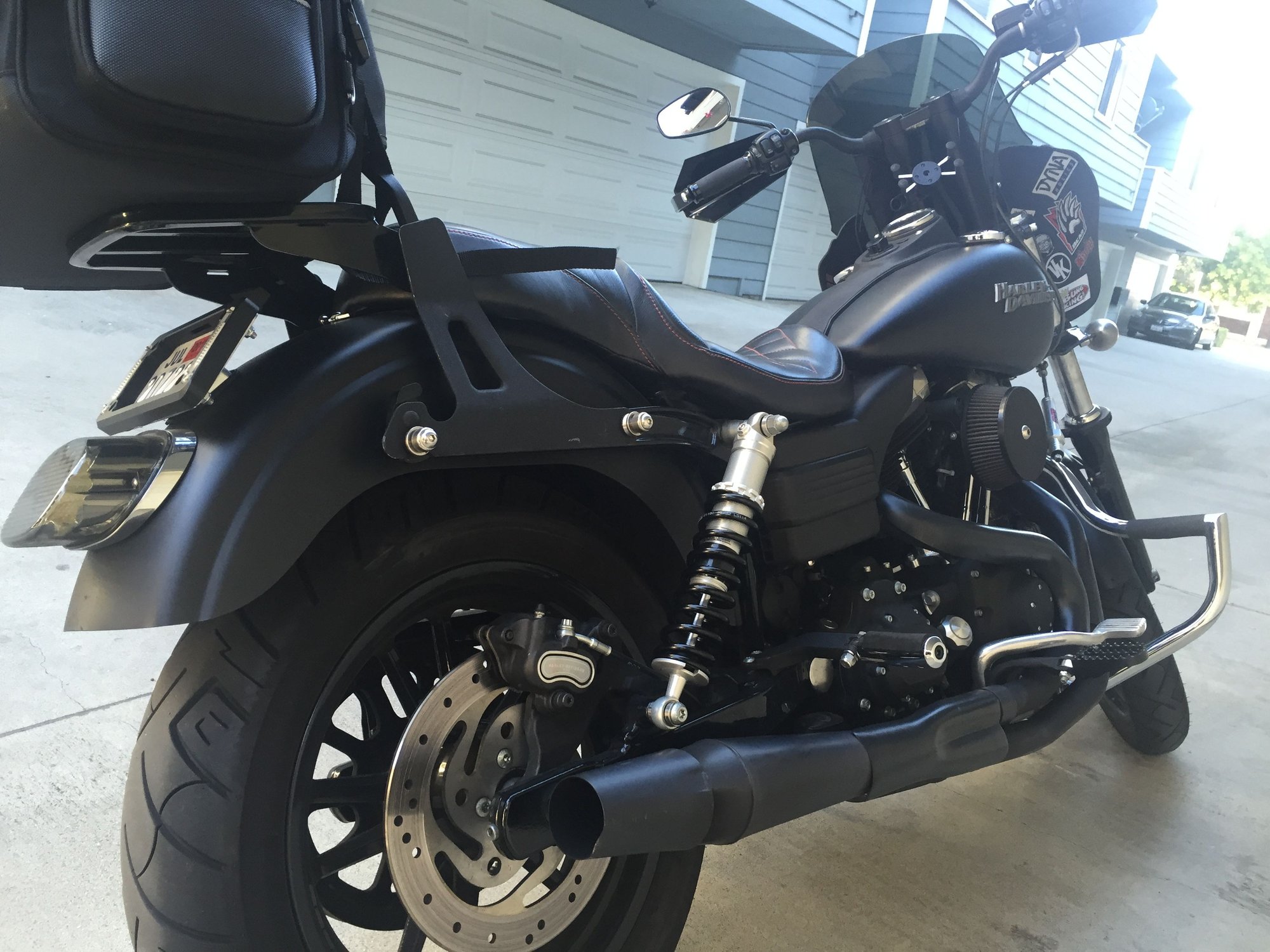

Switched from 12.5 Progressive 440 HD to 13 3/8 Ohlins, +2 fron forks. Love it so far. backing up is a b!#$ch though. And probably need to extend kick stand
You could always go with one of these. I put one on my FXR, works great! Mine had an extreme lean too, now it sits perfect.
