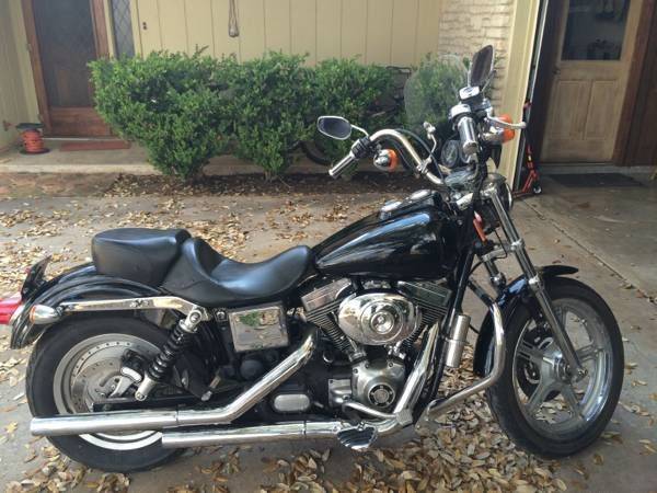

Okay, so I'm looking at this bike, the guy that's selling it, says it was his fathers. He doesn't ride it. He doesn't know what mods were made to it but he does know some. I would love to own this specific model though.
It's a 2003 Harley Dyna Super Glide Sport FXDX 14k miles only, that's good right?
100th anniversary Harley Davidson FXDX super glyde sport. Beautiful ,fast ,fun and loud Harley ..mini apes , Vance and Hines pipes ..detachable sissy bar. Runs great all the info he really has on it, clean title. He's only asking 5500, wish I had a professional to come help me and look at it to tell me if it's worth the buy since I don't know much. Thoughts?

First off, That's not an FXDX, it's an FXD (No dual disc and no adjustable forks)
If it is an FXDX, someone changed the front end out and some other stuff too.
It looks to me like the right mirror is different from the left mirror and the rocker boxes have been changed out.
Have someone look it over really well and make sure it hasn't been wrecked. (salvage title?)
If it hasn't been wrecked and the mileage is accurate, it's still a nice motorcycle and is worth the money in my honest opinion.

Hmmm, yeah. Well the VIN checks out, says FXDX. Guess a lot of changes were made. Also, missed the part where he said it has a new front end but listed that as an upgrade that was done? Says clean title. I'll see what I can do, have to travel out an hour and a half to see it.

Go see it, but there have been a lot of changes made to that bike from what I can see.
It might say "clean title" in the ad but I'd be very curious about some of the strange changes to that bike.
I of all people understand the concept of completely changing a bike to suit your own needs (mine used to be an FXDWG and now it's more of an FXDX) but the mismatched engine covers and mirrors and the low rider front end just make me wonder what's really going on with that bike.

I have the 2003 fxdxt. Compared to this... nothing is the same... I'd bet money that the thing was crashed pretty good and everything replaced with cheap parts. Get a 250

Don't waste your time, this bike had "bad" written all over it.

That front end is not an "upgade" by any definition of the word...
The FXDX came with the best adjustable/dual disc front end ever put on a big twin and this guy replaced it with a hacked up single disc lowered front end. (piece of ****)
