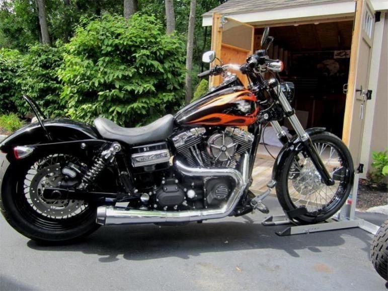

Originally Posted by WMX124
I ordered the Bassani 13112J from Direct Cycle. Best price and free shipping. I picked this pipe because it's stepped and provides the best clearance. Huge improvement over the big radius 2-2 I had on before. See sig for picture.
+1 on the 13112j
