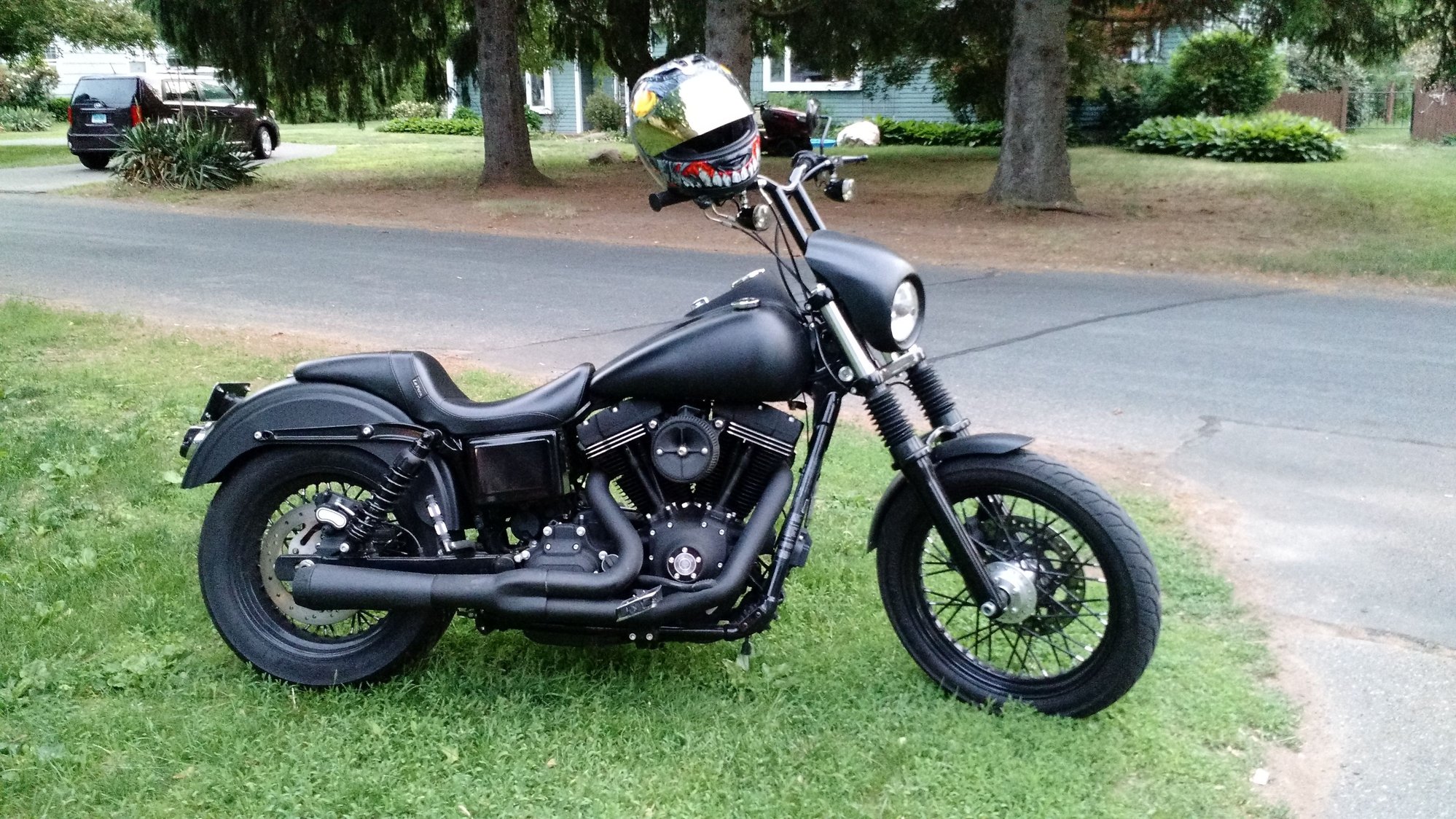

Originally Posted by mmeist
12" WCTB Slingshots
Zippers Performance chain conversion
12.5" progressive 444 shocks
le pera seat
s&s intake
bassani road rage
fuel controller
adding the following over the winter;
P&P Heads+ re-honed cylinders
topline fork tubes
progressive heavy duty fork springs
speed merchant fork adjusters
barnet low profile lock up clutch
works tracker 13.5"shocks
big bear choppers dyna motor mount
GLOSS BLACK PAINT
Old Nov 16, 2015 | 08:19 AM
  #38
mmeist's Avatar
mmeist
6th Gear
Joined: Sep 2014
Posts: 11
From: CT

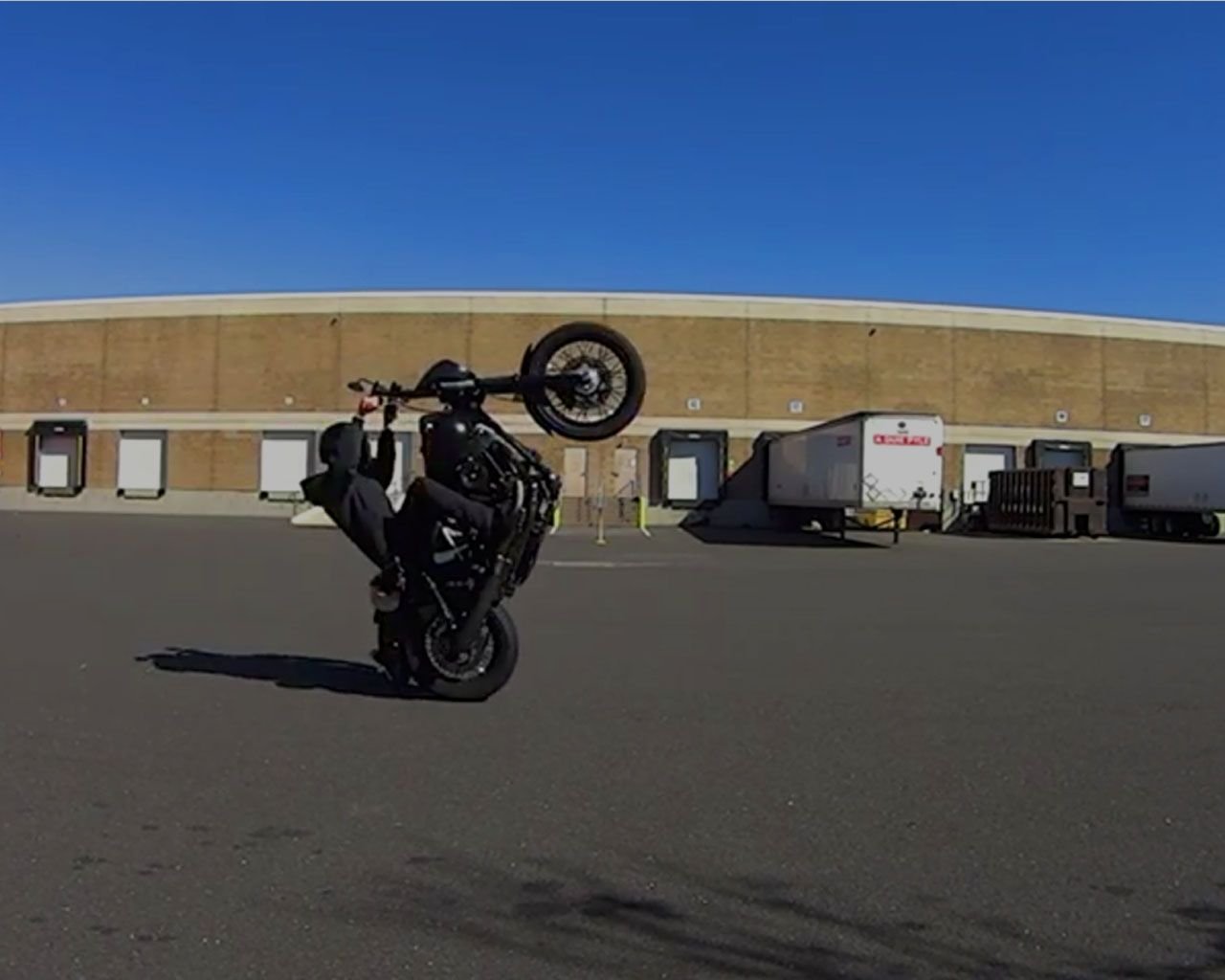

Originally Posted by YammyDrummer
Thanks for the feedback. I'm hoping we have good weather next weekend. I'll have more time than I did today, and will mess around with clutch control more vs just dumping it.
try a michelin commander 2. I had a hard time hooking up also (i weigh 145lbs) After I swapped out my pirelli night dragon it hooked up everywhere, no more drifting though
Old Nov 16, 2015 | 02:19 PM
  #39
fxdlx's Avatar
fxdlx
Joined: Jun 2013
Posts: 1,181
Likes: 98
From: north of the south pole
Nice form there mmeist.
