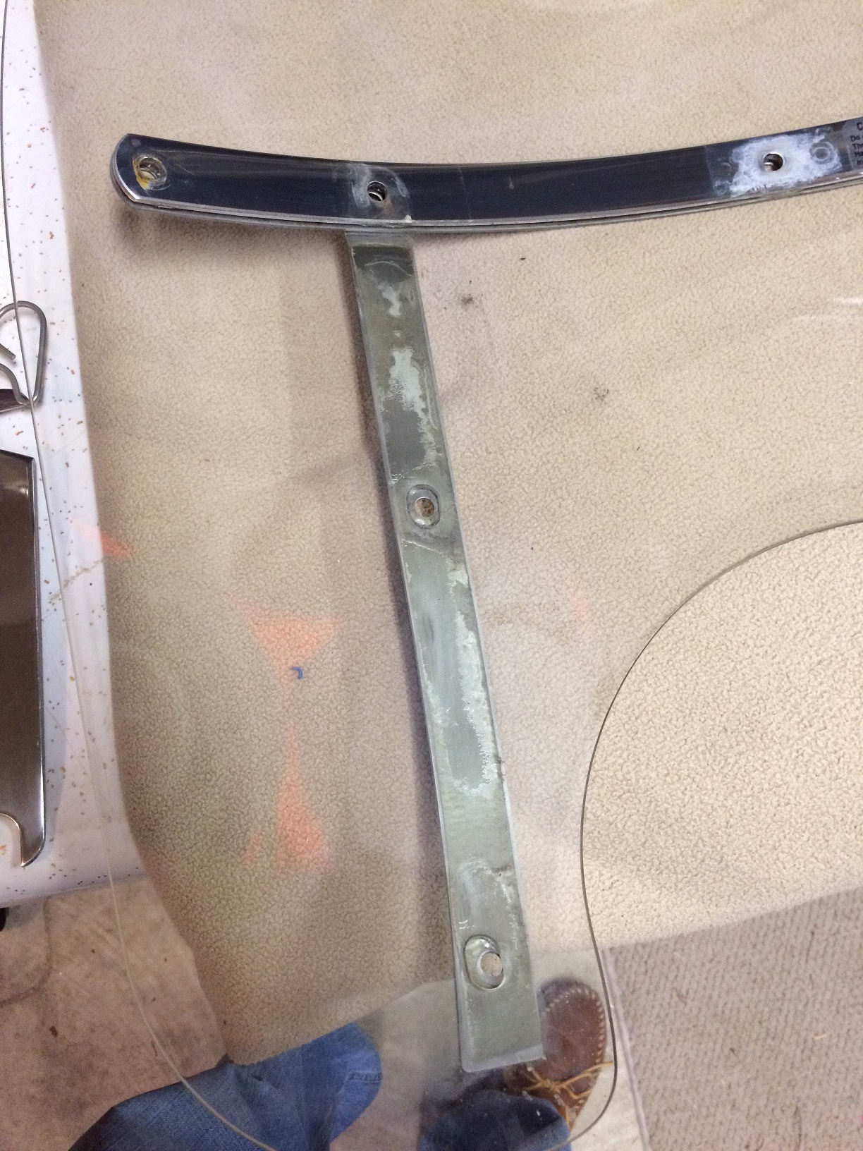

The metal pieces will pop off without that much prying. Use a stiff piece of plastic if you dont want to scratch the (pos) stock shield, which IMO is only worth using as a small dog sled. Seriously dont worry about trying to save it or sell it...they are garbage.
Originally Posted by crabio
Hey guys I'm curious. I have my CV scheduled to be delivered in the next day or two so I'm out taking all the mounting hardware off the OEM shield (in preparation) and was wondering if there was a trick to detach the chrome pieces from the shield itself.
I took out all the chrome nuts and bolts thinking that the chrome pieces would just come off but it looks like the OEM shield is glued to the chrome pieces as well.
I don't wanna mess up the OEM shield but man that glue is some powerful stuff!
Any ideas?

Thanks for the advice guys. Slow and steady did the trick. Used a small piece of plastic as suggested and slowly but surely they started to separate.
I found a trick to getting all that residue off the pieces too. A sink full of hot soapy water ... soaked for about 15 minutes and that stuff just peeled right off.
