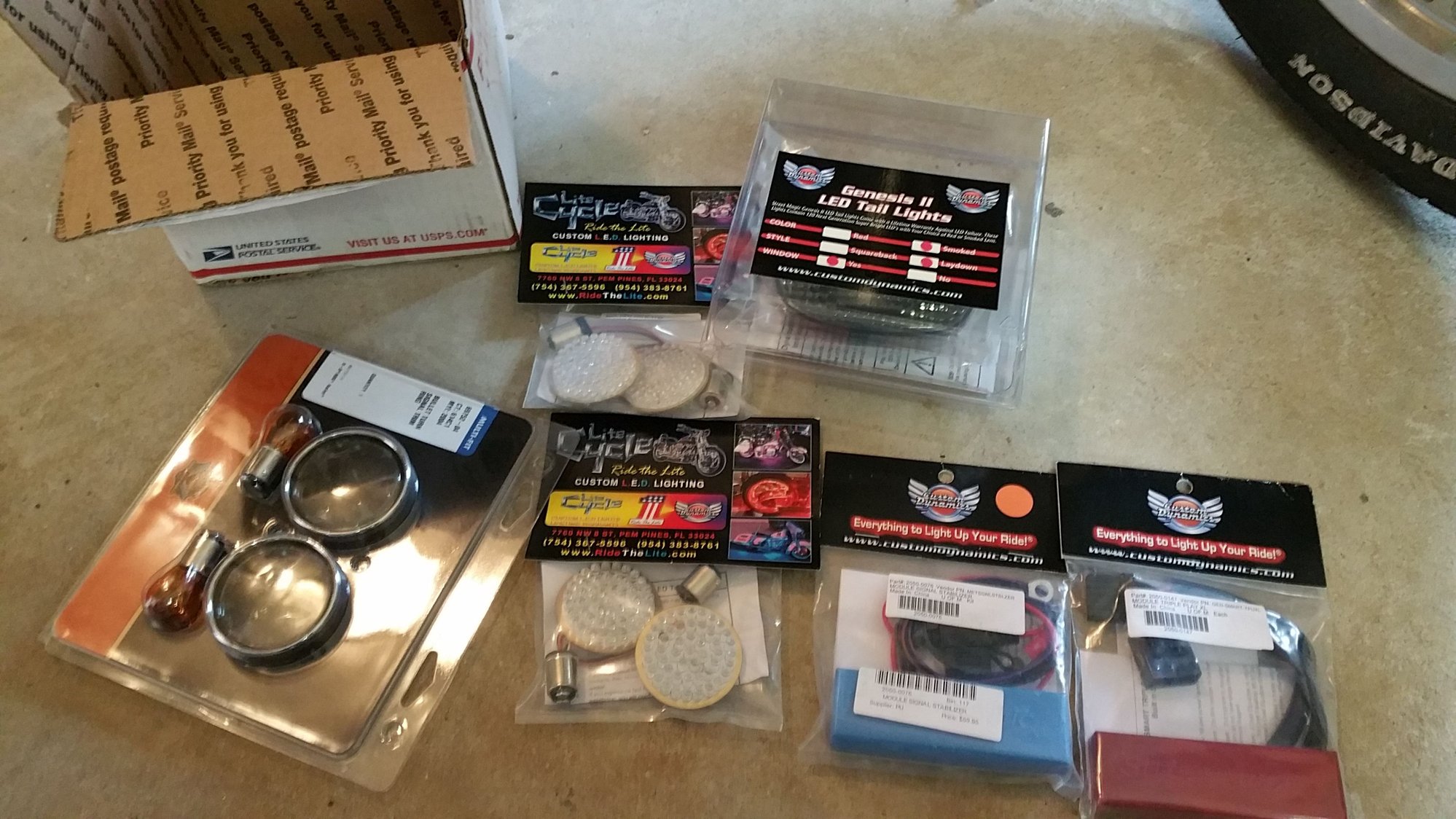

I went with this setup on my 09 Super Glide Custom and it works nicely:
*Integrated Genesis II Laydown Smoked No Window Tail Light GEN2I-LD-S $149.95
*Radius Black Horizontal LED License Plate *Frame Low Profile LPF-RAD-B-LP $48.57
*Posi-Tap Quick Connects PTA2022 (pack of 4) $3.57
*Slim Line Signal Stabilizer GEN-HD-STABILIZER $64.95
This set up has no window (for tag) because the tag frame is lighted above, works great. The brake light has integrated turn signals.
Good luck!

I'm so glad I hopped on here before going through the headache of calling CD. I have my turn signals integrated into the tail light as well and when I hit the signal it just lights up and doesn't flash. I'll be looking into the signal stabilizer for mine.
