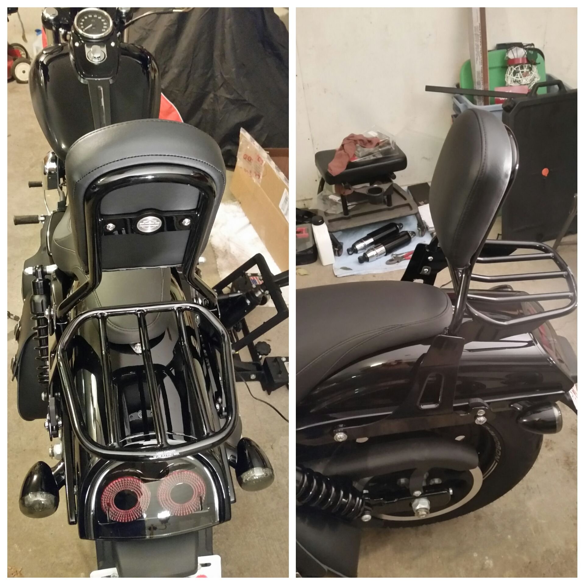

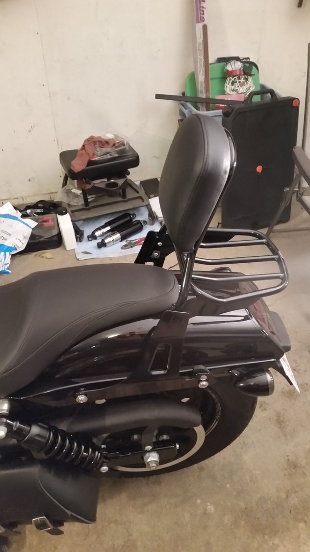

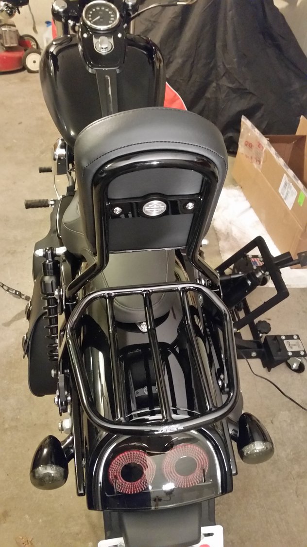

Well... it fits and works! Haha that's always a good sign!

Yep that's exactly what its for, the detachable sissy bar. You basically take out the bolts that hold the bar to the side plates, slide this rack between them and use the longer bolts that come with the rack. Little red loc tite and torque to 8-10 ft lbs and you're set!

Tapered Sport Luggage Rack
54049-10

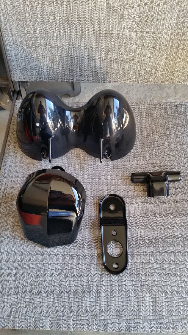

So I got a little bored this weekend and took some stuff off the bike that needed MOAR black! Got the headlight bucket, horn cover and brackets powder coated.
I also ordered a black daymaker and 1" riser extensions but those arent in yet

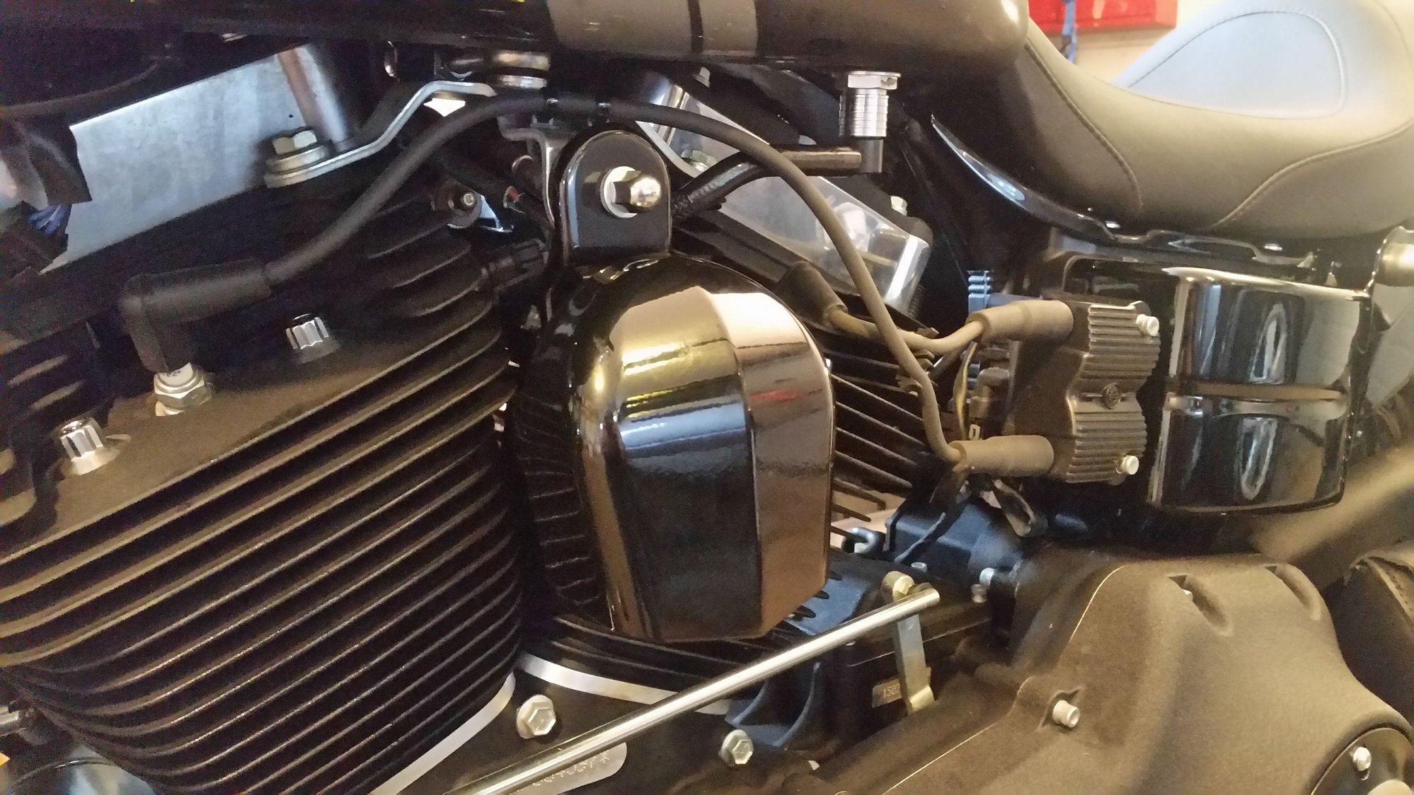

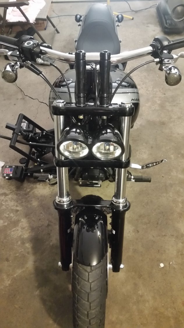

I made a little progress on the bike.
Installed the black horn cover / bracket
1" riser extensions from DK
Black headlight bucket and bracket.
Unfortunately it turns out that I have a non US bucket so my daymaker didnt work out. I swapped in some sylvania silverstar ultras instead
