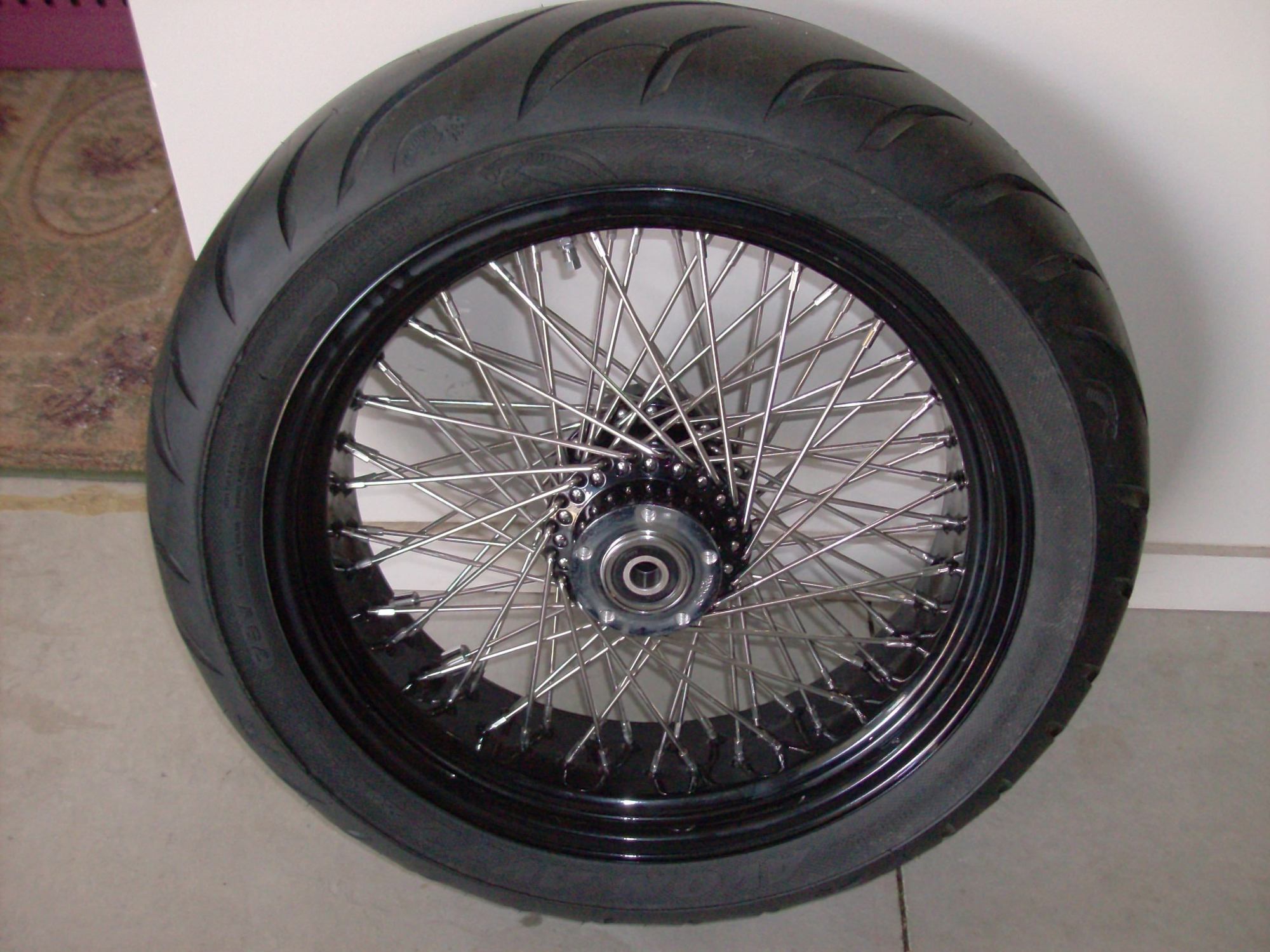

My rear is a DNA and front is Ride Wright.They look identical. Tubed no leaks.But,if i didn't get such a good deal on the rear wheel/tire combo i would have gone Ride Wright just for a piece of mind. I can't blame you for wanting to get rid of those weak looking 40 spokers that HD uses (cost) but,IMOP the fat spokers look better on a full fendered old school looking bike. Make sense?
If it were me I would (and did) go with a 60 or 80 stainless spoke wheel. I dunno that fat spoke on the wrong bike can have that "south of the border" look to me.
This is an 80 on an 18'
