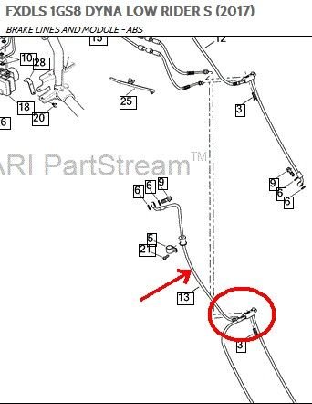

I'm also a bit confused as to why people claim the brake lines from the junction on the tree to the ABS unit have to be changed when swapping the others. They say it's for ABS function, but I would like to know the real reasoning behind it, as based on my experience, it seems like an old wives tale.
If I'm understanding your question...
The junction "B" is an assembly...the upper and lower Brake lines don't unscrew.
So if you need a longer upper line "A" (which is part of the assy), then you need replace the other parts of the assy.

A and B don't separate, I get that, but I'm being told by the local dealer, other members, and other people in general that the lines that run from "B" to the ABS module MUST be replaced as well for the ABS to function. If they unscrew from the junction, then why replace them, other than increasing profit margins for the dealer or aftermarket in selling the additional lines and labor.
That's what I'm not understanding, but I understand how it is assembled. I'm not looking to cheap out on this, but I don't like to replace parts that aren't necessary.
I didn't replace the lines that run back to the abs module and my abs still works just fine. I have the LD 11" lucky 13s and did NOT need to extend any wiring (have fun pulling em through lol). Bleed the brakes really well, you won't have any issues. I'm also running the following for brake and clutch (+6 Fat bob brake line, +4 Fat bob clutch line)
Correct, you don't need to replace the junction-to-ABS module lines. They unscrew.
Exactly the bars I just ordered for my FXDLS.
There's a lot of conflicting info on this forum when it comes to installing bars, and since there are a few differences with the FXDLS vs. the other Dynas maybe you could give some simple pointers?
Did you need to extend the wiring? If so, what method did you use?
What was your choice for the clutch cable? Why? How much longer than stock?
What was your choice for the brake lines? Why? How much longer than stock?
I've had people tell me you don't need to run wiring extensions, others say it's mandatory.
Yours looks great, so I know I will love the look of mine when it's done. Too bad it's going to be 6 weeks before they ship my bars.
There is enough wiring for 16" bars I would say, so no need to extend wiring. For the clutch cable I went with 66" Drag Specialties part # 0652-1428, that's 6" longer than the stock cable. For brake line I went with Drag Specialties ABS +6 part # 1741-3828. You will need to replace the stock brake line because it is one piece and you cannot just add an upper longer section. The job, specially wiring the throttle side, was very time consuming so take your time and analyze every move before breaking something. Good luck and feel free to ask!
