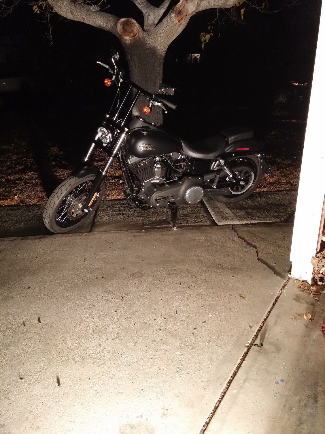

Old Jan 18, 2016 | 07:10 PM
Hephaestus's Avatar
Hephaestus
Joined: Dec 2015
Posts: 656
Likes: 59
From: MT. Olympus
Lookin good. Was the stock harness long enough with those bars?
Old Jan 18, 2016 | 08:19 PM
Celphish's Avatar
Celphish
Joined: Jun 2015
Posts: 36
From: Los Angeles
Yes, there was definitely more than enough length on the harness.
