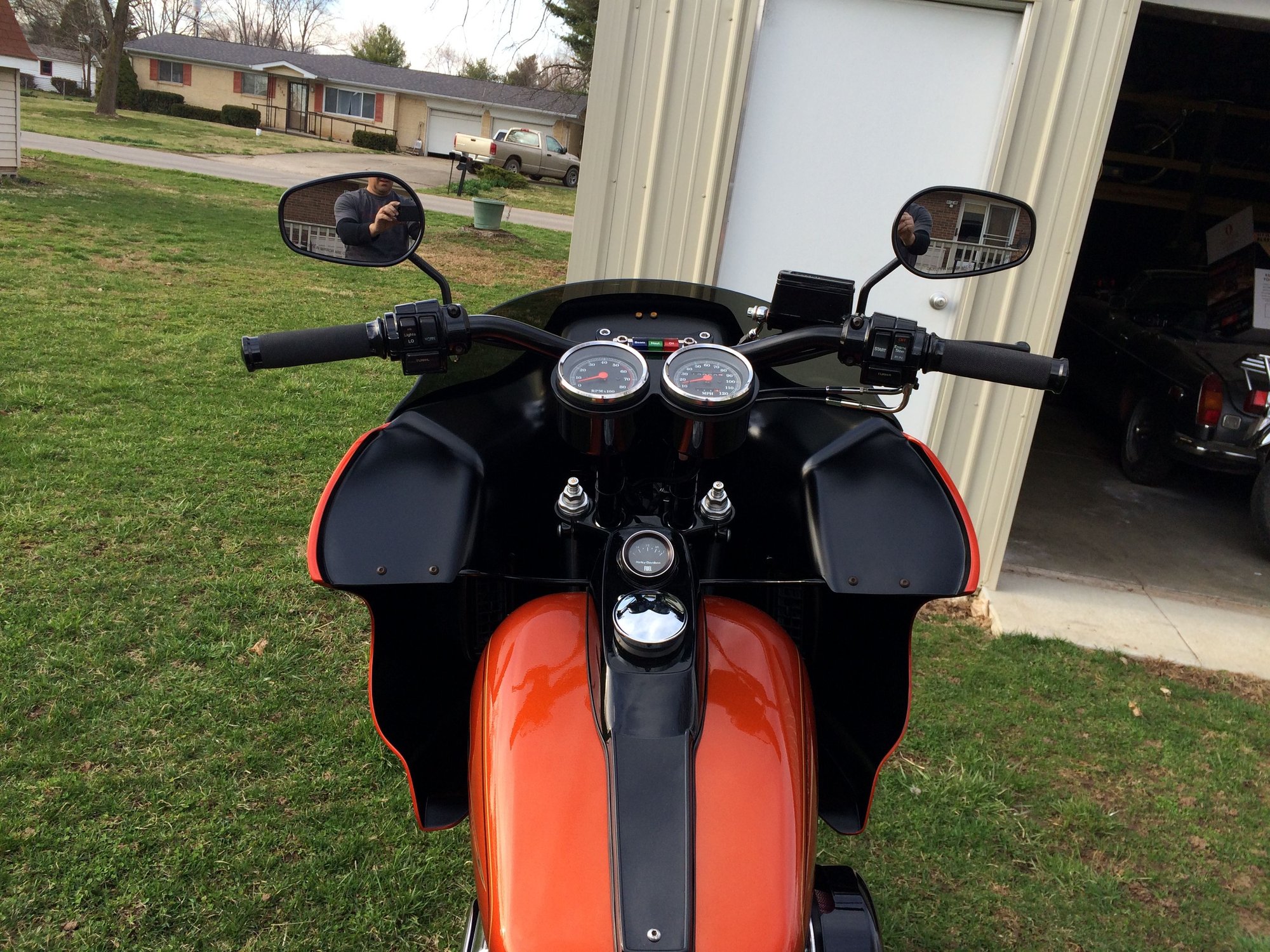

I hadn't heard of Tol Designs and had to goggle them. From the pictures on their website it doesn't appear that the lower mounts are used. They aren't showing mounting holes but then again they aren't showing mounting holes for the windscreen either. Have you contacted them? Here's a picture of my 85 FXRC. If I can help in anyway contact me.
Jim

My fairing is from a 84' FXRT and yes all three mounts are necessary. Please keep us posted on your progress.
Jim

That one is too sweet.
Nice how the stock FXR Superglide seat goes well along with the FXRT fairing!
Remembers me on the `84 FLH Shovelhead that i bought in `86.
I removed the King and Queen seat from it and used a stock Shovelhead Wide Glide seat, removed some foam on the driver seat section to lower it and it worked out well.
I have stored four seats now all together for the FXR and the Superglide seat is one of them.
