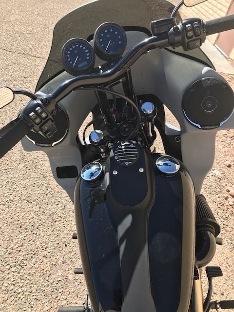

At the risk of this becoming my own personal thread, I figured I'd say thanks for all the info. Finally got mine painted and mounted. Now its time to ride.

Turned out good, well done!

Just got my fairing mounted and next up is the lowers. It’s running the 8” Clearview which JD sent because of the bars I am running. 8” risers and sportster sport bars. They are narrower and need the shorter shield. The wind management is very good and I have no buffeting. Just clean air around the helmet. The mounting bracket on this kit is the best I have seen. It comes with a billet neck clamp and a steel bracket that bolts to the clamp. Very sturdy.
