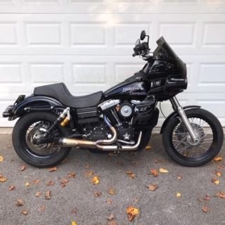

Here is a JD Setup

Originally Posted by jehu2010
Here is a JD Setup
sexual
