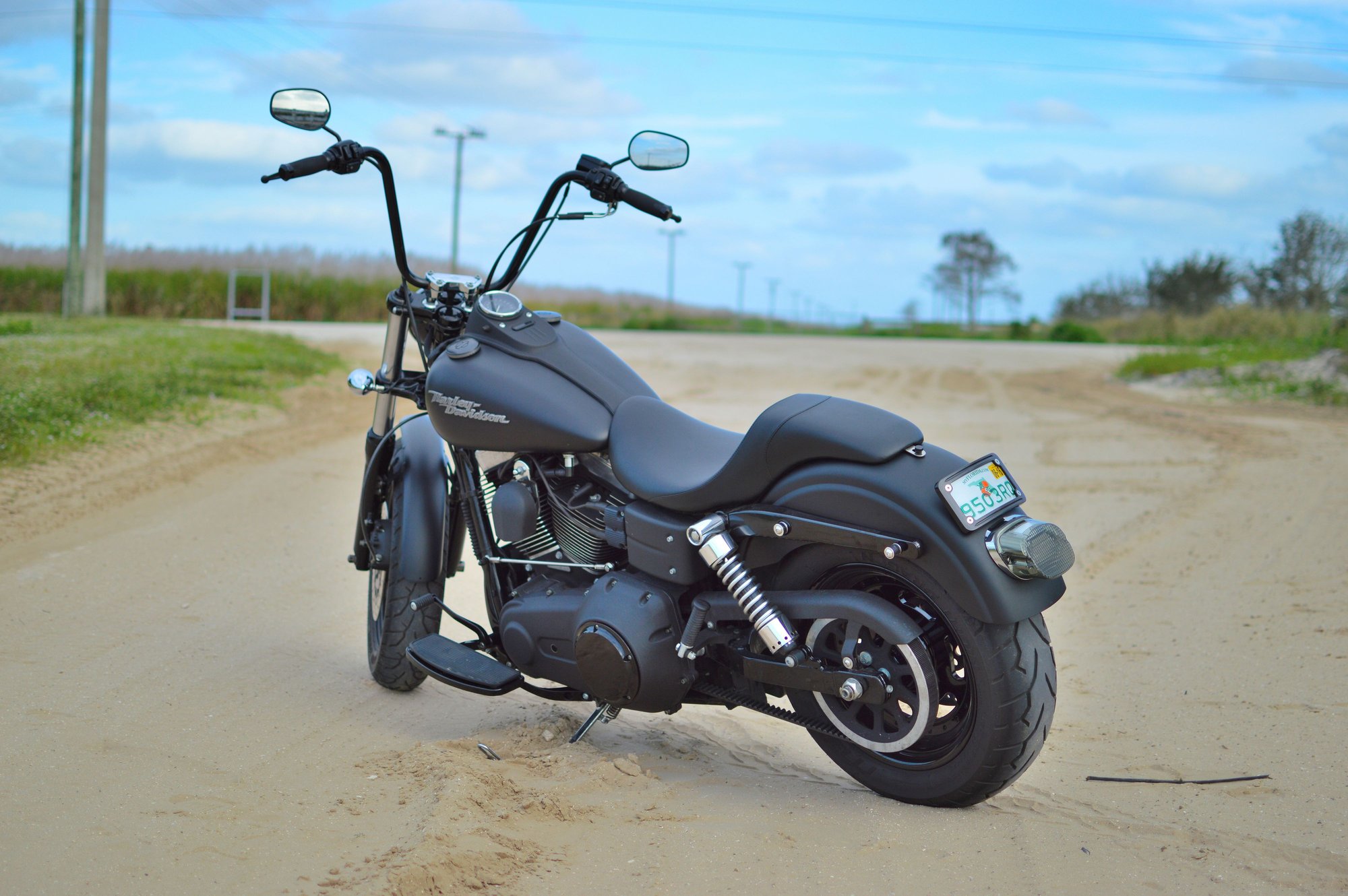

What rear fender did you use? And seat?
Very cool!!

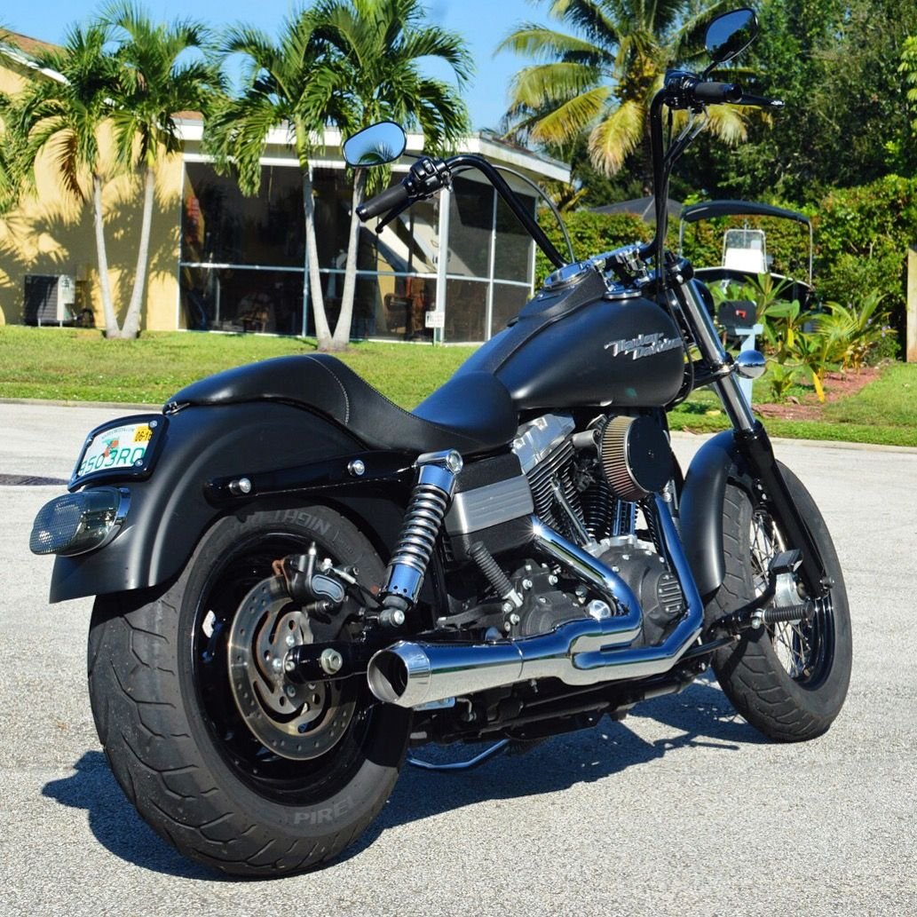

I ran that rear set-up on my 2007 FXDB.
2008 FXDF rear wheel with a 16x3 hoop laced to my stock front hub. Swing arms are the same so I swapped my '07 axle, spacers, caliper for the newer '08 version. You will need the newer two piece rear caliper for the smaller 16" wheel. The 2007 one piece caliper/bracket is a nightmare with the smaller wheel.

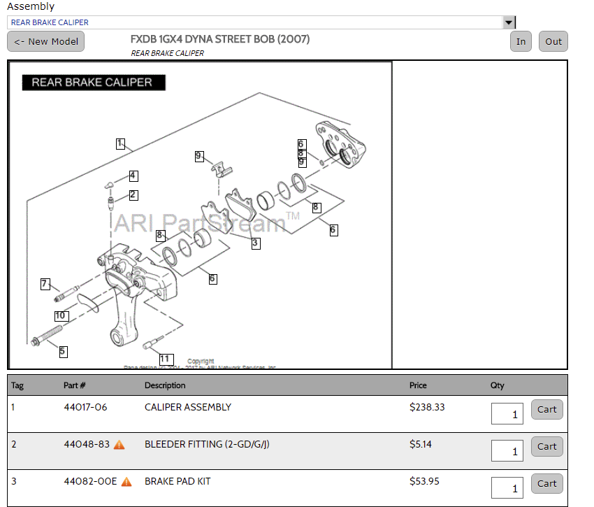

Originally Posted by blueangel73
Do you have the part number of or know what model the two piece caliper came from. I installed a 16"x5" rim in the rear and using the stock rear caliper from my 2010 Street Bob was a PITA to get all together. If I can simplify this process when I do my next tire change that would be awesome.
you have a 2010, (according to your sig), so you already have the two part caliper/mount(the 2008+ part), unless you changed something:
http://shop.outpostalaska.com/OEMpar...R_BRAKE_CALIPE
i think he's talking about the getting rid of the old style (2006-2008 w/1" axle) he had:
