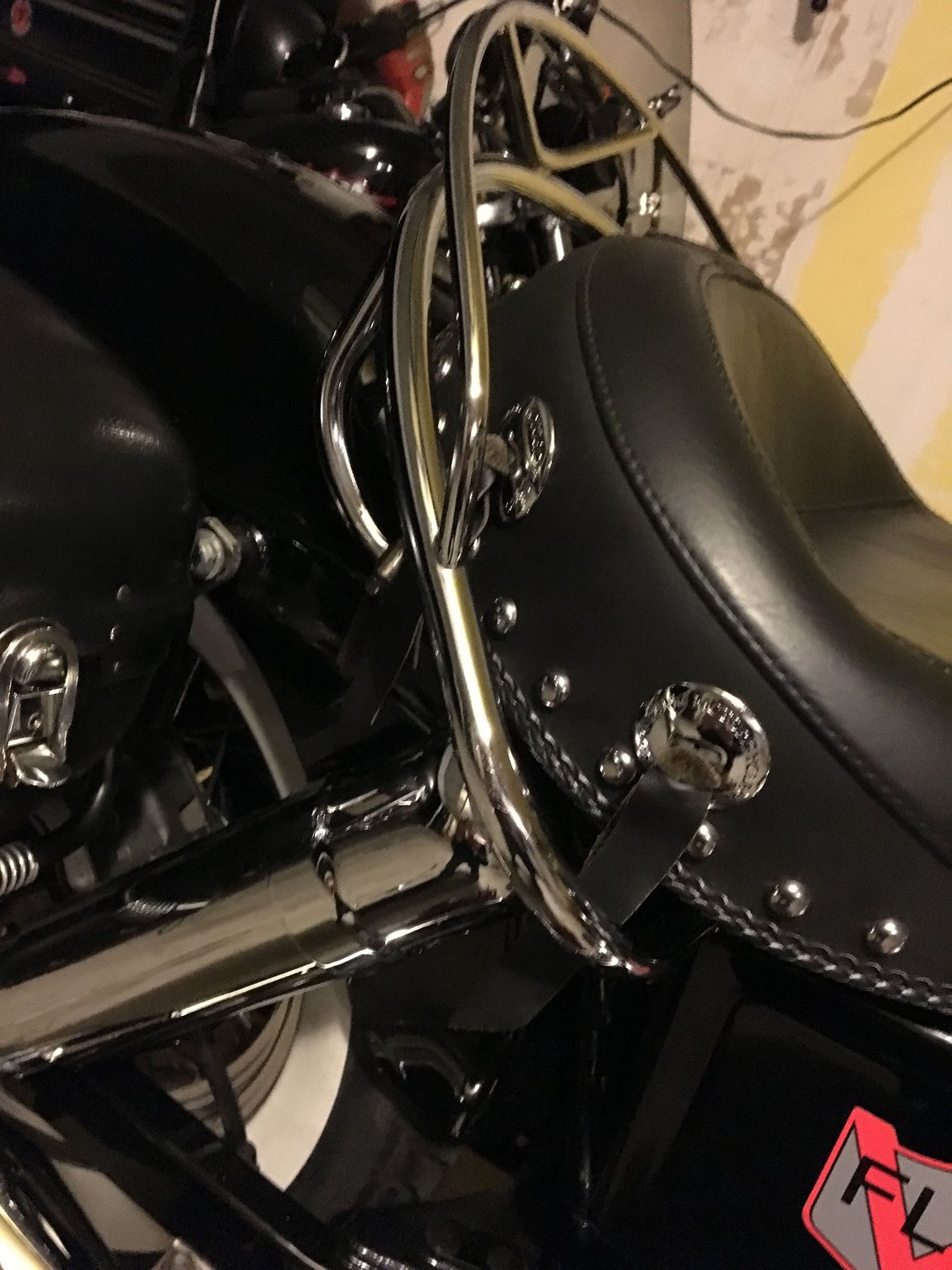

Thanks Joe-Seats a Mustang vintage solo wide. That grab rail is from JP cycles for the old 30's tractor seat or old 50's-60's buddy seat. Had to do some "massaging" of the rail but got it to bolt to the frame under the seat with stock frame bolts. The seat comes off and the grab rail stays bolted in tight-you could pick the bike up from that rail-I think It's on solid.
