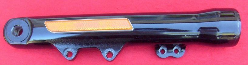

As mentioned, FXDF sliders have their fender mount bosses in a different location with different hole spacing. People hack their way through that, but how's your OCD going to deal with that?
In addition you really wouldn't want to then add a Left-side FXDF slider after the right-side because it's a wide-glide slider with caliper mounts moved more inboard than your mid-glide sliders. But people hack through that when putting them on mid-glides by milling the calipers themselves.
You might want to go with one of the other solutions
REFERENCE Photo Below
ON LEFT: FXDF Right-side Tube/Slider ...ON RIGHT: Other Dynas Left-side Tube/Slider
ON LEFT: FXDF Right-side Tube/Slider ...ON RIGHT: All other Dynas Left-side Tube/Slider
Really good points. I would think the new LR leg would be the cheapest/ easiest way, if the finish is somehow different then powder coat both legs... What do I know... I got the unpainted leg and it looked identical to what my legs looked like before I powder coated them. If he means the right LR leg is different other then just the finish I don't see how, I'm pretty sure the LR uses the same exact left leg that's on his bike now....

Yes, the introduction of the Dual disc on a Mid-glide in 2014 really was long overdue and offered a great solution for single disc owners.
I'm not sure what difference he was referring to unless it was slight casting differences at the caliper mounting area. I think they changed in 2013.
Maybe you can see the differences below
OLDER
NEWER
