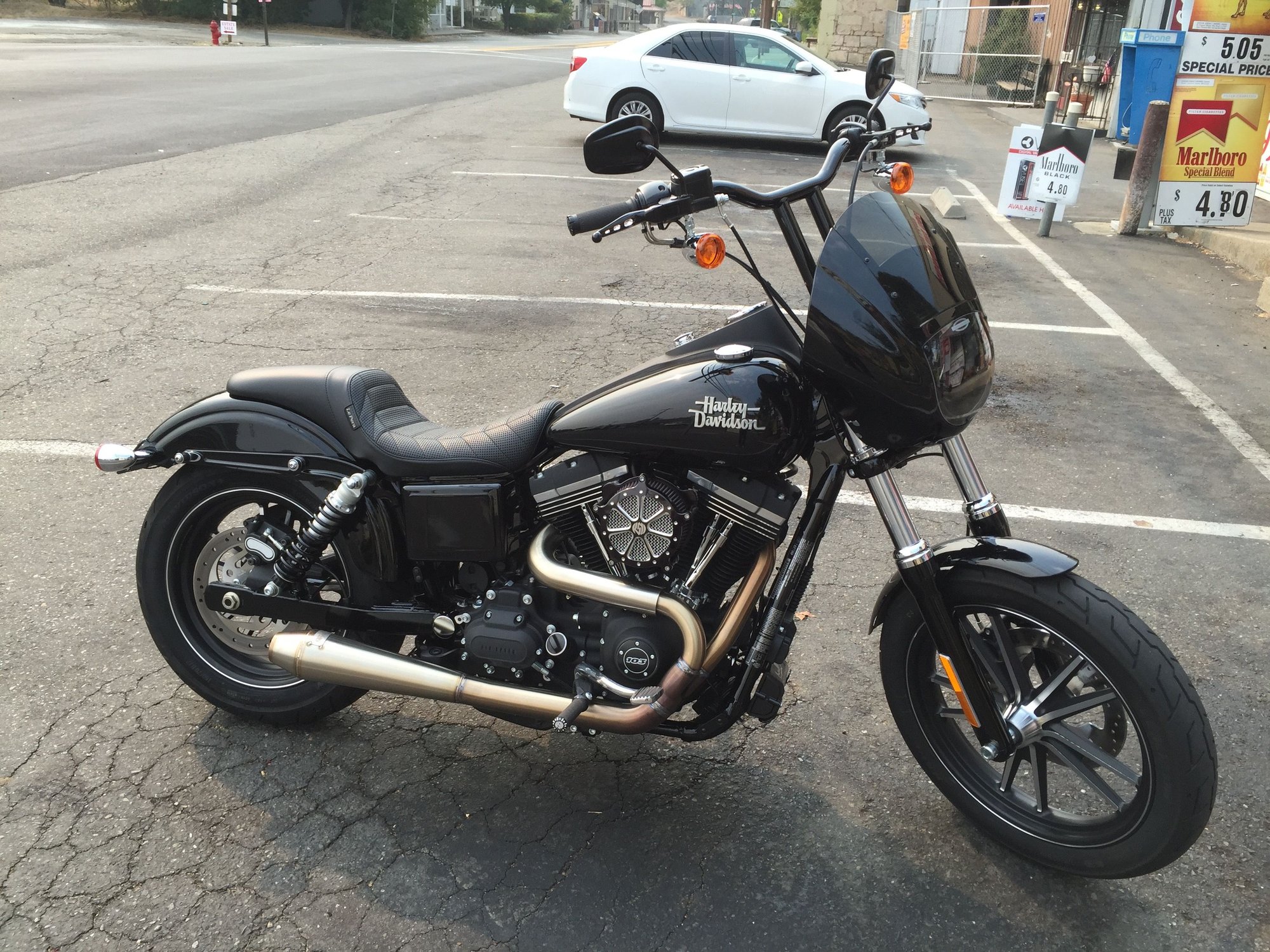

I scored myself a set of Switchback side plates(like pictured) I'm gonna use for my SB.

Wow that looks slick you thinking it will fill fit
