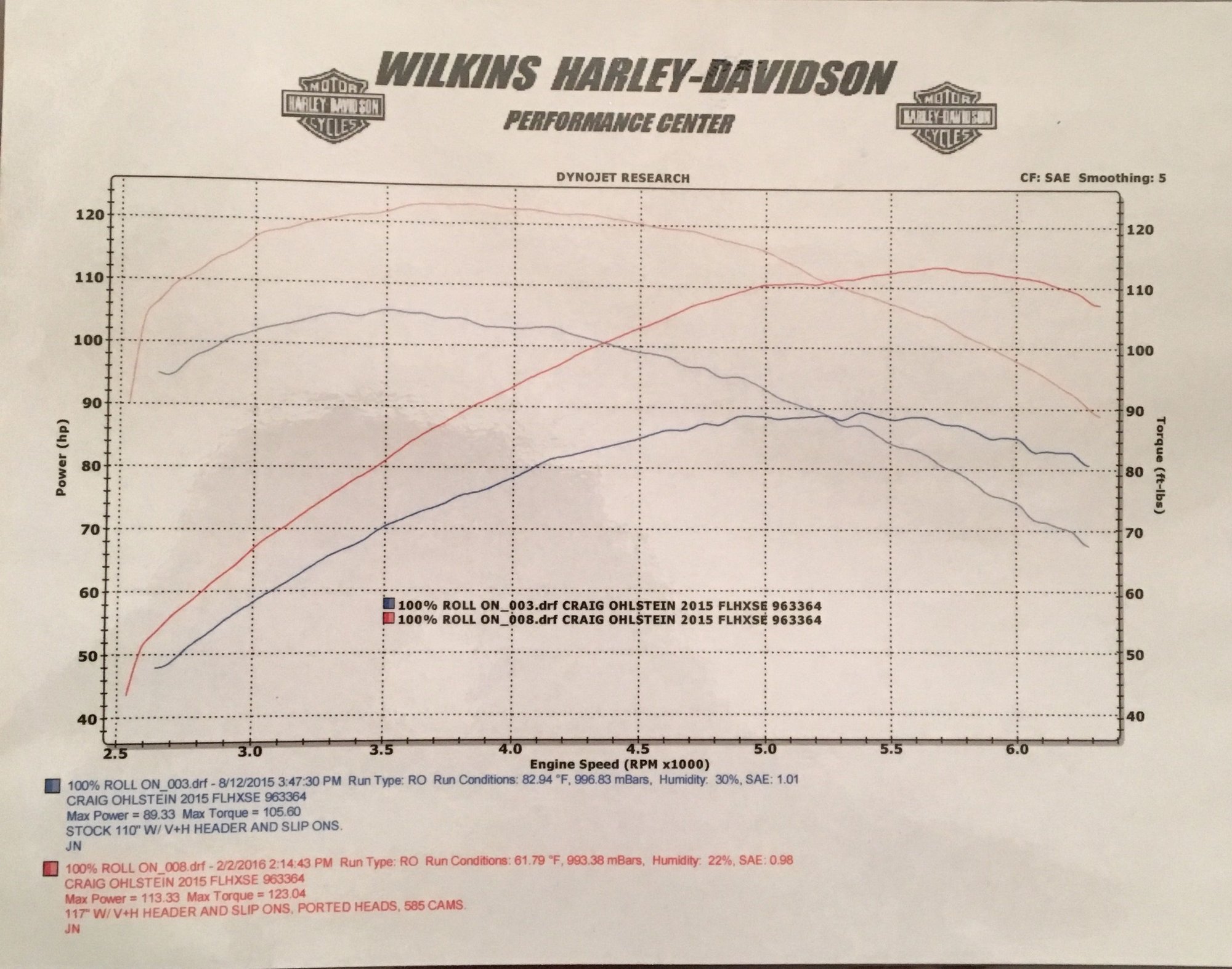

Originally Posted by 09 YELLOWBIRD
Frank,
Here's the Dyno sheet for the boy with the CVO Breakout.
I don't have the sheet for the stock 110" with the RIVAS Cams. IIRC, it came on strong around 2200 rpm.
I started the 117" Drop-in thread on the CVO board. If and when, I get more info I will post on your tread. If you like.
YB
Sweet !
Thanks for the update YB ! Nice graph.. looks like the cams are just 'right there' wow..
I started the 117 thread here because the new Dyna S is supposed to come stock with the 110 and also because some of the guys here may or might be interested in simply flopping their 96s' and 103s' over as well if they can possibly justify the price point and prep work .. and or if the kits produce decent numbers .. but bottom end stability is still my biggest remaining question in all of this.. even if the comp. ratios are still kept on the lower side..
Bet it'd be a safe bet that if someone were to say start chasing a ratio beginning in the number 10 with this kit that they'd damn well better update the bottom half..
