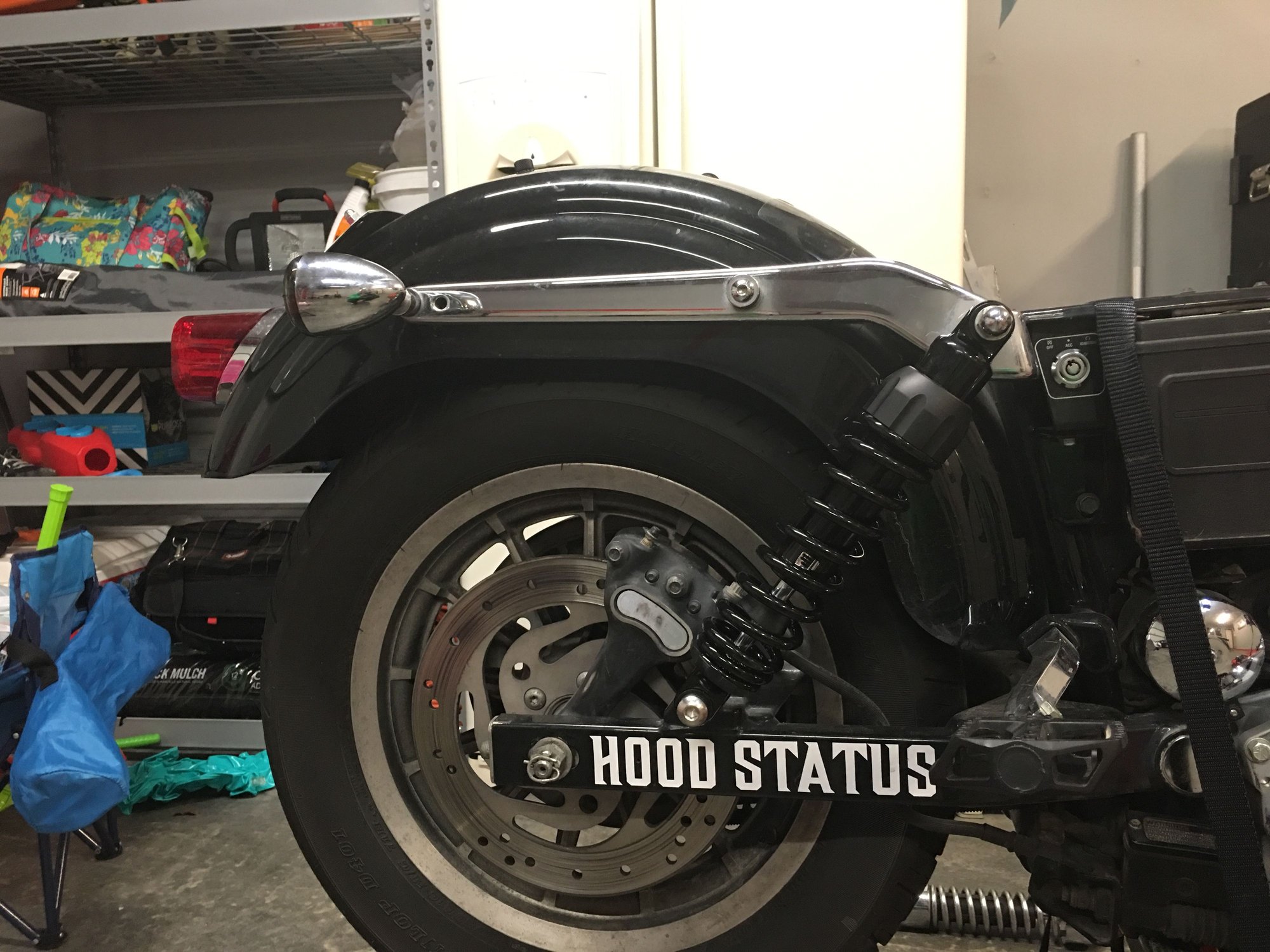

Working on completing my bike before it gets nice enough to ride consistently hear in a month or so. Have been working on upgrading multiple aspects and suspension being one of them. Not looking to spend a ton of money to upgrade my suspension but just looking for a overall tighter and more comfortable ride. I just got done installing 13" Progressive 444 and have been pretty happy so far with them. Would have loved some really nice Ohlins but can't justify spending $1200 on some good Ohlins. I got 444's brand new for $410 so about $250 cheaper than works. I am wanting to do a budget upgrades to the front end. Here is my thoughts:
