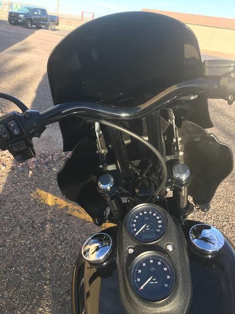

I run 12" West Coast Slingshots, they are a little more narrow than the MX Bars. Feel free to spend lots of money on magnum shielding, most guys just use a FatBob ABS line. I used the following:
Drag Specialties Black Vinyl Clutch Cable, 70 11/16"
Drag Specialties Front Ext Length ABS Black Vinyl Brake Line Kit +6" P/N 1741-3828
The brake line fit perfect and the clutch seemed a little long, about 1" or so. However, your bars will be a little wider, so maybe it will work out better for you. Here is a pic so you can see the clutch is wonky looking.
You have plenty of wiring in the neck, just pull it out.

Originally Posted by barricade
Thanks for the info. For the clutch line you went 10"+?
So, I was an idiot when I ordered the clutch and went +6, but that is +6 for the Fat Bob, which is not the same as a +6 for the LRS, apparently. So learn from my mistakes. I will likely change it out this winter because I hate the way it looks.
