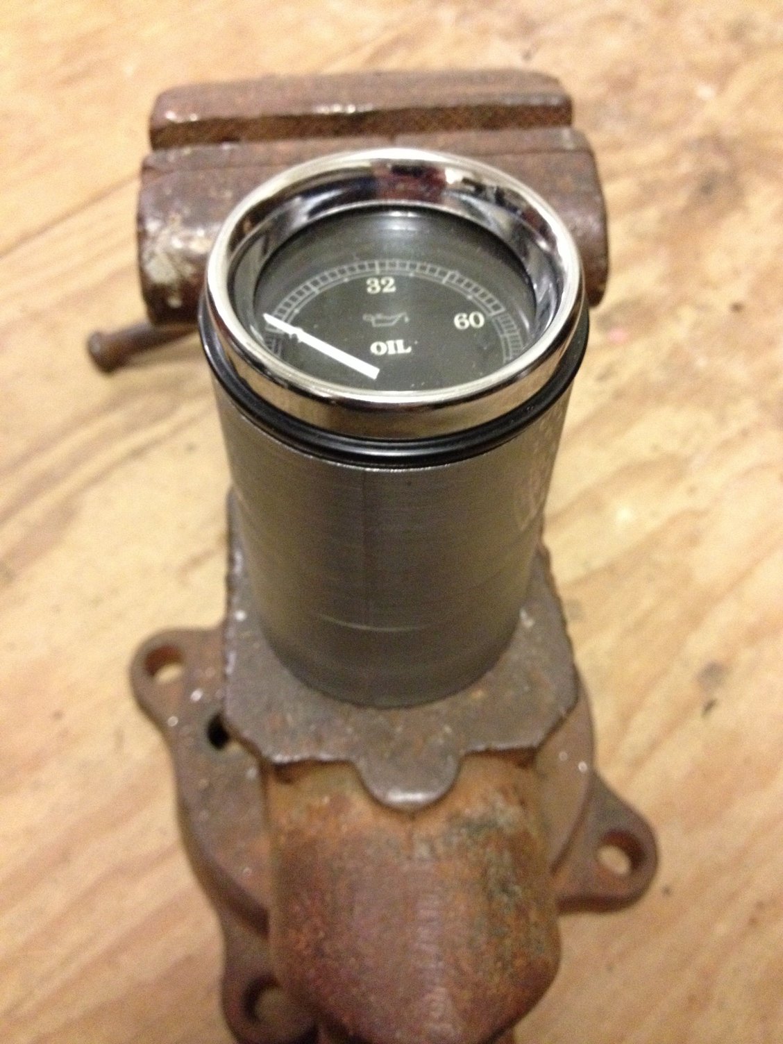

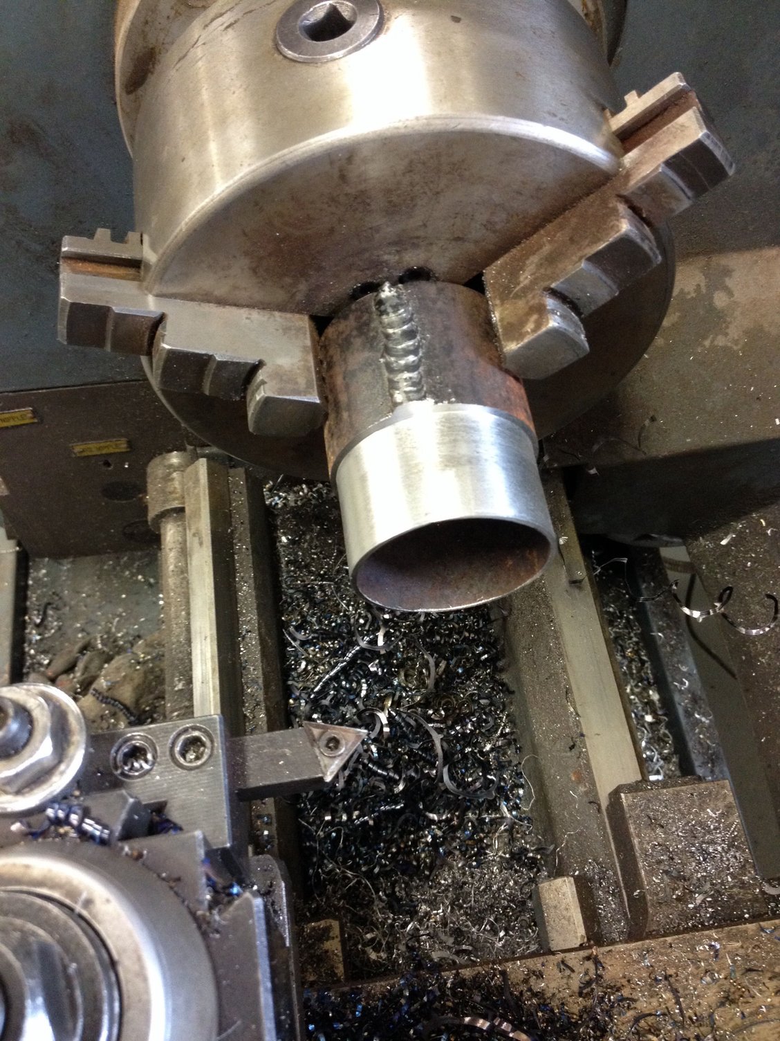

I machined down the tube I welded up. I machined off too much and ruined it.
Then I looked in the steel recycling bin and found a piece of tube or pipe that will work better then the one I had. I turned it down in the lathe and got a good result.

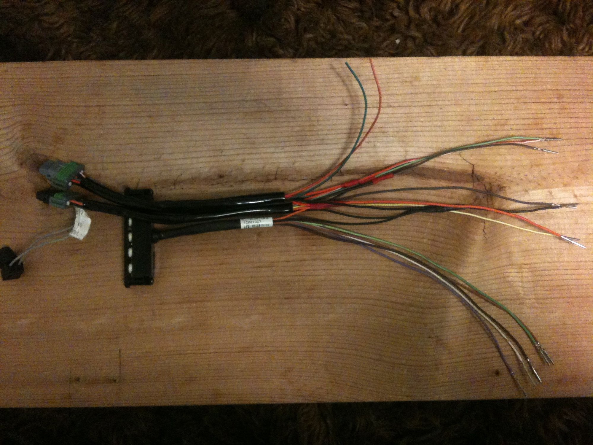

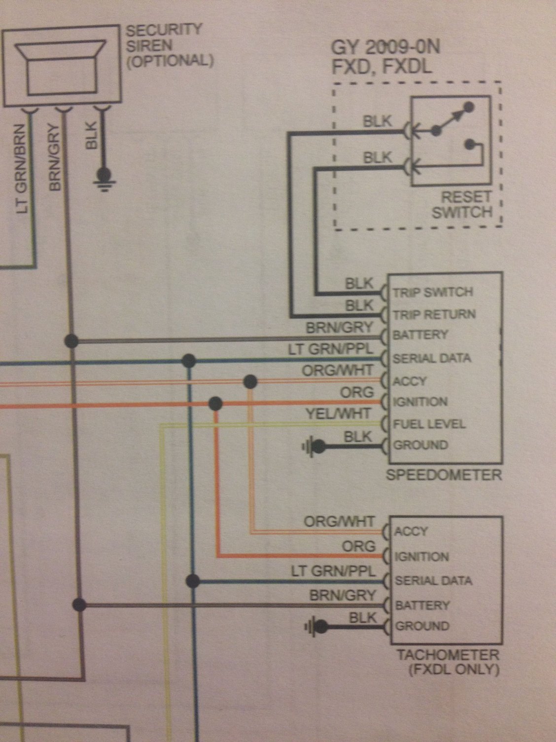

I spliced the wires that go to the tach, with the wires that go to the speedometer, like the wiring diagram showed.
It worked.
