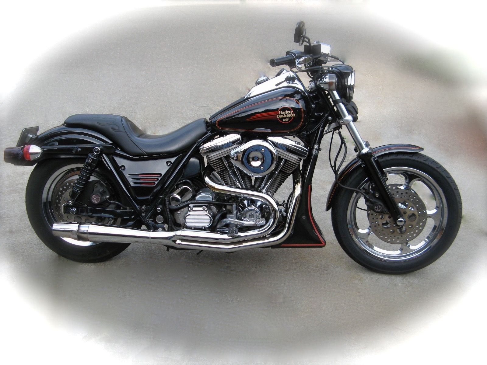

Originally Posted by O-Town D
My first Harley was a '90 FXR 80" EVO running a T-header with S&S Teardrop A/C. I used a #48 slow jet and a #180 main jet, and I also raised the needle a notch or two to fatten up the mixture as the CV carb opened up. Motor ran smooth, plugs ran clean. Your 88" motor may need slightly bigger jets, but the jet #s mentioned would be a good starting point.
One other thing you might want to check are the intake manifold-to-head gaskets - if they are leaking your motor will run lean and could be the cause of the "coughing" you're experiencing. Hope you get it worked out.
That is one SWEET FXR
